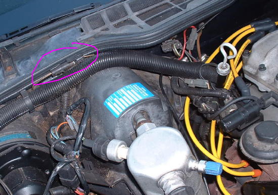

what color is the wire for the est connector?

The EST connector has a tan/black wire.

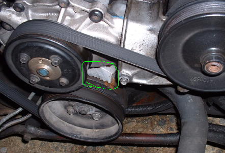

does anyone have a pic of where the timing tab is? i have to check my timing cause i have sluggish acceleration thanks guys
Old Jul 6, 2005 | 04:31 AM
bru333's Avatar
Joined: Oct 2004
Posts: 575
From: Smithfield, NC
Car: 1987 Camaro SC
Engine: 2.8L MPFI (rebuilt)
Transmission: 700R4 swapped to T5
Axle/Gears: 3.42 open
here ya' go.
