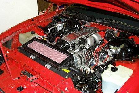

I have a 88 350 gta with a functional ram air hood. The kit i have says I have to extended my mass air flow sensor wiring. What's the easiest way to do this and is it even worth it?Will I see any gain performance wise?

You want the underhood ducting of any ram air cold air system to pick up the least amount of surrounding under hood heat.. Stay away from exhaust, Radiator ,etc etc..
