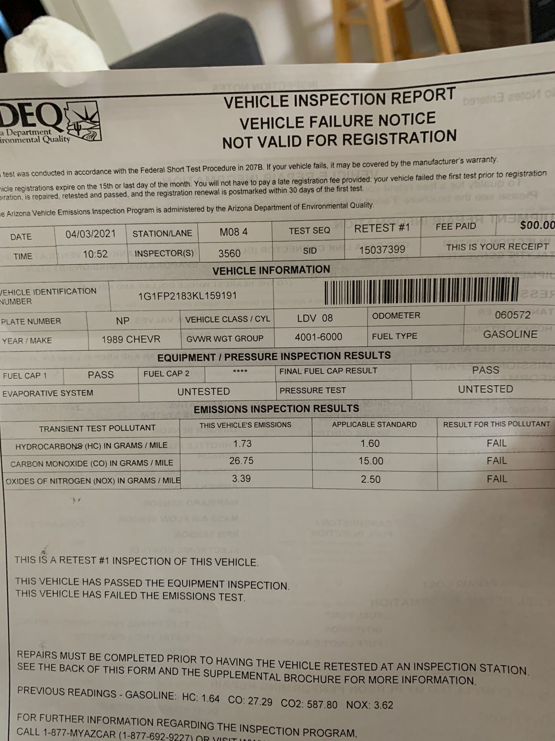

I’m working on an 89 IROC 5.7 TPI and it keeps failing AZ emissions tests. After failing the first time, I replaced the gas cap, new fuel, spark plugs, wires, O2 sensor, distributor cap, rotor, fresh oil change and it failed again. The previous owner had a Hypertech chip in there, which I have just swapped back to the OEM one, and I haven’t tested it since reinstalling the original eeprom.
Does the Hypertech mess with emissions output on these cars?

If it still a 128922 yes mad fueling is changed but should’ve still pass emissions.

Those chips generally alter open loop fueling - WOT, PE, etc. The closed loop is still going to target the same stoich AFR and dither for the cats using the NB O2 sensor. Should still pass with a chip.

I think the problem is more that due to the chip and thermostat running it cooler the engine can’t burn off the carbons inside and just sends it all right out of the exhaust, hence most likely why it’s failing.

Probably not.

Agreed!
I have passed emissions with very low readings with a 170°F thermostat in a TPI.
I would be looking at the injectors for leakers or a leaking fuel pressure regulator diaghram.
