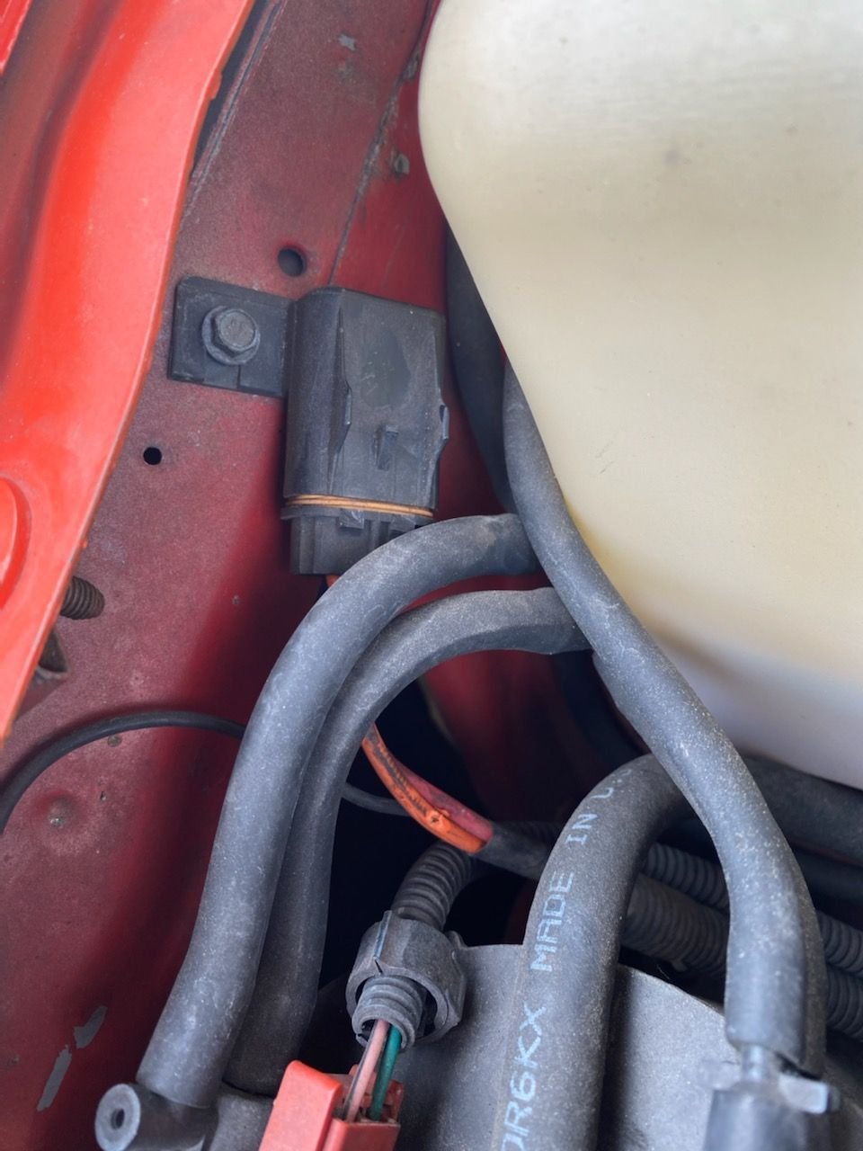

do you have a picture of where this fuse is located?
I can get a picture later on. It's a regular 20amp spade fuse just like what's in the fuse box under the driver's side of the dash. It's in a little plug in with 2 wires on it, right in the wiring by the battery.

Hi dagwood, I hope your short circuit isn't buried too deep, sometimes they can be a real pain to find. I figured I'd post a couple of pics here for bigdavesiroc and any future readers who may find this in a search.
Pictures of the underhood fuse, note that there is supposed to be a plastic retaining tab that is broken ;
Thanks......I think we took that out of the system when we switched to a carb. But I'll look and see if I can't find it. I really appreciate it.
