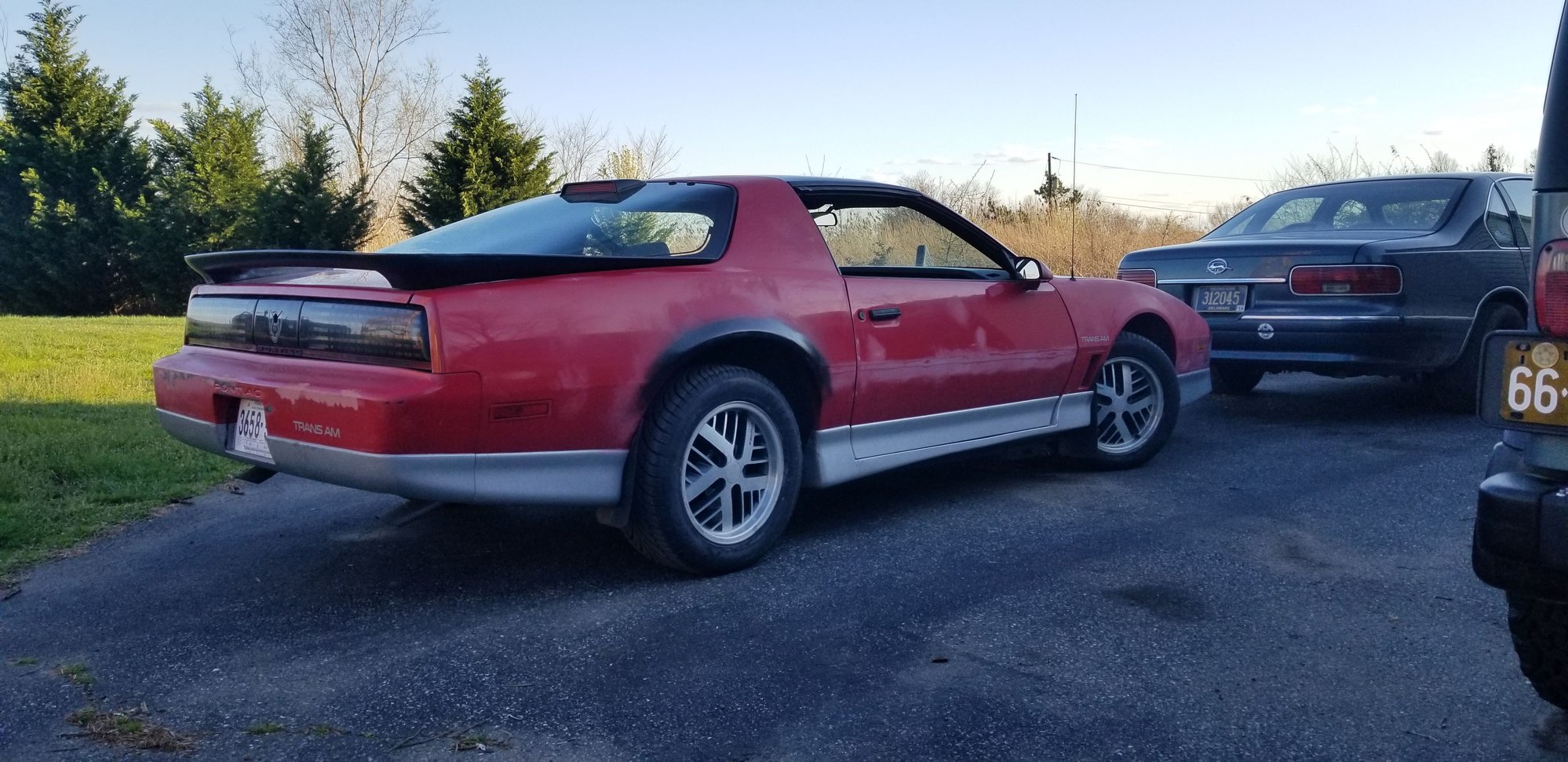

Hey guys so I just picked up an 86 Trans Am for my son for a project car for us. Been on here searching and searching and covered the basics of why this thing is so slow. I know LG4's are dogs but this one is just ridiculous, I walked him in my 4cyl Subaru Outback lol. So far we change plugs, wires, cap, and rotor. Checked the EFE and although it is not hooked up it is not stuck closed. Fixed the choke on it and thought maybe that was causing the secondary lockout to stay closed but nope verified today secondaries are opening. Anything else I can check? The car runs good just has no oomph. It's killing him since his daily is our LT1 Caprice which will oit and out rape the Trans Am hahaha. I was trying to find a stamp on the rear as my RPO codes are gone to see what gears it has in it. Any other pointers or things to check out would be appreciated. Here are some pics of the ole girl needs work but runs and drives and the body is straight and interior pretty clean with a good center console and dash. All in all a great starting point He was hoping to recreate this picture of me in my Trans Am but nooooo prayer without a lot of bleach lol
