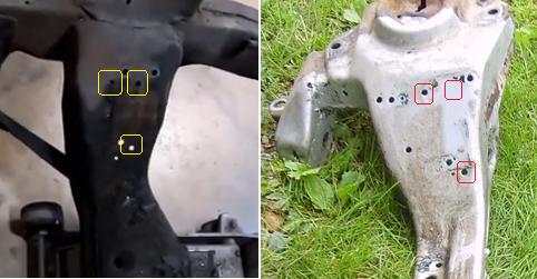

I had read that the early third gen subframes were drilled for the Pontiac 301. Perhaps not... at around 9:33 in this video
you can see the 2 sets of mounting holes fairly close together. I believe that the Pontiac mounts are the slightly lower (an inch or so) and slightly rearward (looks like the front bolt hole is about halfway towards the rear between the original bolt holes) set with the lower hole used in the front of the mount rather than the rear as the third bolt. This image of a third gen subframe
doesn't seem like it has those holes, so I might have needed the plate anyhow.
Comparing the 2, I see what might be the lower and rearmost holes for the Pontiac mount but definitely not the forward hole.
Anyone have an 82 subframe that can check for these holes just to satisfy my curiosity?
