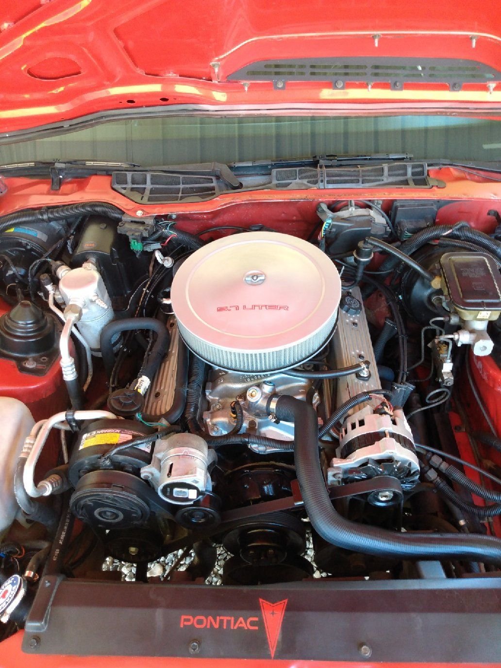

I built a pretty mild 350 to replace the TBI 305. Its pretty much a rebuilt .030 over L98 with better pistons, mildy ported heads,and upgraded bored TBI and intake. World of difference, still 23 mpg also. Car pulls hard to 5300 or so RPMs and plenty enough power to spin tires. L31s are a great platform to build from also and keep your casr TBI and looking stockish if you want to
When you say "pretty mild" is that a cost mild, or a performance mild?
Btw, looks great. Love how clean it is under that hood!
