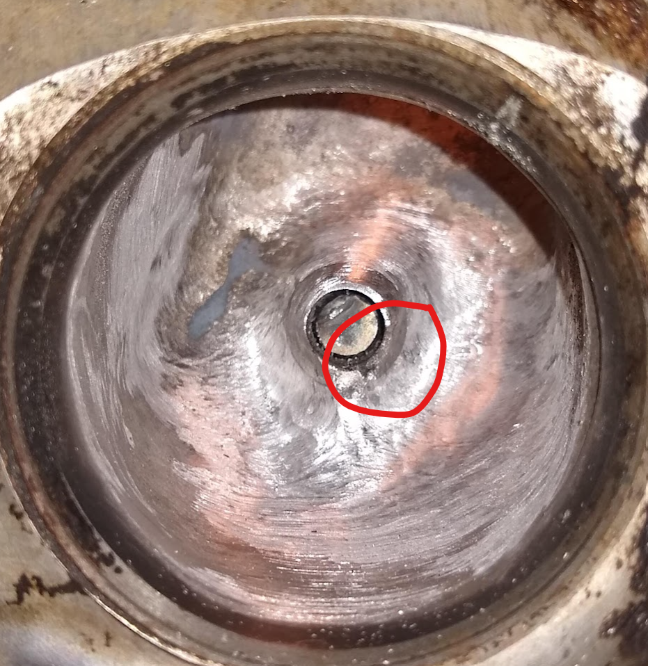

This intake port had a hole in it (some aluminum LT1 castings which turned out this one had some core shift and problems with thin areas which keep popping up and leaking), I welded the hole shut but in the process blew away about 1/8" square corner of the valve guide. I'm debating just cleaning it up as best as I can and running it like it is instead of having the guide punched out and a new one installed.
Reshaped welded port, circled is the missing bit of valve guide. This is before final finishing with tootsie rolls...

And for those of you wondering why even consider it, the local automotive machine shops have all closed so getting a shop to do it means a 2-hour drive and 2+ week turnaround time.

Not worried about this weld repair, I used to do weld repairs for a local machine shop back in the day, and this LT1 head swap required a lot of welding and moving things around. The problem is that this head is basically junk with too much core shift and I've had to weld holes/thin spots in 3 other ports now, I've got that part down, and if I had any sense I would have just ported and converted another (set of?) head(s).

I don't really care if someone thinks that leaving a chunk missing out of the valve guide is good or not, I just care about if I'll get away with it if I do, at this point from the crazy humidity in this area I'll probably be bolting it back on a block with surface rust on the bores, and I know the other bank has a spot in #5 that looks like there's a crack in the cylinder wall. I know it's a turd, but will it run OK?

I assume that is a .500" OD cast iron guide in there already?
If so, then run it. No problem.
