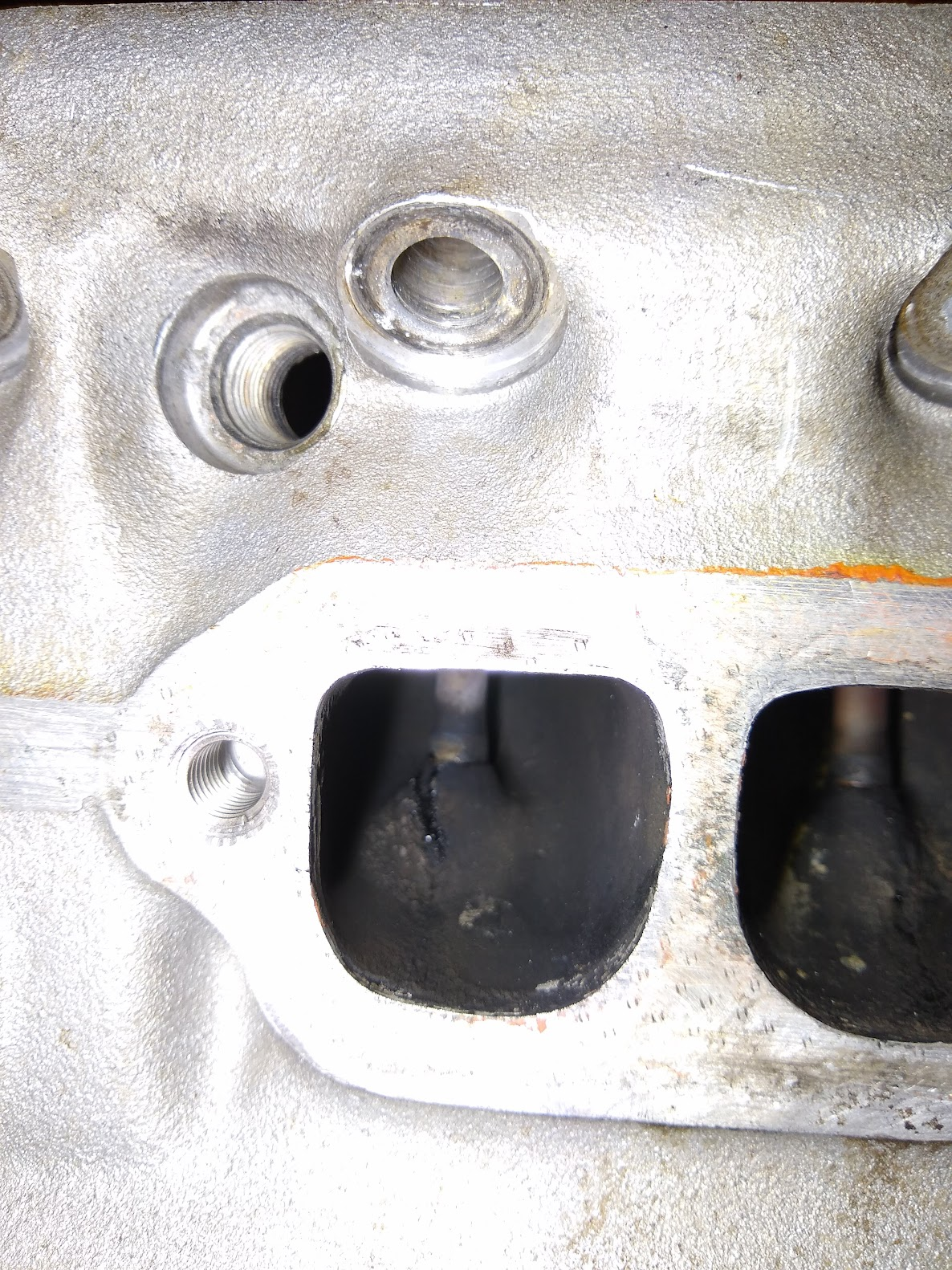

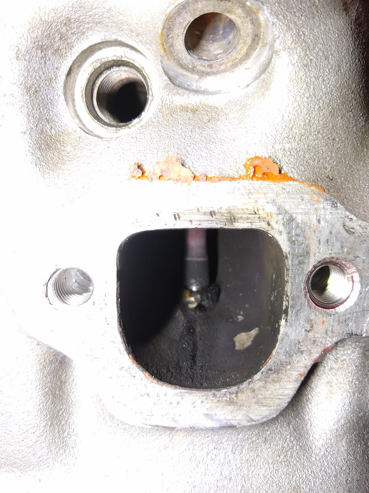

I was messing with my headers and noticed one tube being cleaner than the rest so I got to looking in my exhaust ports and noticed this, it's a wet spot that looks like a crack going from the valve guide all the way to the face of the gasket face of the head. It's not a crack, it's in all the ports, looking at the head that was off the car I was wondering if it ran down the port roof when I had it upside down on the bench, but the head on the car has the same exact thing on the port roof across the top of the port, it does not run down the sides of the port.
I had a really tough time getting a picture of it, the first few are of the worst one, and the others are of 2 of the better ones, most are pretty close to the worst one. #4 was the only one that didn't have it and that was the one with the hole leaking coolant on the intake that I welded shut, that one probably had it before it was steam cleaned by the coolant.
The worst one, 5 ports are VERY similar to this
Same port, lighter exposure
One of the ports with less of it, but you can see it looking like a crack in the carbon deposits
The other one that isn't as bad, in this case clearly wet but not as long as the rest.

That is strange looking.
Looks almost gold colored under the carbon, like it was brazed and the carbon isn't sticking to it. I don't suppose that's what it is, but just what it looks like at first glance.

Was the head prepped with bronze guides?

I believe so, why?

Could the exhaust have gotten hot enough to melt bronze? And run uphill? This is a mystery.
Are those bronze thin-wall guide liners?

I took a better look, then took a magnet to them- I know that they've been replaced but they're cast iron (magnet sticks).
I also know that I've seen this before on a different engine but I don't remember where...

If an incorrect alloy was used, they could melt (think brazing rod). Also, molten material might not "run uphill" to coat the guide boss, but it certainly could be "blown" uphill by exhaust gasses pouring out of the cylinder at over 200 MPH, just like spray-welding.

That syndrome of failure under heat and pressure seems to be fairly common inside the beltway, sometimes identified as "running crack head" which coincidentally seems to follow four-year cycles.

Unfortunately, those heads are likely to need a lot of work. I can only imagine what the seat areas might look like. Your other thread indicates that the threads in several areas are also suffering damage. It may be best to strip down the worst/most suspect head and perform a complete assessment. It may be that the rework at a knowledgeable and reputable shop exceeds the cost of replacement heads. It would be pretty easy to drop mulit-hundreds of Bitchcoins in machining, guides, seats, new springs, retainers, valves, hardened spring seats, studs, and thread inserts just to get back to serviceable heads.

The head on the other side (passenger side) is the one that had the hole in the port. I pretty much have it stripped down now, I know the condition of things.
So here is the thing- These heads don't even have an oil change on them since they were COMPLETELY re-done (I know, from some of the pics it would be hard to tell but I'm pretty sure it's between 1000-1500miles, can't check, no battery in the car and it's a digital dash). New stainless valves, guides, 3 angle valve job, machined for PC seals, PAC beehive springs, retainers, ARP hardware... The only reason that I have them off/apart is that one of the intake ports on the passenger side had a thin spot that started filling the intake with coolant. I've had both heads pressure tested, after porting, converting to SBC, the refresh... it turned out that one has core shift and is prone to thin spots around the intake valve bowls. So far it's been easier to fix the thin spots than start over so far, but I'm about getting to the point where I would have been time ahead just converting/porting a new set, but I didn't know I had the problem when this started.
That said, the valve seats, valves, guides, springs.... are all dead-on almost brand new, and even with whatever this is that I'm seeing in the exhaust ports there is no slop in the valve guides and it wasn't burning any oil when it was running.
If I had infinite time and money (eh, money really isn't a thing, I guess i could spend a lot more than the just about nothing that I've spent on this thing so far) and the car was sitting comfortably in a garage I'd pull the short block and go through that, it's condition concerns me more, but with the car sitting at the end of the driveway (in a neighborhood with an HOA) and cooler weather coming this is becoming more and more a race to get it slapped back together and mobile.

If you're going to repair the heads, consider sintered iron guides and ditch what's left of the bronze. Hopefully there is sufficient guide boss material to retain whatever you install. If they are actually cracked, it might not hold ANY replacement guide.

to me that just looks like a little oil seepage pushed along by exhaust flow-not a problem.

OK, trying to do a little homework on the bronze guide theory. I KNOW NOTHING, that's why I'm trying to look info up.
Properties of Bronze = melting point 1000*C / 1832*F
https://material-properties.org/bron...melting-point/
Exhaust gas temps at valve = 1200-1450*F
https://www.enginebuildermag.com/200...r-hot-engines/

As for the melting point of bronze, there are numerous alloys identified as "bronze" with melting points as low as 850°C. As mentioned, if an incorrect alloy was used (as in if they were sourced from China), all bets are off. All that is assuming they guides are indeed bronze. It may be something completely different that we are looking at in the photos.
