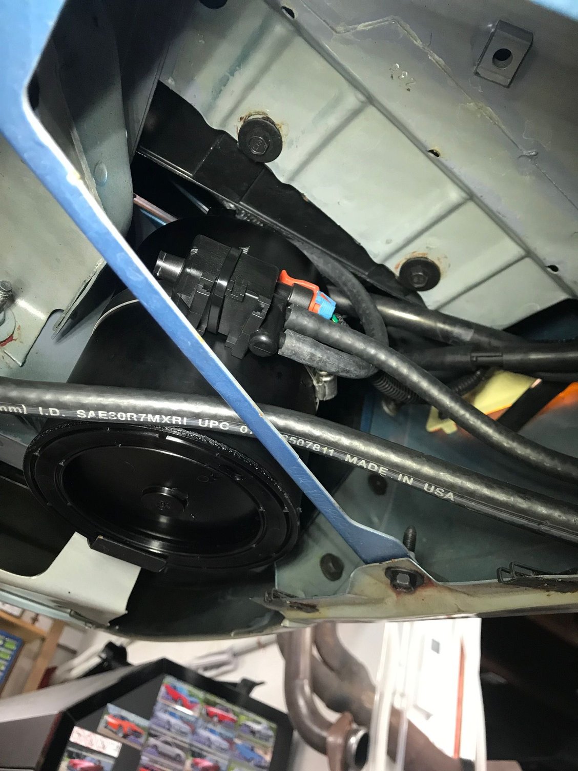

Well Guys, I think this is going to work. Charcoal canisters almost exact same size. Connectors are identical. A pic of the final install before buttoning things up. Gonna run with it for a while and see how it does. Started the car and let it run to temp, but that wont activate the solenoid, need to let it go down the street - didn't have time. Pardon my zip-tied solenoid. Haven't hunted down the proper mount.

I have installed the canister and valve with out any issues. The brackets from the old canister fit the new one perfectly and I was able to bolt it back down in the original location. The purge valve is just tied up for the moment, but I have ordered a 4th gen evap bracket and will find a way to fit that in there to hold it long term.

Hey Steve - I noticed you don't' have your air opened on the canister. You may want to look into that for a 1991. My 1990 has it open, it has a hose coming out of it, which connects to a T fitting. from there, 2 more hoses connected. One goes down thru the hole on the bumper splash panel, (this is longer) the other just goes to air (this is shorter)

Interesting. The Air port is not completely closed. It has a small cover clipped on, but is open on the bottom of it. My original looked like that to, I have never seen a hose attached to it. Maybe the difference between a Camaro and Firebird. Do you have pics of that?

No pics, sorry about that. Its definitely factory, no idea why it changed at some point, obliviously since the new part is set up for both configs.

I've seen the canister air port both ways. With the hoses and the T, and with the small clip on cover. The cover of course having a slot in the bottom to allow the canister to vent or intake air.
I have no idea why GM changed this up between various cars...

Hey Steve did u have to T some hoses to get it to work by the way how is it working so far
Old Aug 21, 2025 | 01:23 PM
LiquidBlue's Avatar
Joined: Jun 2015
Posts: 2,187
Likes: 243
From: Austin, TX
Car: 90 Formula / T-tops
Transmission: MD8
Re: Evap Charcoal Canister / Purge solenoid substitute
Originally Posted by Oscar88gta
Well not sure if solenoid does work but my car is still original but wanted to replace canister and other evap components I saw. A post on a guy who rebuild his canister but thought wasn’t bad idea to buy a new one. Did you have to T any lines
No T's were required. was plug and play, other than having to mount the solenoid separately. Mine came with a T from the factory. see post 16
