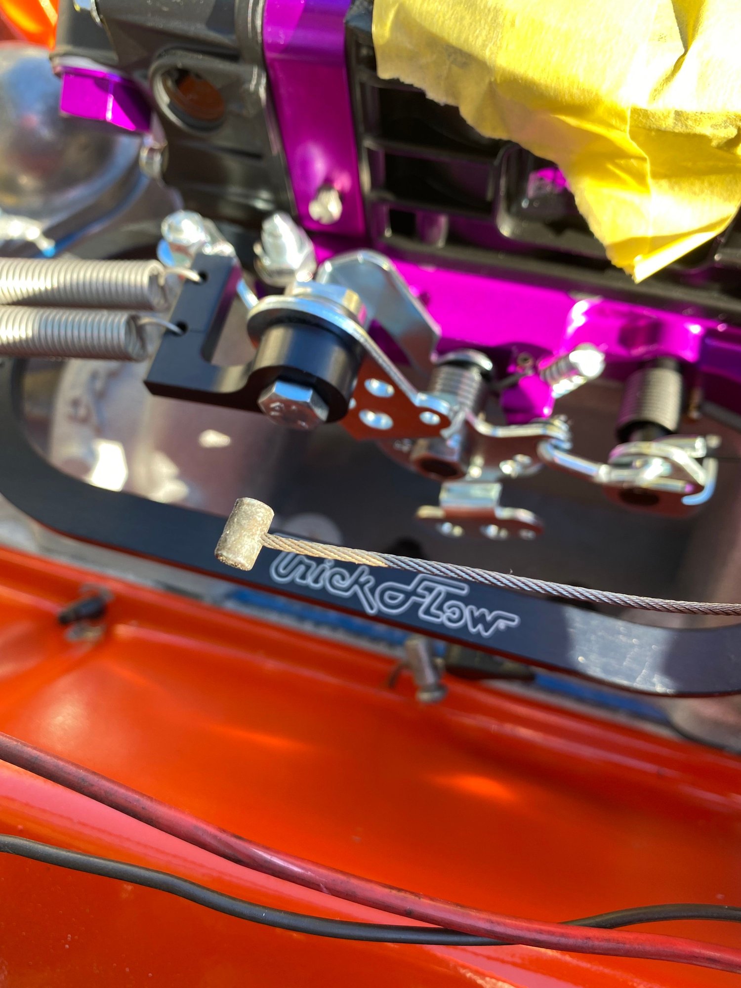

I am in the process of hooking up my throttle and tv cables on my brawler 750 carb. I have the sonnax geometry corrector and the trick flow bracket for the cables. The throttle cable is the original TPI cable and it doesn't have the correct end on it for it to snap on to the linkage. Is there a way so that I can just change the end of the cable instead of having to buy a TBI or original carb cable? In the picture below you can see the end of the throttle cable that I am talking about.

Yup cut off the end you have and attach the end you want

That 89-92 cable is nla, I’d sell I think you can get the carb cable at RockAuto just look up ccc application

I've been looking everywhere for an eyelet to put on the end of the cable but I can't find one. Do you happen to know of a part number for one?
