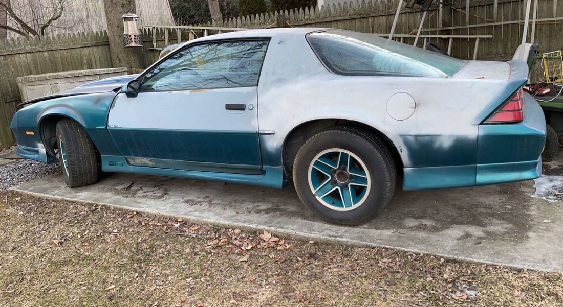

I've been on this forum many times it seems to be a really great resource so I made an account today. So this is my 1991 Camaro RS bone stock with not much fun stuff yet. It's got over 200k miles on it original engine and trans. It was a daily driver for a long time and sat in my driveway since 2005. She needs a lot of work but that doesnt bother me in the slightest. Its now my car and I have big plans but I want to get it running as is for now. The car did run and drive for the past 10 years but just within the last year doesnt want to start and when it does it stalls out. It seems to have no or very little fuel pressure. When I cycle the key I cannot hear the pump prime. My assumption is either the pump is dead or the relay is bad. I checked the fuse in the fender and it wasnt blown. Anyone know the easiest way to check the relay or anything else i could possibly check before I drop the tank? Another question I have though. If the fuel pump is dead, wouldn't it never start? As it sits, it will start after siting for a while. Thanks for any help.
