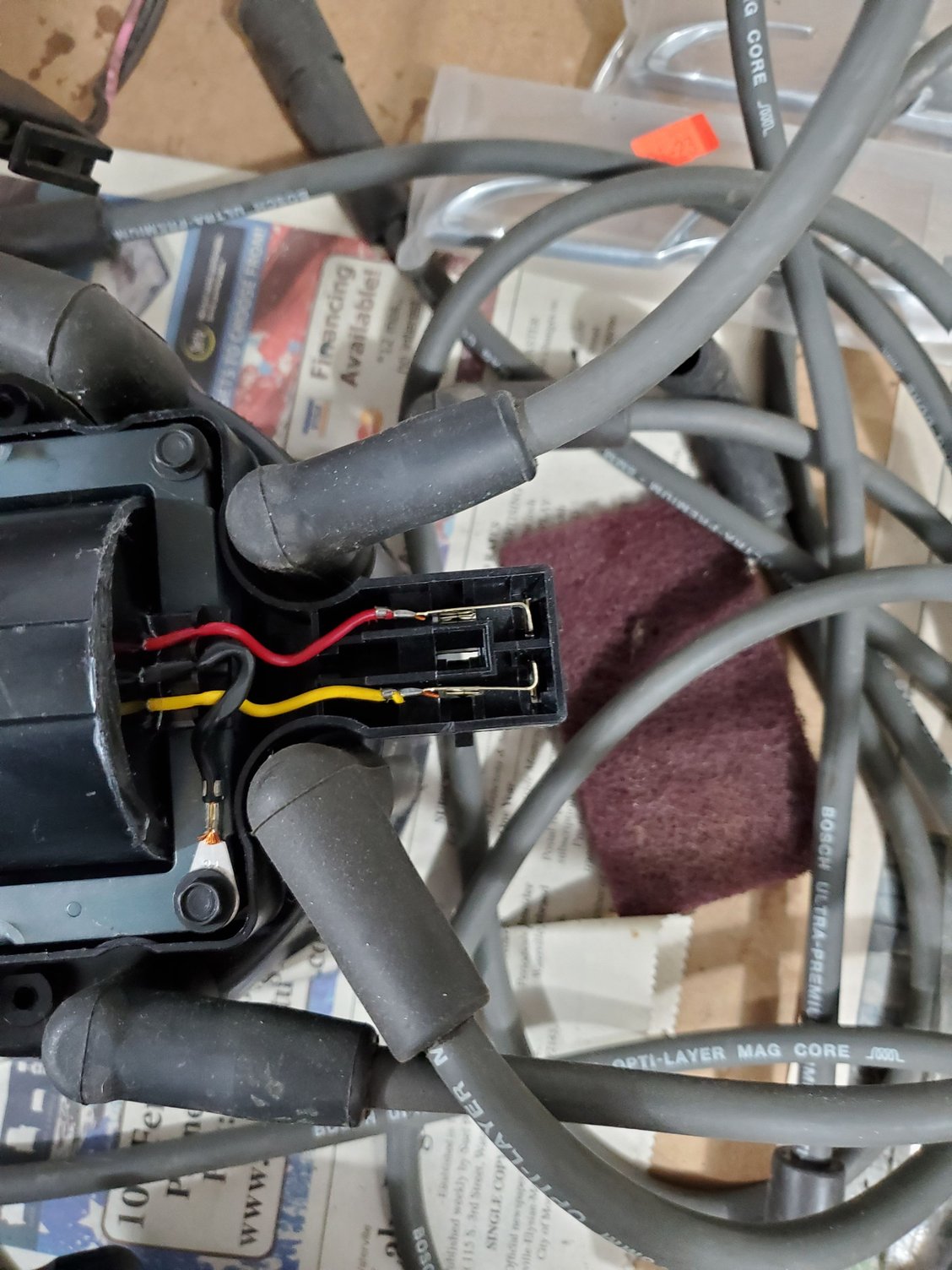

I have purchased a new distributor cap, cover, and coil pack. Finally getting around to hooking up the new harness and I realized the new coil doesn't come with the center ground jumper wire. Is there a source to purchase one, as after three different auto parts stores, I have struck out. Please see attached photos.
Thanks in advance.
Mike

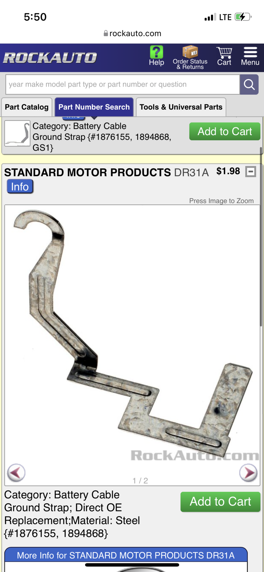

Re: 1985 TPI Coil wiring
gm 1894868
Thank you!
Ordered, received, and installed. Thanks again!
