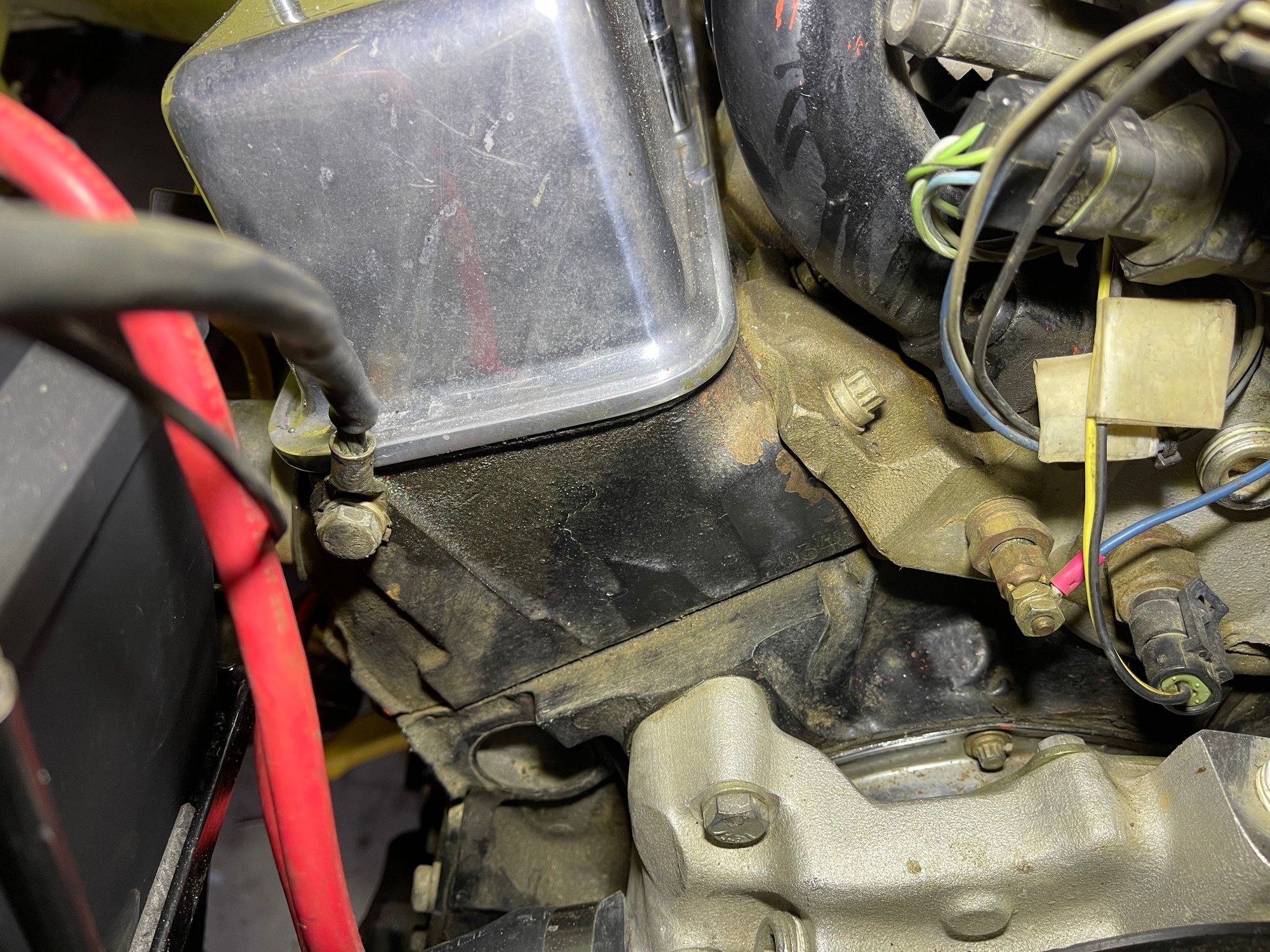

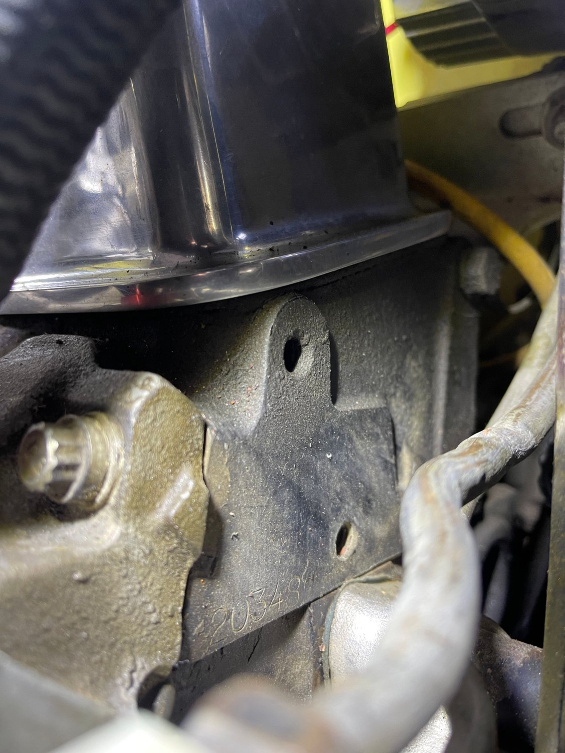

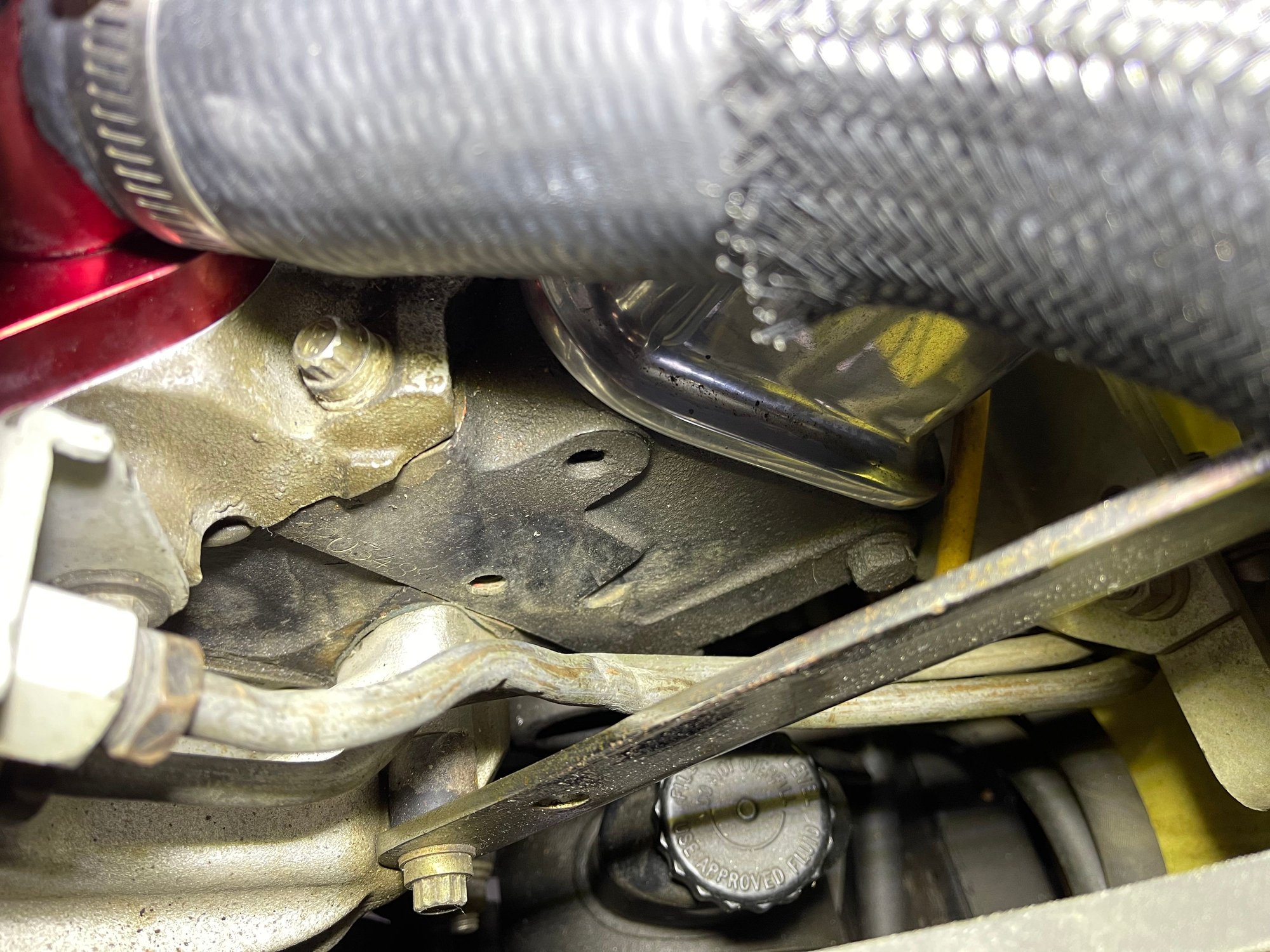

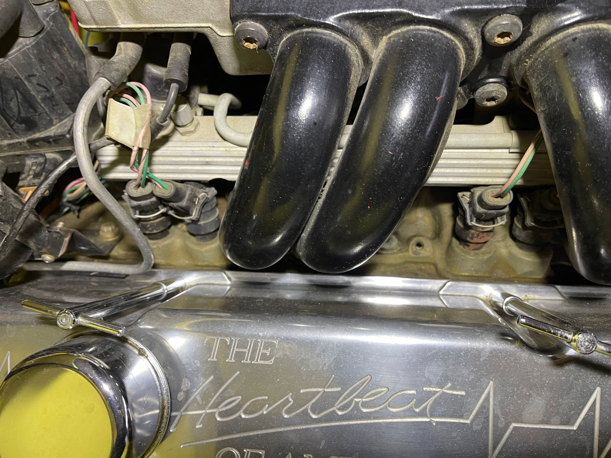

Can anyone identify these heads without the casting numbers? I can’t get home to see the casting numbers for a couple days and I’m trying to order parts so I had my kid send me pics!
The motor is a SBC 400 with TPI fuel injection. Here are the pics.
They each have “20348” stamped on the front of them.
Any info or even a possible date range would be awesome. Thank you!

Nevermind I found a pic of the casting numbers they are 333882’s

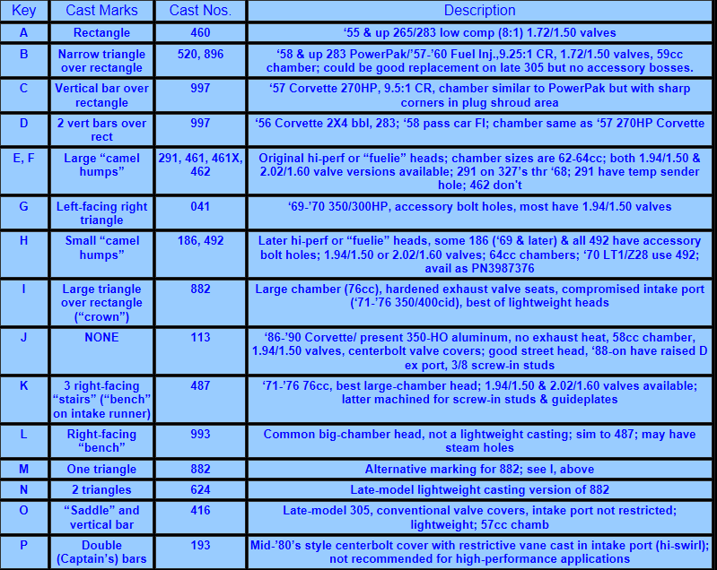

882. Best of the worst castings. You can do much better.
Any SBC head will fit onto a 400 block if you drill the steam holes in the head.

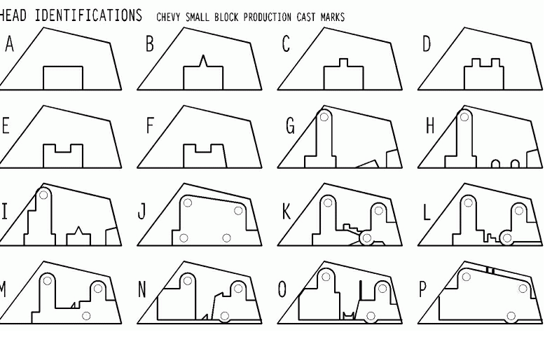

Here ya go Guys:
The Article in the HyperLink (below) provides some good information on the different Cylinder-Head Castings, if anyone is interested:
HyperLink
