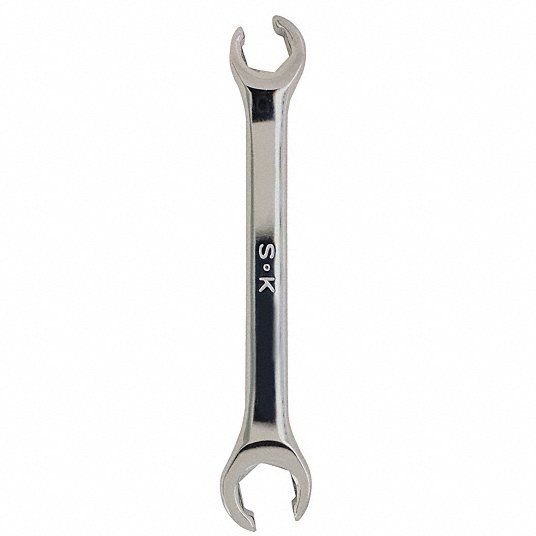

To change it, unscrew the fuel line from the nut first. This will require a 5/8" line/tubing/crow's foot wrench. NOT an open-end, NOT a Crescent wrench, NOT pliers, NOT NOT NOT NOT NOT NOT. A line/tubing/crow's foot wrench. Looks something like this: note the extra features that grip extra flats of the nut, to keep from rounding it. Might help to soak it in penetrating oil such as PB Blaster or Kroil for a day or 2 first. Not WD-40; actual penetrating oil.
