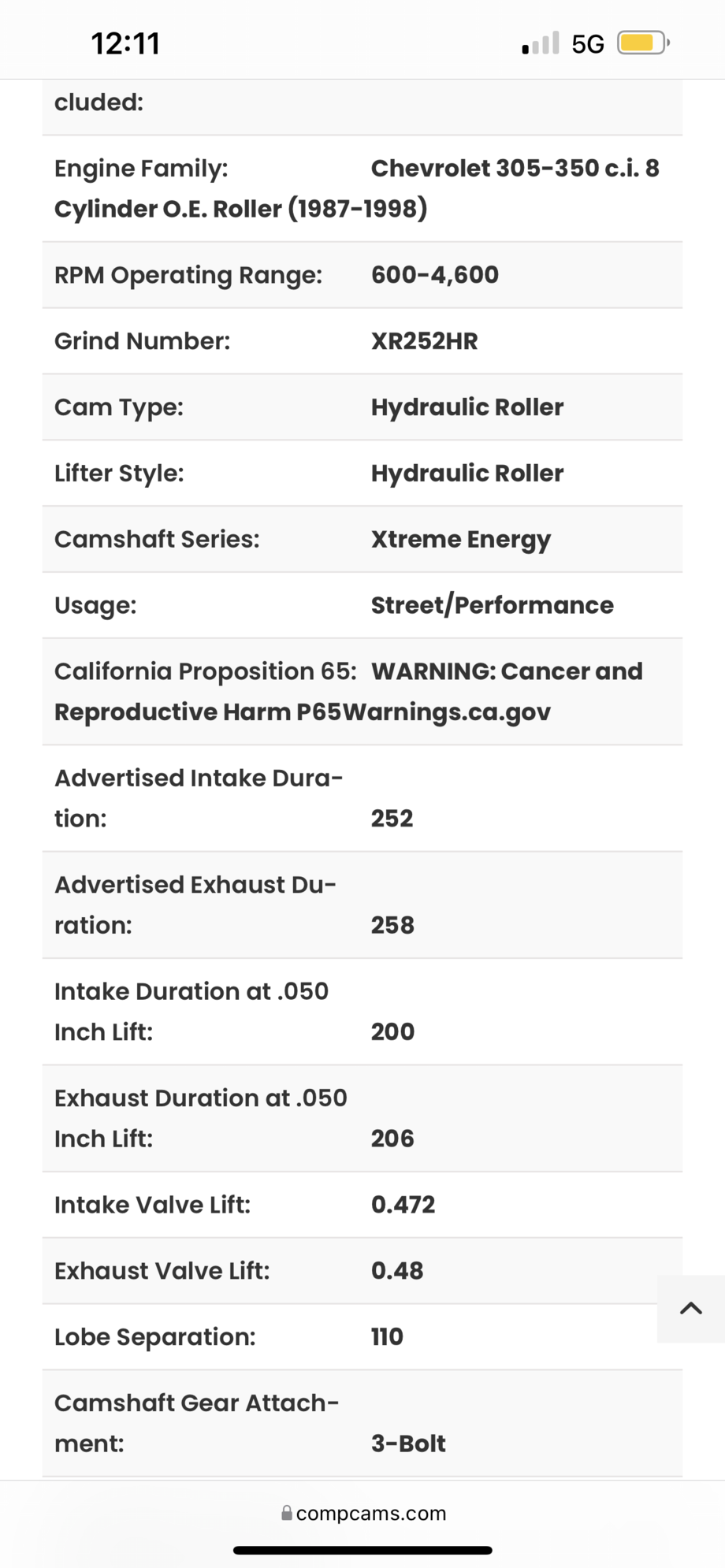

Something like this? I know it’s annoying people constantly asking about cam selection but I’ve only done one cam swap and I went way over board and the car was basically undriveable

Used L98 cam would be perfect for the 305. #049 GM cam has 207-213 duration, 117LSA and .415 lift? They were used in 90-92 speed density 305 TPI cars and made 230hp if they had the better exhaust.
