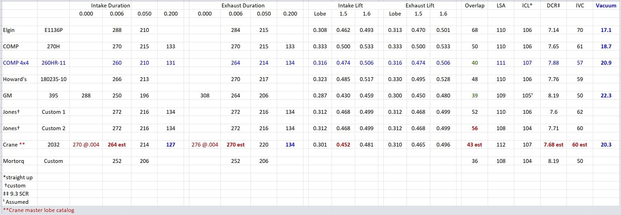

You'll have to dig up some flow specs for those heads. It may be, like the 062 Vortecs, that they stall and drop off approaching .500" lift. There's little to no benefit in going beyond that as it's said that heads don't recover well.
That said, the best plan is to open the valve quickly, to the desired maximum lift and keep it open as long as is practical. That's where the lazy lobe has it's failing. A quicker profile than say the OEM or the Magnum, such as an XR or equivalent, has more lift area under the curve. This means more flow for a given lift.
There may be something in Stan Weiss' database.
http://users.erols.com/srweiss/tablehdc.htm
EDIT: I had a quick look and there's one test showing 221@.500". It climbs to that point however there's no data beyond that. At the very least you would want to get the valve opened quickly to at least .500". If there's anything out there to support that the heads don't fall off dramatically after .500", then going past that is a benefit as the port will see .500" on the way up and on the way down.

Re: Cam shortage, this ok for stoplite to stoplite?

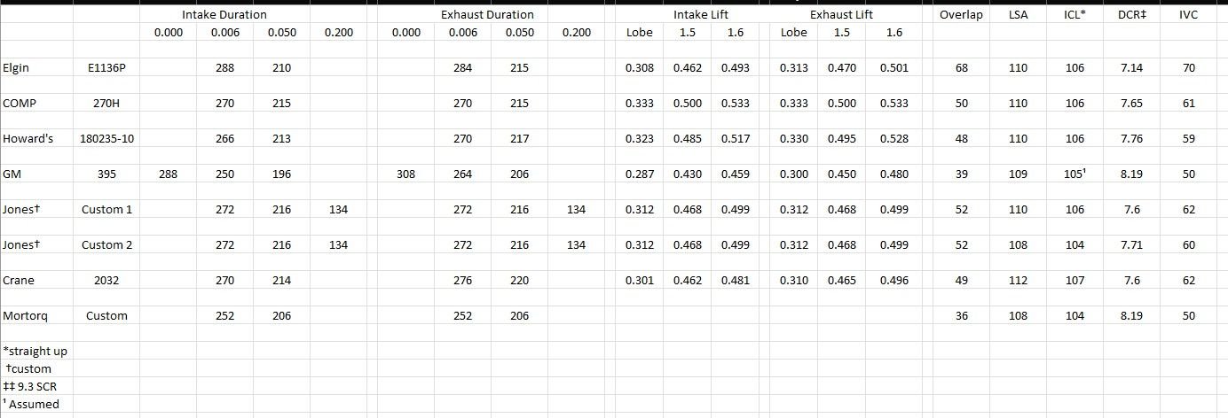

Originally Posted by skinny z
Getting the .006" duration specs puts a different perspective on that cam.
I'd like to build a spread sheet for all the cams in question to see what's where. That'll be a few days out though.
Fast. The video above, what's the CID?
FTR, E85 allows you add a ton of timing correct?
Stock L31 350 short block. On E85, 34° total at 2,400 rpm is what it made peak output with. 36° saw 1-2 added numbers in places but I backed down to 34. 32 saw 5-6 loss in places.
The gain going over 0.500 is just not there. There slight 2-3 cfm improvements at 0.600 over 0.500 but the added wear and tear on the valvetrain as well as the cylinder head modifications to run over 0.550 make it not worth the effort. These heads are not like a LS head where the added 0.050 lift to gp from 0.550 to 0.600 ands another ~10 hp.
Well, there you go then.
Keep it at .500" (or a touch more) but get it there in a hurry if you can.
To me that leaves out the 395. Further to that, going from a 1.5 factory rocker ratio to a 1.6 only nets something like .460".
There's another strike against it.
So far the front runner I think is a custom grind with a .310-.320" lobe.
A .320 with a 1.6 rocker ends up at .512". Looks pretty good. And a .320 isn't all that intense. An upgraded spring for sure but nothing extreme. Maybe a COMP 26915 or a PAC equivalent. (1218?)
If you build that, would you mind throwing in a line for the GM 94666492 / Crane 2032? While it was a bargain on clearance, it's only a good deal if it works well. I didn't want to otherwise pollute this thread with discussions about it.
Thing is with the 062 Vortecs (not sure of the 059's) is the port looses flow past .450" or so and doesn't recover as the lift decreases. The trend there was to get to that sweet spot as quick as is practical and keep it there as long as possible. All within the scope of what the engine needs of course.
This is why I've been talking up a quicker lobe (like the Jones .320"). If the 059 have a similar failing, and I believe Fast said that there's little to nothing being gained although nothing said about getting worse and not recovering, then it may going past does have that twice at best lift benefit. ​​​​​​​

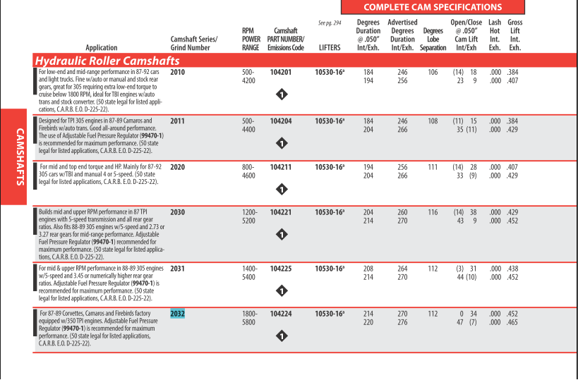

I'll keep that in mind. Possibly an Saturday morning project with a fresh cup of coffee.
Some say it’s supposed be a copy of the crane 2032 cam at 270/276, 214/220-112, .452/.465 w/1.5 rockers.
It very well may be, but I saw a post where someone measured it at 202/210-112.5, .450/.465. Which would be a little on the “too small” size for me to consider doing a cam change. Maybe not for the OP though?
Looks like it’s available at $115-$120 shipped. For that price, it might be worth the OP trying it out just to see if he likes it or not. Either that or just wait on a custom cam.
Although there is a Comp 4x4 in stock that should work very well. 260/264, 210/214-111, .474/.474 (.506/.506). I used a comparable 4x4 grind in a hydraulic flat tappet in a 5-speed L69 with mildly pocket ported L69 heads and the computer controlled carb. Both me and the car owner were “extremely” pleased in how it performed. Used 92 octane though, like all the rest I’ve installed.

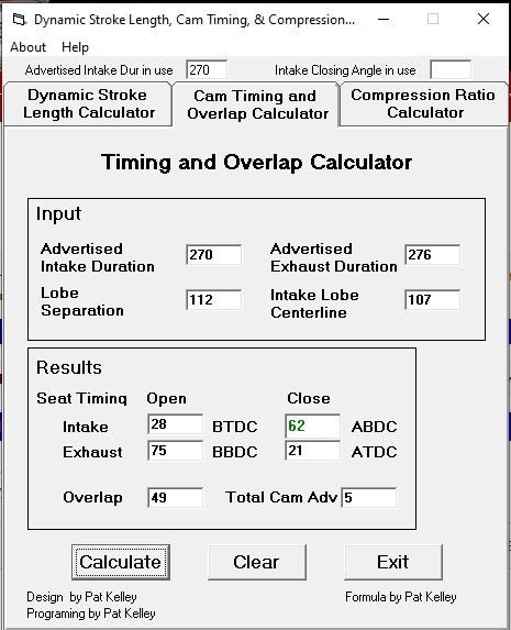

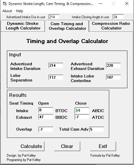

Post everything that you've got.
After I bought the cam based on some recommendations here ($99....I love a bargain, though price alone is certainly a lousy reason to buy a cam), I called Crane and asked for a 2032 cam card. This is what they sent me.
From the Crane catalog...
Per the Crane tech I spoke with and notes I took (trying to keep up)...
Max Lift = Lobe Centerlines. Add and divide by 2 for Lobe Seperation Angle (LSA).
107 Intake Lobe Centerline
117 Exhaust Lobe Centerline
112* LSA
Crane says built with 5* advanced built in (107 Intake Lobe Centerline). Install straight up.
File Type: xlsx
Old Jul 23, 2022 | 12:06 AM
  #124
skinny z's Avatar
Joined: Dec 2005
Posts: 9,933
Likes: 893
From: 53.0907° N, 113.4695° W
There very well could be inaccuracies in the above.
Let me know.

OK, The Crane 2032 advertised duration is measured at .004 according to their lobe catalog. Duration at .006 is probably more like 264/270??? If so, the DCR would probably be more like 7.68. And there's a typo for the 1.5 lift on the 2032 - it's 0.452 and a typo on the overlap on Jones Custom 2. I also can’t find a 252/206 Comp hydraulic roller profile in their master listing (there is one in a flat tappet).
Added an estimated vacuum collumn - might not be what the engine actually makes, but the trend is accurate. Also added the 4x4 260H-11.
ALTHOUGH, if the GM 94666492
is really the Crane 2032, if I were the OP, at $115-$120 shipped, there is no question what I’d run. It would idle a little better than the Magnum 270 and almost as good as the 4x4 260H-11. While it would probably come a couple HP and lb/ft short of both, I dare say you couldn’t tell a seat of the pants difference and see no more than 0.1 seconds in the quarter mile between the three, max.
File Type: xlsx

Thanks for the corrections. The measurement values between brands and manufacturers is all over the map and it's hard to keep track. Just like the GM 395 that was discussed and clarified above.
I've come across measurements at the valve, at the lifter (so the rocker ratio gets in the way there) and heights ranging from zero through .004 to .006 for advertised numbers.
The 4 x 4 cam looks interesting.
I could add a few more columns as well. The vacuum is a nice addition (RPM and elevation specific) and I could do the same for an estimated cranking compression.
I wanted to get this out there to initiate a little dialogue just like this.
Thanks again.
I also corrected the 270 HR in that I had listed it as 270H. I've yet to update the spreadsheet. Speaking of which Bad, could you post the .xlsx file? I'll up date my own and go from there.
You're spot on with respect to the differences between any of the top choices. You'd be hard pressed to tell. Some of it will be very dependent on the rest of the overall package (headers and exhaust) and how it's assembled and tuned and timed.
Personally, if the exhaust system is up to it, I tend to favour a little overlap to help with the scavenging, cylinder fill and VE. But again, that's combination dependent.
Now, where is the OP?

Added the spreadsheet.
Yeah, looked at the duration at 0.200 to make the WAG on the duration at .006 compared to .004, could be more than 6-degrees difference.
The tighter lobe spreads are very exhaust sensitive, not so much on these with lower durations, but the wider lobe spreads tend to be more forgiving on less than a "zero loss" type exhaust. On the F-bodies with a typical single 3" exhaust, I tend to recommend a little wider lobe spread than I would for a true dual exhaust. What I've found over the years is that for the most part a single duration cam will make more torque vs the amount of vacuum when compared to a split duration cam. However, adding a little extra duration on the exhaust will typically add just a little HP and hold it longer without seeing much if any drop in torque, but at a cost of loosing a little vacuum. Many times adding more than 4-6 degrees duration to the exhaust side does nothing to the HP or the RPM range and just starts killing the vacuum. That's not usually a problem on cams as small as we're looking at here, but can mean a lot when looking at the drivability of a ragged edge combination.

Thank you VERY MUCH for taking the time to do this skinny z! I really appreciate the effort, and the learning opportunity that this presents to me.
Now, given your level of experience, I'm going to assume your numbers are RIGHT (except for one that I "think" is typo), and that somewhere my calculations are WRONG. But this will give me a chance to learn.
Like someone learning to speak a new language (lets say German...I always wanted to learn German), I can only take this at a slow rate, not a conversational rate of speech. So bear with me.
Statement: Seeing the DCR calculations Vs overlap is very educational.
Looks like I have the only one of the group with a 112 LSA...a David Vizard no-no for my type of build.
The one mistake I see on the Crane 2032 / GM GM 94666492 is the intake lift with a 1.5 rocker. Cam card says 452 (I came up with 451.5, to split hairs). All the others look right.
Now a question. When I ran the numbers through the mgispeedware.com camshaft calculator, I came up with an intake close number of 36 ABDC. Your table has IVC (I "assume that is intake valve close) of 62. Are we measuring the same thing here?
One thing I don't understand about the mgispeedware.com calculation is it has my overlap at -7*. A far cry from the 49 you came up with, so I'm not sure I trust that calculator now that I'm looking at it.
And this is where my numbers really go off the rail! LOL When I took as stab at DCR, I came up with 8.15. Here are the numbers I used (this is going to be embarrassing, but it's one way to learn I guess). I don't know where I got the "formula" that this follows. I have no recollection of what the "+15" represents. I try to keep notes because I know I won't remember this stuff, but that doesn't always work out.
Static 9.3:1
Rod length 5.7"
Stroke 3.48"
Intake close 36 ABDC, +15 = 51
= 8.150
So that DCR is the thing that we come up the farthest apart on. I know even my number is not going to be that high, because I used the "advertised" CR of 9.3:1 (actually, we both did), and the reality if probably closer to 9:1.
EDIT: Well, slow typer, thinker and fact gather that I am, I see 4 or 5 posts have been made since I started typing my reply.
I'm just an enthusiast. And while not actively building something or helping someone (and it's been a couple of lean years I'll say) I like to dabble in numbers. And those numbers could easily be wrong. Mathematical error or haste in typing. Take your pick.
I've long followed Vizard's approach with respect to LSA. He emphasizes it's significance so who am I to argue?
BadSS caught that too and it's been corrected on the spreadsheet.
What duration lift value are you using? Looks like .050" as compared to .006" which is what I use. The intake valve closing value (IVC) is what we're really after. The .004" number when used, adds another dimension and how that impacts the stated IVC I can't say. It was it mentioned that it could amount to 6 degrees or more. So half of that for the IVC change.
Again, that's looks like .050" numbers.
Static 9.3:1
Rod length 5.7"
Stroke 3.48"
= 8.150
.050" numbers.
It was easiest to reply in point form like that. Hope it makes sense.

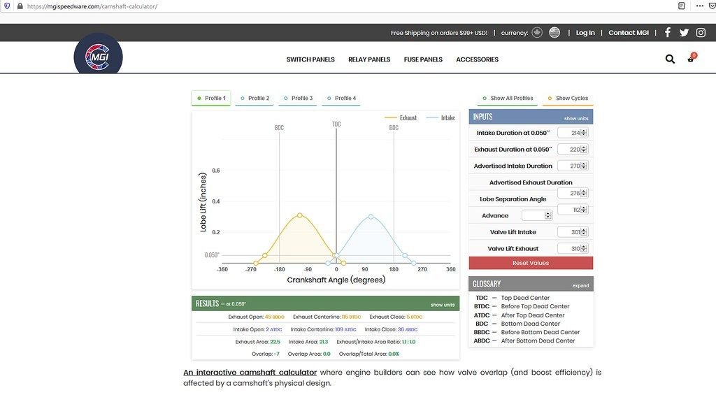

Thanks skinny. Yes, the mgispeerware tool calls for an @.050" number. Here's a screen shot of what that looks like. It's on the internet, so it must be true, right?
This calculator could be hot garbage, or I may have filled it out wrong. Not really my specialty.

My preferred calculator. It's a download at the end of that link. Good tech paper too.
http://members.uia.net/pkelley2/DynamicCR.html
Targeting 9.3:1 SCR with the Crane 2032. 270/276/112 LSA/107 ICL (installed "straight up").
7.6:1 DCR.
Using the .050" numbers (214/220) the IVC with a 107 ICL is 34. DCR shakes out to 8.8:1.
There are discrepancies between calculators that I'm aware of. I base my comparisons on always using that same Kelly calculator and correlate my successes and failures against that.
The most logical and obvious reason for using the advertised duration value for the IVC and DCR calculations is that this is where the cylinder has sealed sufficiently and starts to build cylinder pressure.
Keep in mind this is a static engine modelling. It has it's place to be sure but once parts start moving around in a big way, there are so many other factors in play.
Does that calculator have a setting somewhere where you can chose what to use? Or simply use the advertised number in place of the .050 numbers and see where that gets you.
EDIT: I see you haven't any entry in the advance box. That cam has 4 degrees ground in so that will change your numbers. And you'll have to have verified that ICL when you degreed the cam.

Originally Posted by Fast355
Between the 270HR, the Howard cam, Jones 1 and Jones 2 they are nearly exact overlays. The Jones 2 shows slightly improved numbers vs Jones 1. Crane 2032 may be the best return on investment given the cost of the GM equivalent. I averaged the 0.050 and Seat to Seat numbers and used them for the graph. I did not have time and all the data to model it with complex data in Engine Analyzer so the simple DD2000 will have to do.
It's more than enough to see the trend for the different specs. Yep, I think with the price point of the Crane equivalent and considering the vacuum numbers, there's no question it would be the one I would pick.
If price and vacuum didn't come into play, I think the Howard makes a great compromise between making the most TQ and the most HP. If TQ was the major consideration, probably the Comp 258/206-108 with the Comp 260HR11 giving up a few lb/ft for a few more HP. If HP was the major consideration, Jones 2 with the Howard being a very close 2nd (considering the ave TQ).

It's easy to see the HP and TQ trends. The highest DCR yields the best torque output. This naturally correlates with the IVC. Except the GM 395, I think has some issues in the modeling as the DCR and IVC match up with Mortorq's custom grind yet it's way off the pace output wise. Probably something to do in the conversion from GM's seat to seat timing and the traditional .006" number.
Now, the question is, which will run comfortably and without being crutched by a less than optimal timing curve on regular grade fuel?

IVC on the 256/274 @ 0.06, 112 LSA and 107 ICL is 55*.
I finished my breakfast and working on a 2nd cup of coffee too.
I included the cam specs with the new theoretical cams. The last engine has 1.94/1.60 059 heads that I ran on a prior engine build. They have traditional 45* exhaust seats and 50* intake seats. Flow 126 @ 0.200, 240 @ 0.450 and 235 @ 0.500 intake and 123 @ 0.200, 170 @ 0.450 and 174 @ 0.500 exhaust.

I was comparing both the theoretical cams head to head. The IVC is sooner because of the shorter intake duration.
256/274 @ 0.006 with a 112 LSA and 107 ICL results in a IVC of 55*
266/266 @ 0.006 with a 111 LSA and 111 ICL results in a IVC of 64*
266/266 @ 0.006 with a 109 LSA and 109 ICL results in a IVC of 62*

So the Crane has a slightly above mid-pack finish. I'd be happy with those numbers (290hp @ 5000 - 339tq @ 3500, a 120h.p. and 84 lb. ft. gain) if I could get them. Mid-range torque looks good for the street. With 3.42 gears and an S-10 converter, it should move pretty well. My aim was to end up with a 50% increase in H.P., so from a 170 base, 255 would be the "goal". @55 is only 25 horse more than a factory L30 Vortec engine, so that seemed reasonable to me. Seems like there's good chance of hitting that. Anything above that is gravy. Approaching the magical 1 horse per cube is dreamy.
It does still have the 2nd worst DCR of the bunch, which is a little disappointing. And that's with calculations assuming a 9.3:1 starting point, which is probably not the reality of things. From what I've read, DCR in the 7.5 - 8.5 (8.25 to be safe) range is desirable for a pump gas motor (anything from 87 regular to 93 premium is OK with me). With actual SCR being lower than 9.3:1, I'm concerned about falling outside of that suggested range.
