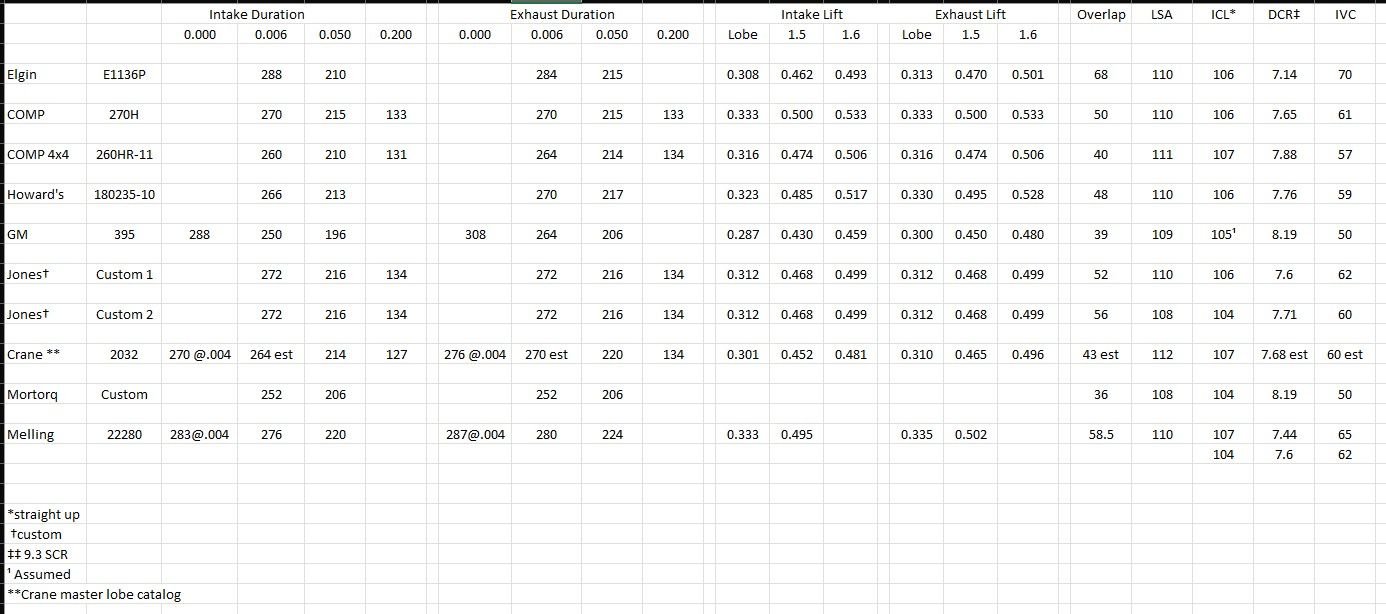

Don't sweat the DCR's differences too much. With the spread that's there, there's not too much to choose. I think you're 2nd worst of the bunch summation is a little harsh as a couple of tenths shows up on paper but probably not via the butt dyno.
If you were so inclined, you could always the advance the cam. This will close the intake valve sooner and bump up the DCR. With the wide LSA, I can't see the top end suffering too much. The bump in low RPM torque could pay dividends in the HP department.
At this point, maybe you could focus on the rest of the package. Build to first principles and ensure that the induction (especially cold air) and the exhaust are up to it. And timing, timing, timing. (Fast is a king in this department).
Speaking of exhaust, I don't recall your setup.
It was mentioned that 1.6 rockers might have a marginal gain, but at .452" with the 1.5, it leaves something to be desired. IIRC, the little 059's still perform at .500". Get there at least once in the lift cycle if you can. I'd say there's some HP there.
Not sure where you're at with your build process either. Have you measured the piston to deck distance? SCR and DCR could both be out to lunch if something is off the normal.

Played around with some more numbers. Took the TOP 3 off the shelf cams in that group, then crunched them with Rhoads V-Max lifters. Tried V-Max lifters on both intake and exhaust and just intake. The Rhoads are fairly linear in their duration increase. I started with 1,000 rpm as a full collapsed point and 4,000 rpm as back to full duration as an assumption. With 3,000 rpm and 500 rpm increments, 6 points total, 20* duration difference between fully bleed off and fully pumped up, results in a 3.3* increase per 500 rpm. Just some methodology, while it is not perfect, it is a fair assumption. It actually somewhat offered the best of both worlds running the Rhoads V-Max on the intake only. It decreased the intake duration, closed the intake valve earlier, and gave a wider duration split at lower rpm, all of which seemed to increase torque.
File Type: xls
Good point. While they recommend "straight up", that might help some.
Yes, I had also noted in this thread and in prior reading that the 2032 is very modest on lift. I guess thinking on that has changed over the years. That's one issue with choosing a grind that is probably 25-30 years old. I ran those numbers some time back when shopping for rockers. 1.6s will give me 482 on the intake and 496 on the exhaust. If these number from the internet are to be believed, the 059s do continue to flow up to .500 lift.

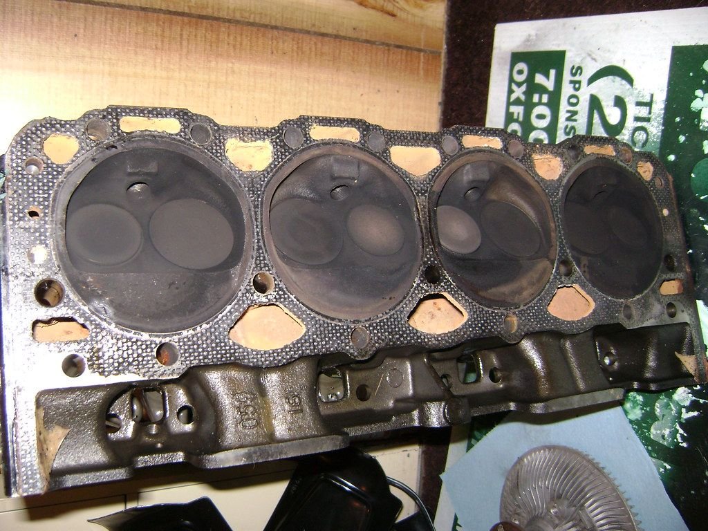

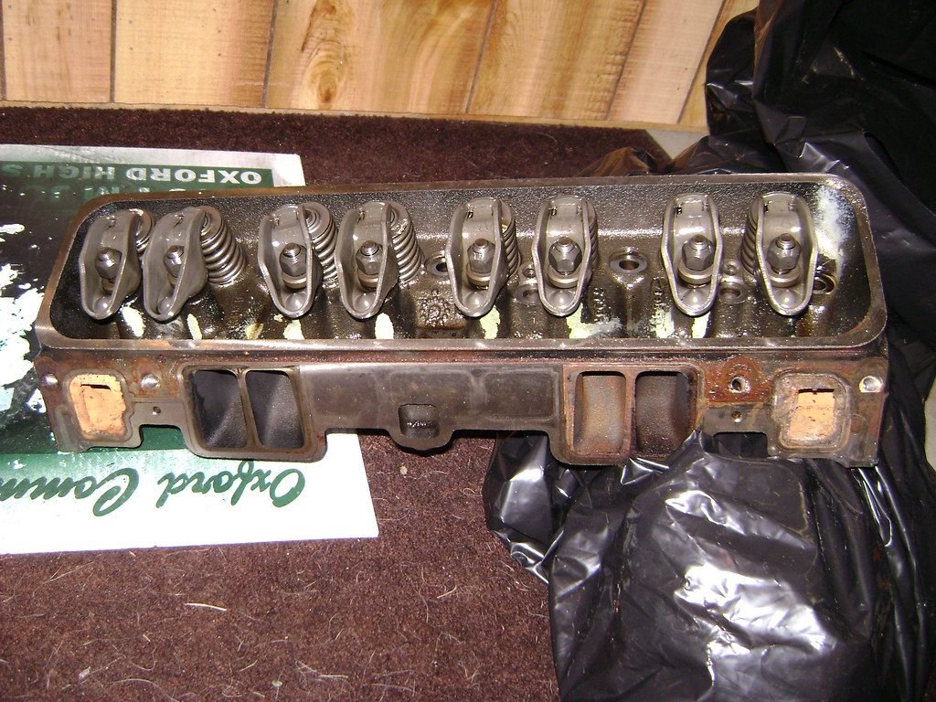

FWIW my 059s off a boat outflowed the mexican 062s that came on the mexican 350 crate engine that went into my 97 van back in 2006. The mexican 062s flowed 218 @ 0.450 and nose dived to 210 @ 0.500. With stock 1.84 valves my 059s were 218 @ 0.450 and 224 @ 0.500. With the swirl ramp in place, 1.94 valves and the throat opened accordingly with a 50° seat the 059s flowed 240 @ 0.450 and 235 @ 0.500. I ran 0.480 lift with them. At 0.480 they were still flowing 238 cfm.

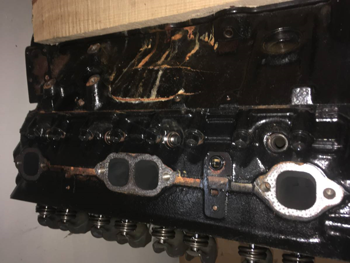

It was higher up in a stack of things. Had been there for years. Not sure WHY it fell, but when it did, it knocked over a large box with a car cover (all synthetic fiber) in it. It tumbled across the floor and in front of a bullet / salamander heater. When the thermostat kicked on, it burned that giant synthetic ball into a liquid mess, creating all the millions of little strings of black soot and smoke that you get when you burn plastics. Only a few items actually "burned". Most of the damage was from smoke.
https://youtu.be/qy90bOCTpjM
I subscribe to that YouTube channel. He's a member here. Lots of good Vortec head info on his channel.
Those are good numbers for a factory 305 iron head!
On a somewhat related note, how did you clean the corrosion out of the coolant passages on your heads? I'm not sure if a std. machine shop hot ank treatment will clean them up or not. (I have not personally hot tank parts in 30 years). I had thought about pre-soaking the heads with IronTite.
https://irontite.com/thoro-flush/
OP / Mortorq, were your 059s from a marine engine? If so, did you have to deal with any extra corrosion?
My 059 heads, a 395 cam and a forged 305 1-piece rear seal crank, PM rods and pistons as well as a single roller timing set came out of a 75 hour engine that the owners wife let freeze in the process of a nasty divorice. They were like new.

Soak the casting in cleaning vinegar. Cheap and effective.

My 520(059) heads must have been off a Silverado or something, because there was not any corrosion in the passages. I purchased the pair already off the engine.

I'd like to get a better look at the 395 specs. Something is off in terms of output vs the DCR and IVC calculated.
If the advertised numbers hold true, with the at lash values (.000"), then the results make sense. When the deciphered .050" numbers are used, it should make the most torque of all of them or be on par with Mortorq's custom grind.

So, possibly more analysis coming of the 395 cam’s output vs the calculated DCR & IVC?
Only thing missing is some real lift closer to .500” to use with the valve guide clearanced #520 heads.

Judging by the link posted by Fast I can't see why, when using the .006" and .050" numbers as well as the LSA and ICL as posted in the link it should produce decent torque.
https://67-72chevytrucks.com/vboard/...d.php?t=255659
The lift is a little thin and even with 1.6 ratio rockers you're at .480" or so.
Again from what was posted (there's a link to Stan Weiss' website somewhere above) that is about the point where the flow has already diminished. Might now be a bad spot to end up. It looks like you'd pass through the sweet spot of maximum CFM twice in one cycle.
Always a good place to be.
I'll probably drag out my old DynoSim software and maybe PipeMax on Saturday and see how it shakes out at my end.
I'll say there are better spec'd cams to be had but it may be you take what you can get.
It's something that can always be changed despite what a PITA an in car cam swap is.

Use. Melling cam # 22280. Be sure to degree it in.
On this cam for in a 305, to enhance low mid torque. I recomend you move this cam.
Move to 104 intake C/l.. cam card is 110 LSA 107/113.. You want 104/116. You're moving it ahead by 3 degrees from cam card.
Get the CR up to 10:1. (Final head chamber volume, Head gasket ,. piston deck clearance.
Some might like a 1.6 intake rocker.
No waiting for this one.
Just right for a 5 speed manual hot rodded 305 with ported heads.

Thanks for the input, certainly appreciate it, but holy cow.
Everything I’d read, heard, learned, was told, etc is that a little 9.0-1 305 will be a slug off idle with a cam as big as mid 220’s. @ .050”, and a tall 3:08 posi no less.
Advancing the Melling cam that much could make that big of a difference with all that extra duration?
Granted, the stock cam has only 179*/194* @ .050”, & that’s an additional 41 degrees of intake duration with the Melling #22280 cam.
Just sayin’.
Melling 22280.
Advertised Duration: 283 int./287 exh.
Duration at 050 inch Lift: 220 int./224 exh.
LSA: 110
ICL: 107
Where does Melling measure their advertised duration ? We've had this conversation at Speed-Talk and IIRC it's not at .006" lifter rise.
From that conversation:
Comp is .006" lifter rise.
Melling is .006" @the valve (or .004" lifter rise) (SAE)
They are not the same thus not directly comparable
"shoe size". Typical difference is 7-8 deg seat to seat.
If you are going to compare cams on a simulator you want to compare them accuratly at the same checking point.
As well as:
Note the melling cam seat to seat dur is @.006" valve (SAE) or .004" lobe lift. So to compare to a Comp shorten seat dur by 7 deg to be same same.
So the Melling cam posted above is more like 276/280.
I'll add it to the list as see where it shakes out.

275-279 duration .006". With the T5 5 Speed manual trans it is fine. (This is a baby cam . (shoe size). as cams go.
Of course more gearz is always more better.
You are way over analyzing on the cams.
It is not hard to get the cr correct on a flat top 305.
10:1 or very close to it is the target.
Little motors need compression.
This is where most go wrong on 283 builds too.
9:1 is not enough reguardless of what cam.
It needs 10:1. N/A
If 9:1 cr supercharge it.
(can use that same same cam for that too.)
You can go on YouTube and listen to engines running with this Melling camshaft .
Its not super radical at all.
Its more like a 218/ 218 108 LSA cam in on 104.
It will be very torky and responsive installed on 104
With a good spark advance curve and 10:1. with a dual plane intake.

Melling cam calculations with a 107 ICL and a 104 ICL.
Static compression is 9.3:1.
Keep in mind that there is still the consideration of using regular grade fuel. Otherwise, I'd say get the SCR up to 10:1.

Personally, I'd like to see a bump to 10:1 as well. The trade off for using premium fuel could be better fuel economy at cruise. At least this is what I've found.
Where would the IVC land using that math?

According to the GMPP install instruction sheet the LT4 hot cam is 272-281 @.006" lobe lift.
109in/115ex centers 112LSA
..328" lobe lift. .492" (1.5rr.). .525"(1.6rr)
219°/228° @.050"
Remember this cam was intended for the short runner "anti-tuned" EFI manifold and 10:.8:1 CR of the LT4 engine. Using 1.6 rockers.
You may find performance benefit on your engine/ car combo and driving purpose by tweeking the camshaft installed phasing +/-.
Like I suggest trying with the Melling camshaft.

At 9.3 it looks to be a good fit on a 106 ICL.
​​For a little more pop, it could advanced to 104 although I'm not sure to what benefit.
