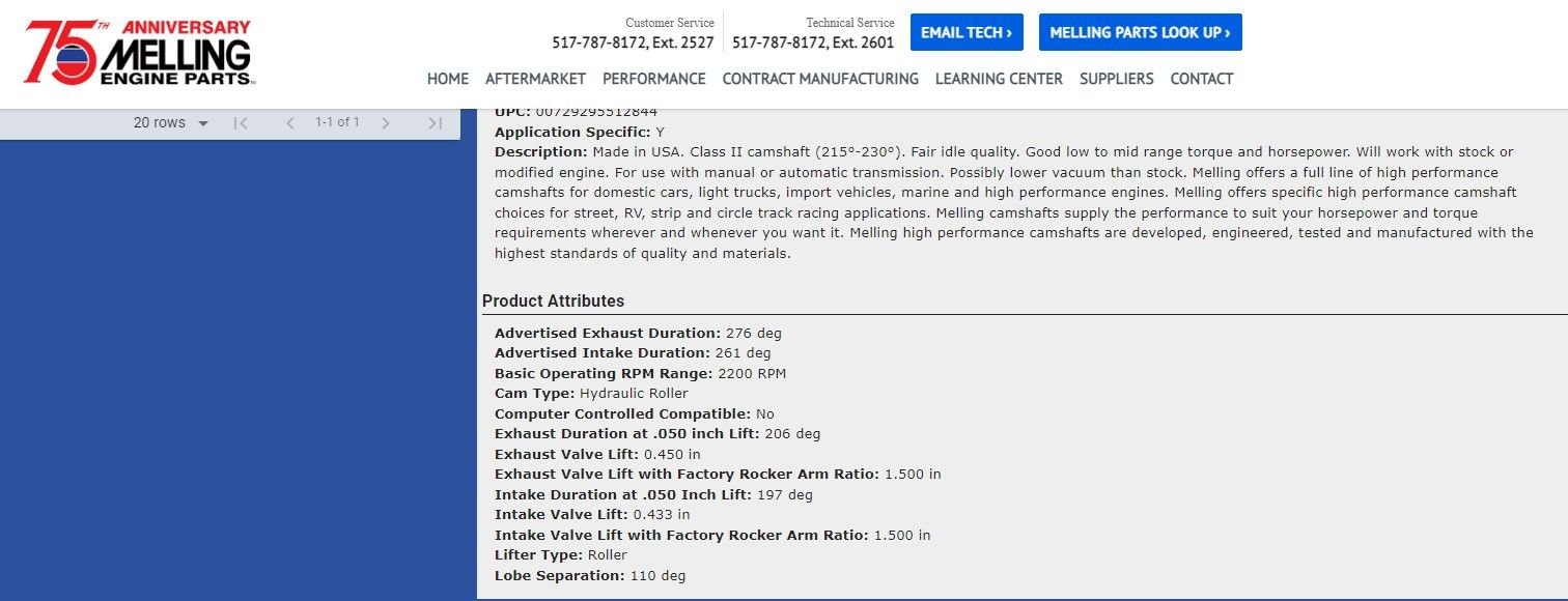

If yiu want something short duration like that look around for Melling Cam #22221
197-206 .433/.450" .(.462"/.480" w/1.6rr)
109 LSA 105/114 centers.
261°/276° adv dur
It makes very good low and mid range power and torque.
Used in the GMPP RAM JET 350 vortec EFI crate engine.
261°/276° adv dur
Mellings measure their advertised at .004" don't they? GM too?
That's about 7 degrees in the difference when comparing to somebody likes COMPs measurement of .006". Both at the lifter.
So apples to apples it's more like 254/269 . Really gentle on parts by the looks of it.
Or is that math off a bit? Less spread with a small cam?
If it's right, that would be a snappy spec. Premium fuel but really good torque. And that's at 9.3:1. (Yes, you could tune it for regular fuel.)
That's very close to Mortorq's spec. If you slot it into the posted spreadsheet it basically overlaps his custom cam. The difference wouldn't be observable.
Yes and yes..
If its a mild short duration cam he wants this one is proven.... Its also used in the popular GMPP 383HT crate engine with vortec heads.
The Melling 22280 cam in on 104 will work fine with 9.30:1 cr.. Its just better when the CR is 10:1 and on that engine is not hard to get there.
It will be a great performer in this car.
I'd run either of these cams in that 305 with 10:1 cr.

If I didn’t wait, & went with Fbird’s Melling 22221 or the GM 395 cam, I would like to get closer to .500” lift to truly take advantage of the little Vortec 520 heads better flow.

The Melling catalogue shows the 22221 as a 110 LSA. (Not that it matters all that much).

The GM 94666492/Crane 2032 copy is within 4.5 HP and 2.5 lb/ft TQ on average of the Comp 270 via DD2000’s estimates. I ran them through EA Plus to see what it estimated before making this post. While the numbers aren’t the same, the average results of the “GM492” came within 3 HP and 2 lb/ft TQ average of the Comp 270. Plus, although the Comp wouldn’t be problematic, the GM492/Crane would have about an inch more vacuum at idle.
I even simulated the 207/213-112 measured results someone made of the GM492 and compared it to the Crane 2023 specs - just in case it really isn’t an exact copy. Average TQ and HP from 1750-6250 were more or less equal with the 214/220-112 specs making 1 to 3 more HP over 4250rpm and the 207/213-112 specs making 1 to 3 lb/ft more under 3250rpm.
It appears the 492 cam is available at worldpartsdirect.com based on them saying they have 2 available on eBay at $155.40 shipped.
https://www.ebay.com/itm/40363541738...kAAOSwmNJib-6z
Since they should have two in stock, might want to check directly with them and see what the shipping would be to you - it's showing $108 and $20 shipping to me ($128). https://www.worldpartsdirect.com/oem...shaft-94666492
I also wouldn’t hesitate a second running the Elgin 1.6 stamped steel rocker arms on the GM492 cam either.
https://www.competitionproducts.com/...tinfo/ELG6738/
While it’s been a quite a few years, I’ve used those ($110 - hopefully still made in the USA??) and the Crane stamped steel rockers a number of times without issues on hydraulic cams around and under .500 lift. That would be another plus for me to go with the GM492 cam - $238 shipped for the cam and rockers.

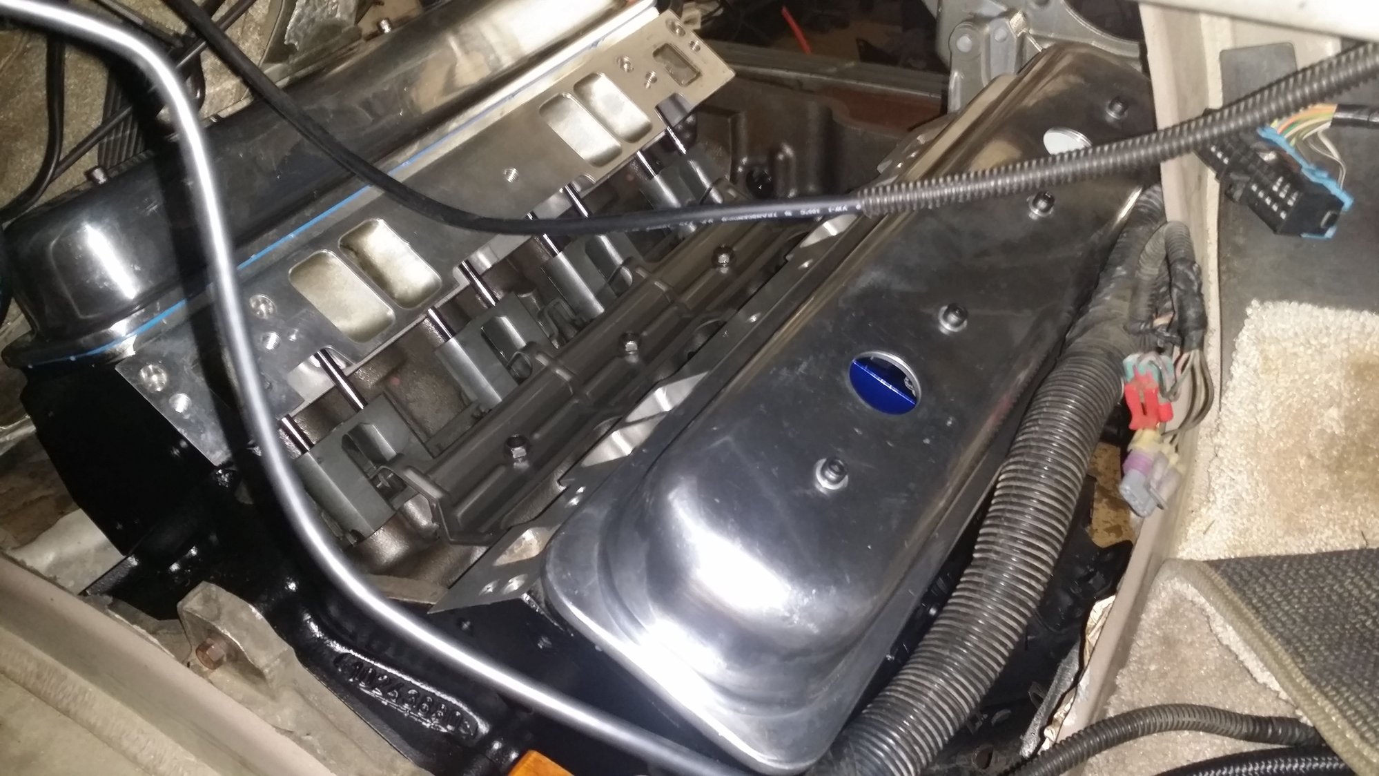

I know what you mean. I have been wrenching on them since the early 90s helping my dad work on the old G20 and the C10 he had. I remember having to change a valve cover gasket on the 83 G20 in a camping area of a state park after it started puking oil. I did my first top end rebuild at 16. My mom was shocked and amazed when it fired up.
Might look a bit off with all the OBD2 Vortec stuff all over it, but it still has a SBC heart.
