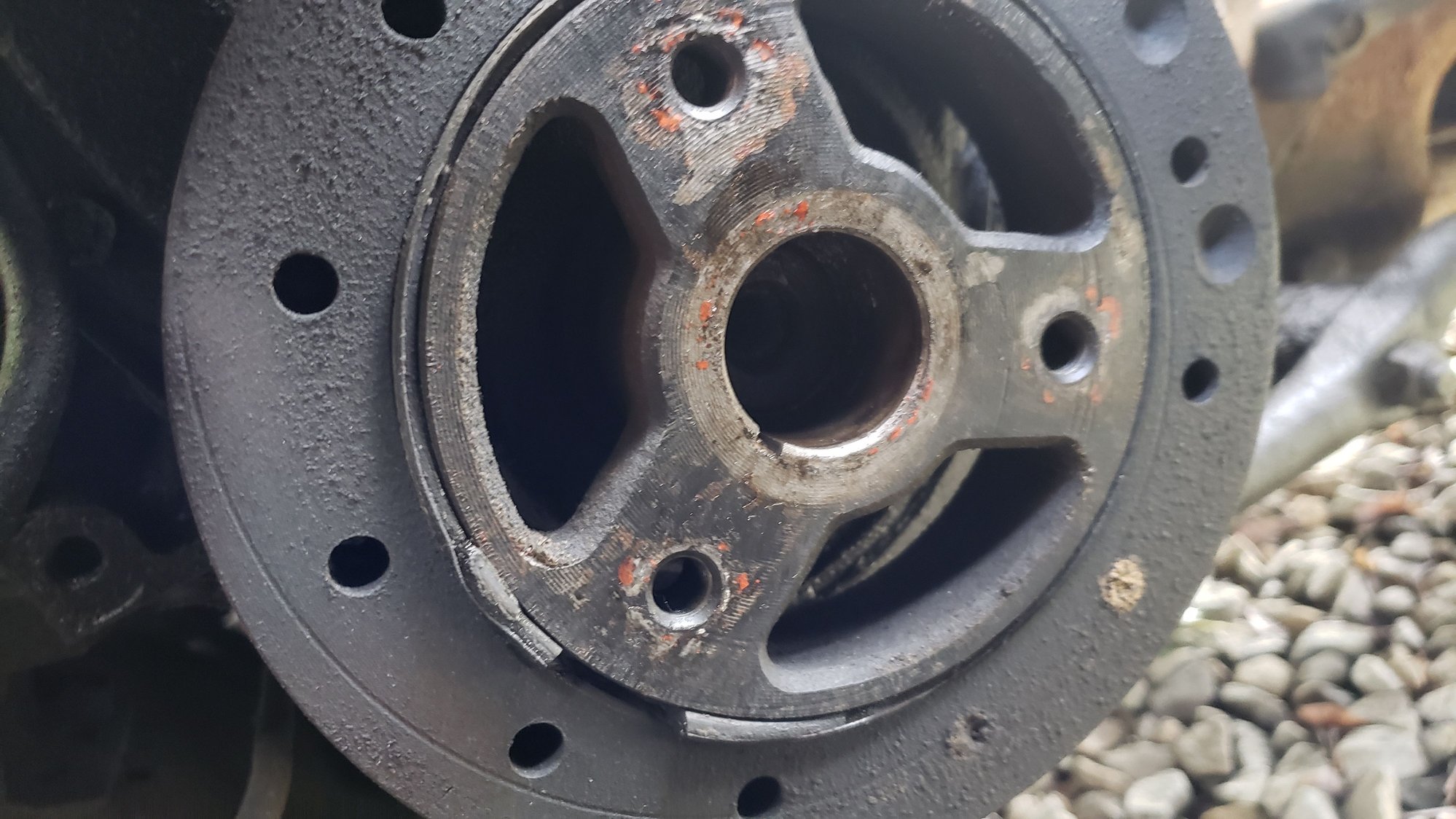

Well judging by the separated rubber and how its sticking out im assuming the balancer is definitely toast. I forgot i should have a tool for this so now i gota go get one or order, kinda wanna pull this one off and make sure its all good before buying another.

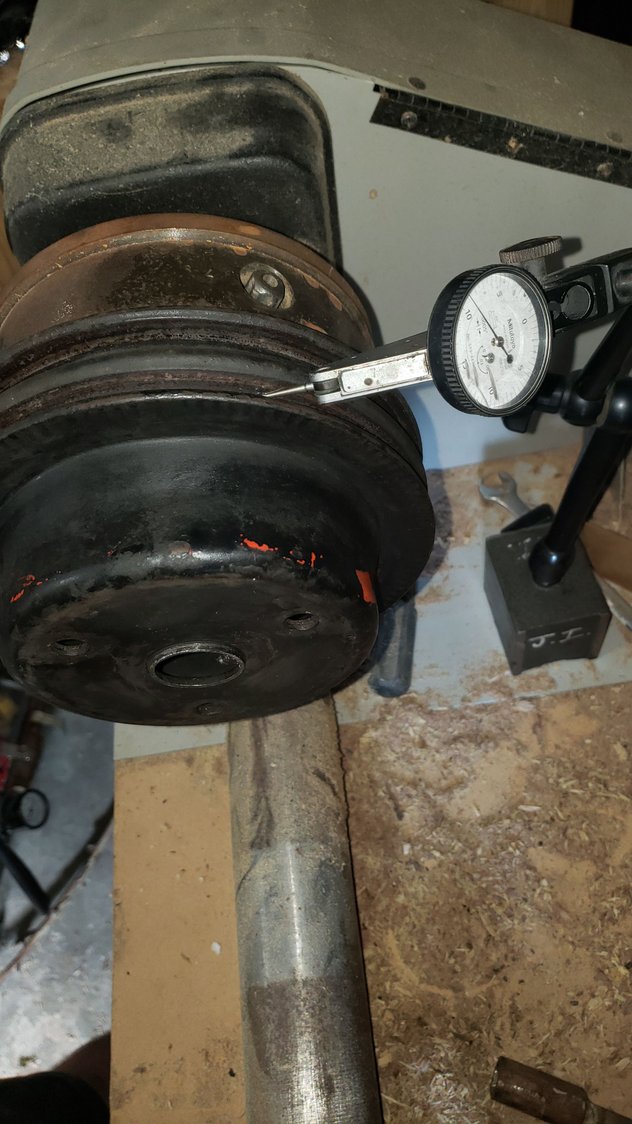

Oh ya im pretty sure i need a pulley aswell because i indicated it to like .005 on the side where it contacts the balancer and it maxes out my indicator at the groove. I tried getting the reading from deeper inside the groove aswell and same story.
