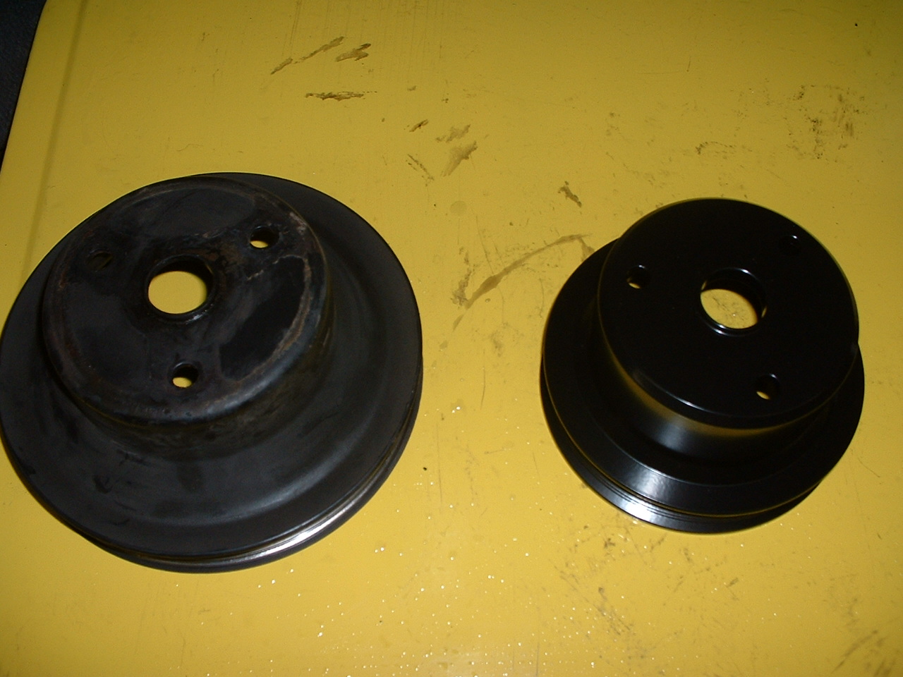

here are some pics, on the left is the stock crank pulley and on the right is the march #4405 underdrive crank pulley. Notice the rear lip on both and the significant diameter diff., but depth remains the same at 3 1/4". Hope this helps.

My pulley does not have that small lip on the end of the rear. I will measure the pulley in about an hour

yes the underdrive set for $50 at summit March #4405 is one I have pictured above minus the alt. pulley, good quality for the price. The lip on the back of the pulley actually rests inside the damper and the body of the pulley sits flush against the damper, which it doesn't matter if yours has the lip or not. So take off about 1/8" for the lip when measuring the pulley and it's very close to your 3". It was slow today so I did mock setup of a crank and damper to see if you can install the damper too far and you can by about a 1/4" which sounds like about the amount you are off. The rule of thumb when installing the damper is put it on and mock up the water pump with pulley and align it with the crank pulley to know how far to put the damper on. All the damper has to do is ride inside the seal of the timing cover and could be different for each application based on the pulley used, just seating the damper against the crank shoulder is not a given.
