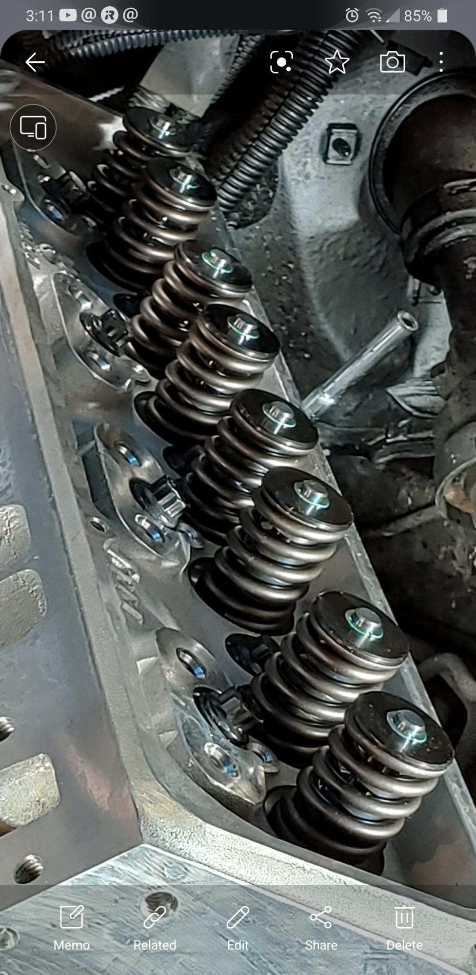

HI all, need some wisdom.
I have to replace my cam HFT. The cam specs work with the Alu heads I have, fitted with Hydraulic Flat Tappet hardware( see specs in pic). They are using a single spring (with dampener) with 120lb seat pressure. 1.250" OD and .510 lift max
My dilemma is that I need to reduce spring pressure for break in (after unsuccessful previous attempt not doing so). I have my old stock 882 heads, and wondering if I can use the springs etc from there for the break in. I am concerned about doing more harm than good so looking for feedback.
The 882 springs have the same 1.7" installed height but slightly smaller OD, I get 1.22" on calipers. I see that these just fit into the pockets on the stock head. Wondering if I put all the stock pieces on the alu heads if they will move about and cause damage. Looking at pics I had with the covers off there looks to be a base installed under the current spring that should prevent this.
The alternative I see, (but an expensive one for me being outside the US where money is worth half the US$ and freight is $$$), is to buy some new low pressure 1.250 OD springs just for breaking in that will hopefully be compatible with the retainers etc on the alu heads. I have found these ones at summit that seem to fit the bill
Chevrolet Performance 19154761 - Chevrolet Performance Valve Springs
My other issue though is that I have 1.6 roller rockers, and with this cam, the lift is right on the 0.510 max with the 1.6 ratio. So thinking to also use the 1.5 ratio stock stamped steel rockers for the break in. The cam lift at 1.5 is 0.477 / 0.480 so not sure if this will be too much lift for the stock gear also.
I see 1.3 ratio rockers are also suggested, but all getting a bit too much for my budget.
Would appreciate any thoughts / guidance you can give on this.
Cheers.

For break-in, I like used stock springs.
If your heads came complete and all set up (correctly), then you do not want to lose that.
1.3 ratio rockers are expensive but low-pressure break-in springs are cheaper. Either way, it's 1 time use.
BTW, the difference between 1.250" and 1.222" is.003". That is the thickness of 1 human hair.
So no difference to the retainer.
You might have another option - positive offset locks. These ADD to your installed height.
If your valve tips extend a sufficient amount above the top of the retainer, then this could be an easy (and cheap) way to reduce your spring pressure for break-in.
Look here: Locks, Keepers, Hardened 11/32" X 7 Degree, .050" Up Locks, Raises Retainer Higher, Sold in 1/2 Sets - Alex's Parts Sales (alexsparts.com)
When disassembling your heads, number and keep everything in order so that they go back together EXACTLY the way that they were set up.
OK, now search this site for HFT break-in tips.

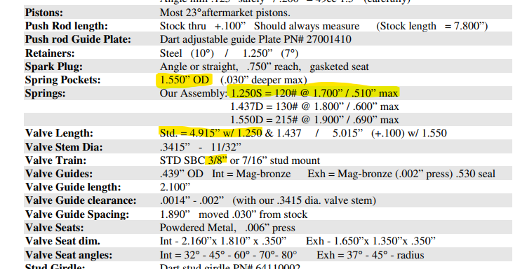

I've found the spring specs quoted as below ( I am not up on imperial measurements since in a metric country);
  • Hyd cam springs - 1.250 single, 110lbs closed, 280lbs open, max lift .510 in
I have been following up on the offset lock idea. and from comparative spring charts it looks like increasing from 1.700 to 1.750 would drop seat and open pressure by around 20lb which would seem to be ok. So the issue will be height of the valve tip above the retainer. Here is a shot of the valves before assembling the rest of the valvetrain, first time around. Could be a bit close? .05" is about 1.3mm by my reckoning.
It looks like there is sufficient valve tip sticking out of those blue locks for you to use the +.050" ones.
This assumes that your blue locks are ZERO (center).
And yes, that should drop your pressures by about 20 pounds, as you calculated.
