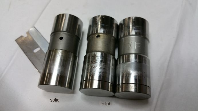

Okay, so let's open these lifters up and find out what is really going on.
Looks the same to me..............
Or does it?

.......Looks the same to me..............Or does it?
It looks like the oil hole is smaller in the Delphi VS the real GM ?
I never actually measured the inlet holes, but that was not the problem.
I'm typing up the solution now. Stay tuned...........

Okay, let's not keep everyone in suspense.
It is the thickness of the pushrod cup/seat that is the problem. The .058" thicker cup in the JUNK Delphi renders the pumping mechanism inside the lifter inoperable. It would be exactly the same as adjusting your rockers down all the way until just before cracking the valve off it's seat (on base circle). You have removed all of the preload and and if you were able to run the engine this way, there would be no oil coming out of the pushrods to lubricate the rocker arms (and cool the valve spring).

Re: Mystery solved: why some hydraulic lifters do not deliver oil to the rockers at i
I can double check, but I am 99% sure they were the same in every way - except for the pushrod seat thickness.
Originally Posted by 3rdgenmaro
Just goes back to the thread I started a year ago. Which lifters can you trust? I still haven't bought any, but the time is coming. Hard to spend $240 on a set of true Johnson Hylift, but durn Id hate to eat a motor for trying to save another $100.
After all of this and spending more money AGAIN to get this engine running again, I bought ISKY. No problems.
That's what I'm looking at right now. ISKY Anti-pump up 202-HY.
That is what I bought!
ISKY Quiet Power 202HY Anti-Pump-Up
Hydraulic flat tappet Superlifters (2 oil holes)
Manufactured by Johnson/HyLift/Topline
