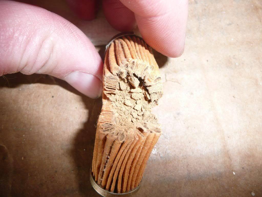

Paper are even easier to cut open.
This is what mine looked like after about a month, probably about 50 miles.
If it was mine, I would leave in the stock location. I am not a fan of external fuel filters. One more thing to leak or go wrong.
