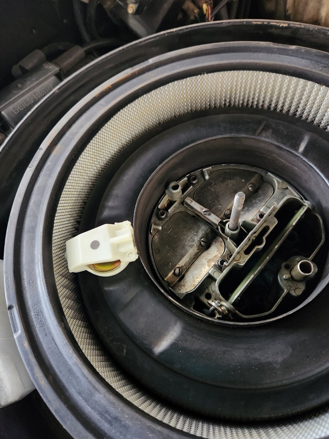

Where can I find a replacement for the thermal vacuum switch next to the air filter that controls the stove pipe valve in the intake snorkel? I know GM made a million of them in all different cars, but I'm having trouble finding a new one.

So really, any part number thermal switch that looks similar to these should work right? There's probably not much variation in temp settings, vacuum levels etc, at least not much to really make any difference between models.

I ended up finding a Carter TS1 on ebay, NOS in the box. All the others were either not available, or ridiculously expensive. Seriously, $110 for a thermal switch?
But anyway, ill followup and see if i have any luck once it arrives.

Just a follow-up. Installed the Carter TC1 switch in the intake. It's a different style, but it does fit. A little testing shows its open when cold and closes up around 85°, which from my reading, is pretty much exactly where the stock one is set.
I paid $31 for it with free shipping, which based on the prices I was seeing for other direct fit numbers, was a deal.
So thanks for the help Vader, you hooked me up on this one. 👍
