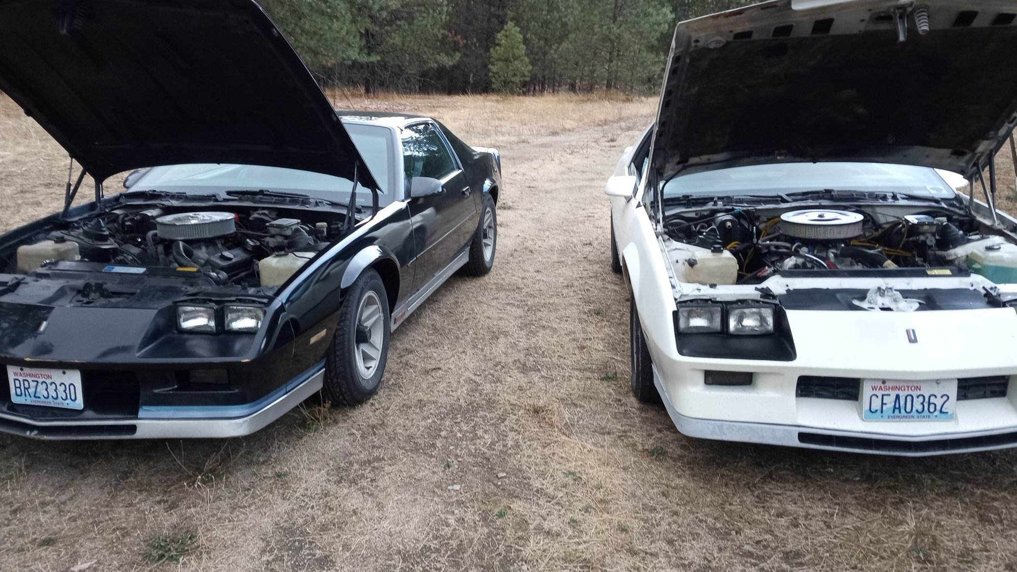

Here is a good comparison. Both are 1984 5 speed cars. Black has a rebuilt 350 with Flattop pistons and about 10:1 with 062 vortec heads no porting and a summit 1103 camshaft. Also has 3.23 rear gears. White car has a stock block l69 with same cam and vortec 059 heads no porting. Steel shim head gasket about 9:5 compression or so. Heads were surfaced slightly. 305 car has 3.73 rear gears. Both cars have same exhaust, intake, and carb. These cars are almost dead even from a 20-100mph roll. Each car inching ahead depending on gear change and rpm. Believe it or not the 305 pulls a bit after 90....must be the 3.73 gear and maybe better valve springs, as it revs clean to 6500 and the 350 seems to fall off at that rpm.. If gears were the same im sure the 350 would pull ahead, feels like more torque down low,. But the 305 definitely revs up high with the 059 heads...no prob. One time the 350 did pull ahead by one car length was climbing a long hill.. Btw Black car has run a 13.6 at 104mph with major wheel spin at launch...like a 2.2 60 ft time.

Not sure how you consider that a good comparison. Do the same things to the 350 that were done to the 305, and the 350 will smoke it every time...

Huh? Same cam, intake, Headers, And better flowing heads (062 vs 059) on the 350 not a good comparison? You should read the post completely before you reply.

They're not the same heads on both engines, and there is zero reason the 305 would rev higher, or that power would fall off sooner with the 350 since both engines have the same stroke. And you're comparing them in cars with different gear ratios. How about an actual "apples-to-apples" comparison?...
