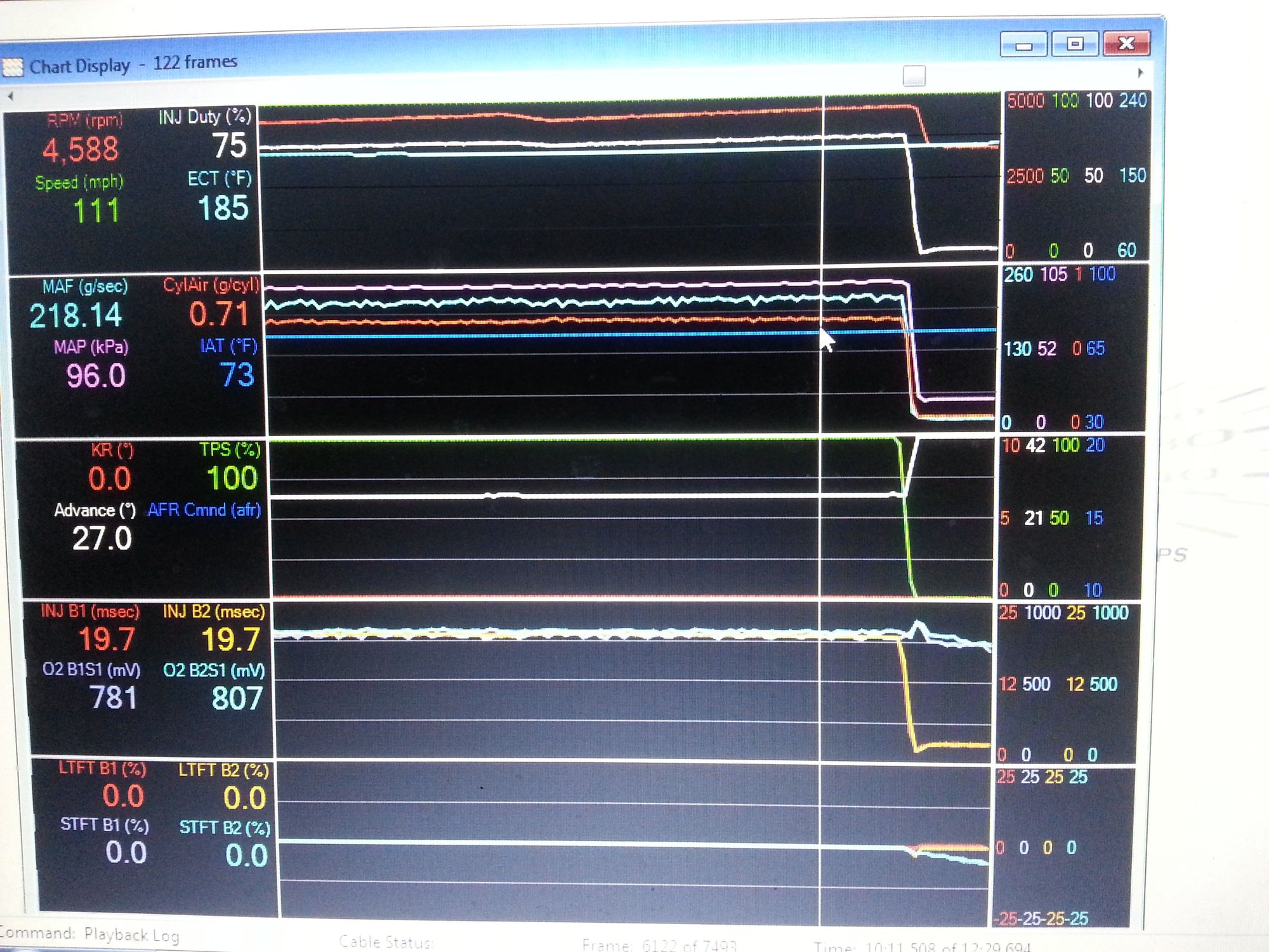

I'd just take the 305 to the track and get a trap speed. Assuming the cars both weigh the same....there's your objective comparison.
I'm a 305 hater....and I've had 3 of 'em. But MY comparison is:
Two box stock Chev Silverado, x cab, short bed, 4x4 trucks, both 5 speeds. One was a '96 350. The other, which I have now is a '98 305. Same-same, both stock, Vortec/5 speed same truck. One of my "dyno's" is a canyone I climb every day; Parley's canyon which gains ~2500' elevation over 13 miles from SLC to Park City. Climbing Parley's....
350 would go any speed I want (up to about 80?) in 5th gear. No prob
305 won't make it in 5th gear. It'll go ~75 in 4th.
Towing my boat up Parley's...
350 would go any speed I want (up to ~80) in 3rd gear.
305 will only go about 55-58 in 3rd. Using second gear, it will make it allllllmost to the rev limiter (but not quite) at 62 mph. So it's tapped out at 62/5500 RPM
Both stock Vortec engines in the same vehicle, same configuration, same gear, same trans....same-same. The 305 uses more gas in all driving conditions that I encounter. I wouldn't buy a 305 version of this truck again. I'd buy another 350/5speed in a second.
Sounds like you need to fix what is wrong with your 305 Vortec. Low fuel pressure or a plugged cat maybe. I have driven and owned half a dozen of each. The 305 and 350 have close to the same power even with 5-6k on the back. In the 3,000-5,000 rpm range the 305 and 350 make very similar power. The 350 falls on its face way earlier then the 305. In fact I have dropped the shift points from 5,000 to 4,600 on several 350s just to make them not feel like they are dying out. On the 305s I usually raise the shift points a smidge because they are still pulling.
The 305 in my 99 Tahoe with headers, baby cam and a volant CAI would do bad things to a stock 350 vortec and showed tailights to a couple of 5.3s. 305 got 22-23 mpg highway in a 5,000+ lbs Tahoe on 32" tall 20s with 3.42s. I pulled my 6,000 lbs travel trailer with the 305 a few times and it handled it like a champ. No problem running 70 mph in 3rd gear at about 2,600 rpm. Also pulled the same trailer with my Express van with the 350 and shorter tires. The van has shorter 30.5" tires and 3.73 gears. ~3,000 rpm at 70 mph. Tahoe had a 60E and the van an 85E. Power wise the Tahoe would get the trailer rolling noticeably easier. The van now has a 383 and the Tahoe an 8.1L and 80E. Van was about 700 lbs heavier then the Tahoe but had a small cam and headers as well and 45 cubes more.
Its not a little aerodynamic trailer I am pulling either. Its 26' long, 10' tall off the road and 8' wide.
The 350 in the van was no slouch either. Not towing anything it would run whatever I wanted to run. Could set the cruise at the GMs limit of 98 and the cruise would hold it all day long. Cruise can only open the throttle 3/4 open. The 305 in the Tahoe had no problem going faster then you would want to drive the brick.

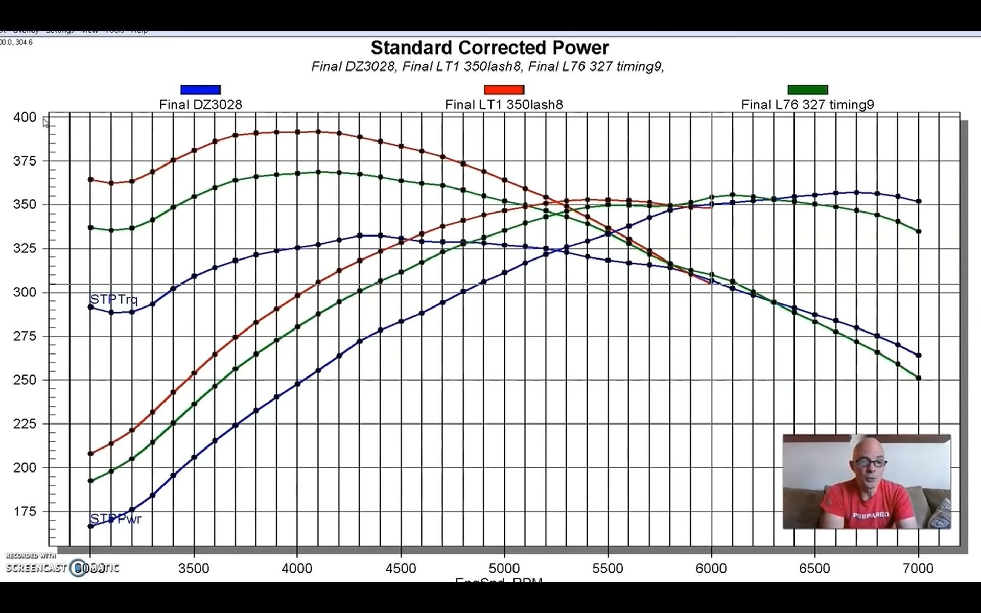

I think somebody said WWWWWAAAAAAAAAAAYYYYYYYYYYYYYYY earlier on in this thread:
Anything you can do to a 305, you can do just as easily to a 350. Only difference is, you START OUT WITH about 15% more, and you get about 15% more out of everything you do. FOR THE SAME $$$$. EVERYTHING. Buy a cam, you start out with 15% more, spend the same, and get 15% more on top of that. How is this hard to understand?
Why would you limit yourself to 15% LESS for your dollar? COMPOUNDED?
Let's apply a technique I learned (sort of) from one of the most intellectually gifted humans to ever live. I'm much too stupid to even observe such heights of genius, let alone aspire to ever achieving even a tiny fraction of what he did. But however all that may be, he called his technique the "thought experiment". It allowed someone willing to escape the bounds of their own preconceptions and prejudices, to fill in the blanks about what would have to happen if certain other things happened. It was particularly useful for situations that couldn't be duplicated on Earth even if they might exist somewhere else in the universe, but can be just as worthwhile in situations that are hard to do an A <—> B comparison with. So, let's do a quick one.
You go to the grocery store looking for steak. They have "levels" of the steak experience, like rib-eye, porterhouse, T-bone, round, chuck. Each one is a 15% increment in price above the next lower one. Furthermore, each packaged one weighs 15% more than the next lower tier. OK: the store offers a 0.87 lb porterhouse. You walk into the store and think, OK, looks good, I'll go for that. BUTT, for THE SAME PRICE, you can get 1 lb of rib-eye. 15% more food, and 15% better. Now the $64000 question: WHY WOULD YOU EVER BUY THE LESSER CUT OF MEAT? There's no real difference when it comes to motor displacements in the SBC family; a cam costs the same no matter what displacement, boring/honing costs the same, crank work costs the same, valve jobs cost the same, pistons cost the same, spark plugs, oil, coolant, ... all cost the same; WHY WOULD YOU DO ALL THAT TO A LESSER MOTOR when you can do all the same things to a GREATER one and get COMPOUNDED better results?
THAT'S what's wrong with the 305. Not that it's "bad"; just, there's BETTER choices, and therefore BETTER ways to spend your money. Spend EXACTLY THE SAME, get COMPOUNDED BETTER results. It boggles the mind to contemplate how stupid, stubborn, and pig-headed someone would have to be to ignore and even ARGUE AGAINST such a simple and obvious FACT. Yes I'm talking to those who have attempted to defend the 305 in this thread. YOU are the stupid, stubborn, and pig-headed ones.
The 305 is a perfectly OK motor, IN A VACUUM. If there were no other SBCs to compare it to, it would be ... divine, almost. BUTT: there IS something else. That "something else" is BETTER IN EVERY WAY, and ther initial cost of buying it (the core) is utterly NEGLIGIBLE in the big picture. Most especially, it's negligible if the "goal" is fixed: so many HP, a particular ET, or whatever. Whatever the goal is, it's EASIER with the alternative to the 305, than it is with the 305.
There are no "alternative facts", only alternative logical fallacies that the deliberately self-blinded might choose to allow themselves to subvert the cognitive dissonance that comes from willful idiocracy.
Nobody asked for your opinion to be frank. Frankly I do not care. I have built several good running 305s. Good 350 blocks are becoming harder to find. I have had several 305 blocks given to me that only needed to be honed, new rings and new bearings. I have slapped together 300+ hp 305s cheaper then I could have bought a core 350 for. In every vehicle I have run them in a 305 gets 2-3 mpg better then a 350 in real world driving.
As I have also said before...Why stop at a 350? When a 383 and 396 can be built from a 350 block for nearly the same money. Then why build a 350 when an aftermarket 400 block is not much more. Then again why stop at 400 when the rotating assembly for a 415 or 427 barely adds anything to that Dart SHP block. I built a factory 880 block 383 and would not have spent much more building a SHP block 427. Talking $800-900 more at the time. 383 runs great but a 427 would have been a different beast all together.
Then again if cubes are the answer, why not a big block 454? Stroke it to a 496. Or maybe a 502? 632? Why build a 350 when you can put 454 cubes in a small block?

To say that a 350 "falls on its face" sooner than a 305 is just nonsense.
They both have the same stroke, and there is no reason that a larger bore is gonna cause it to run out of steam sooner.
A 305 is a detuned 350, and detuning never makes more power (of course we ARE living in the Twilight Zone these days in case anyone hasn't noticed)...

Im no expert..but i would guess to say from looking at the dyno that the dz302 could run with the lt1 350 in a light car with deep gears. In the case of these stock type heads..Head flow limits the bigger engines ability to breath at higher rpm. Basic stuff!

Nonsense...

Nonsense? After looking at that dyno graph? wow Some people u just cant reach! the 302 revs out to 7k no prob! that a big deal...with the same torque than either the 327 or 350! boom! Deny the evidence! Now with AFR 195 heads...the 350 would win I'm sure.

I agree. I have the same argument with guys trying to put a "torque" cam in the 4.8L for towing. They fight me when I say the best cam swap for low end torque includes a 5.3L or 6.0L housing it.
