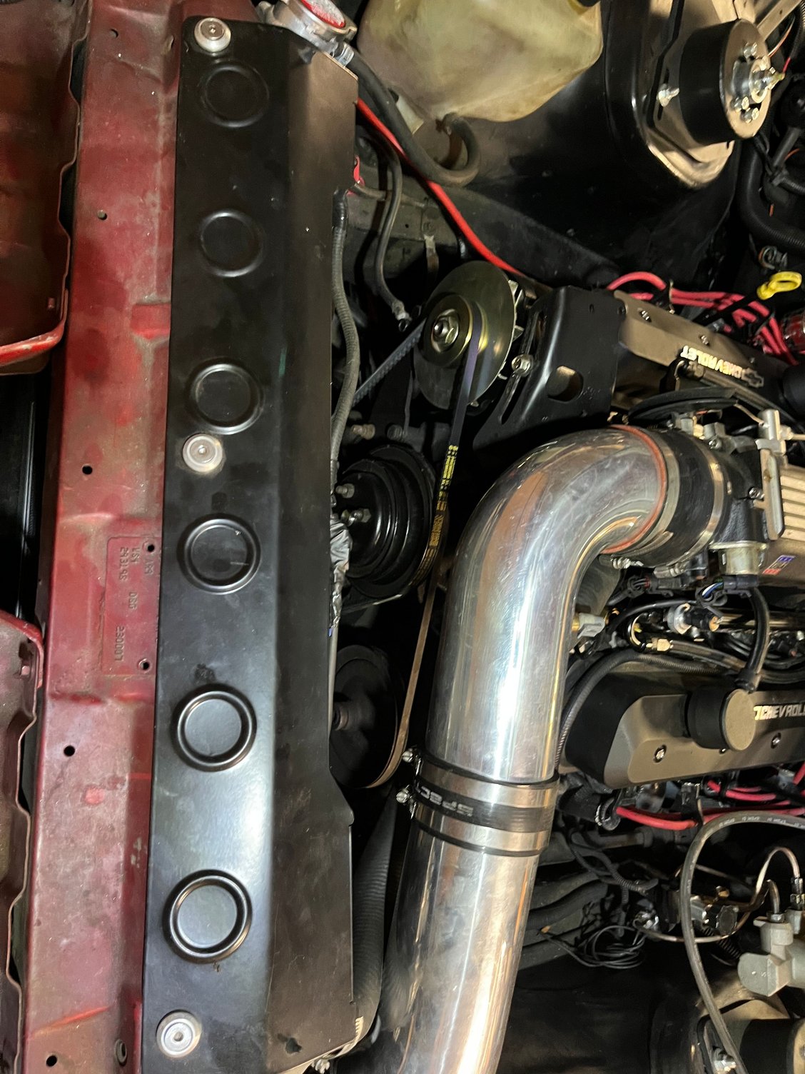

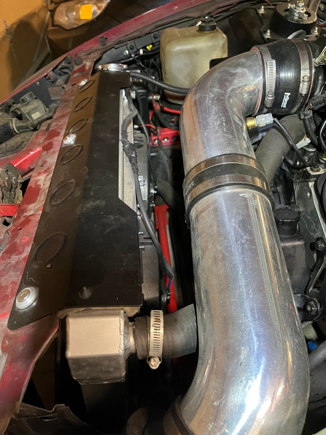

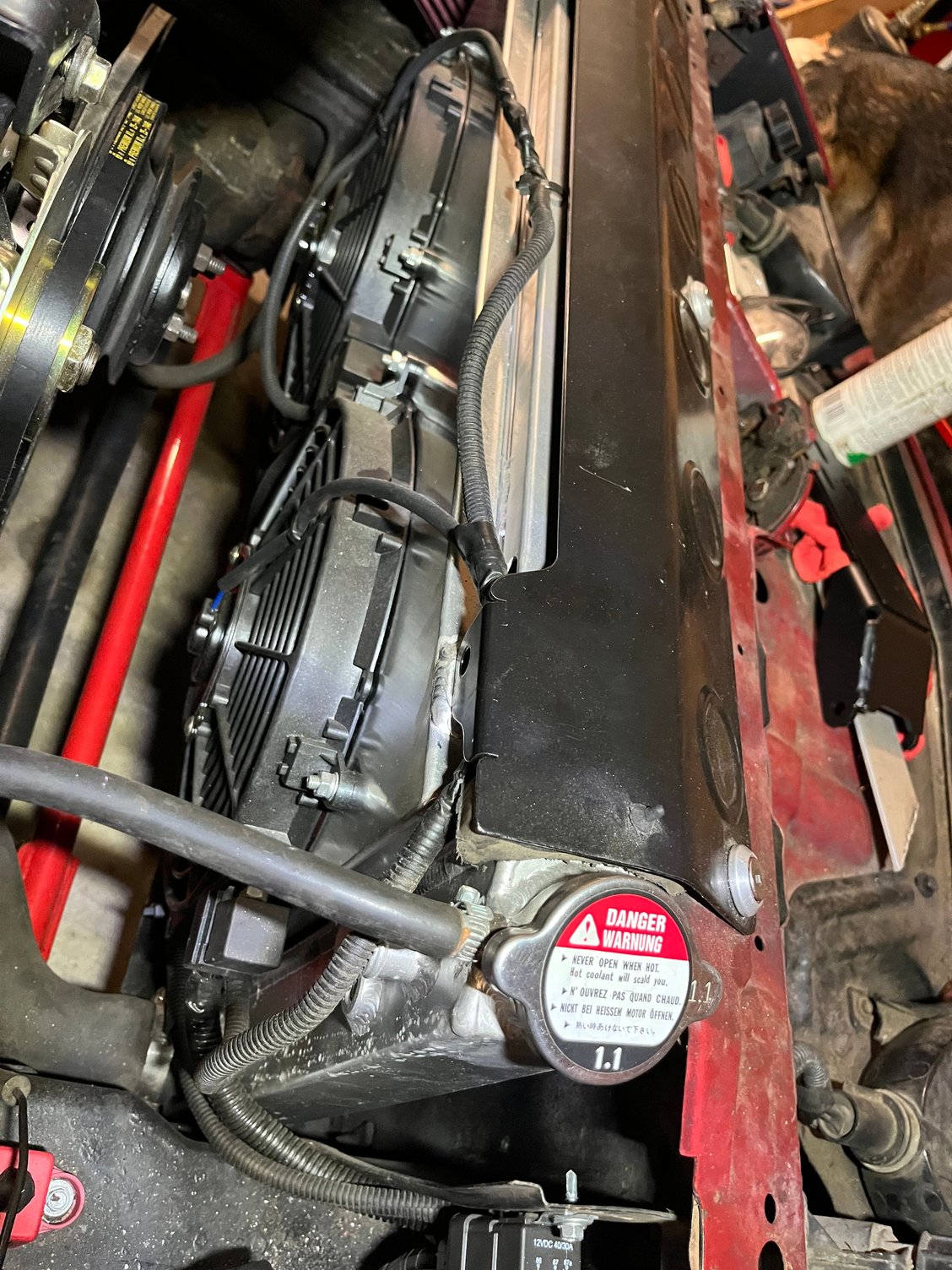

Re: New Aluminum Radiator Fan Shroud Fitmet
I used this w my 82. It required a little bending for my aluminum radiator but it was minimal. Drilled new holes in the upper support.
I used the black one, the paint is really good.

Originally Posted by Firechicken82
Thank you for the feedback and pictures. Nice work you did there thanks for sharing.

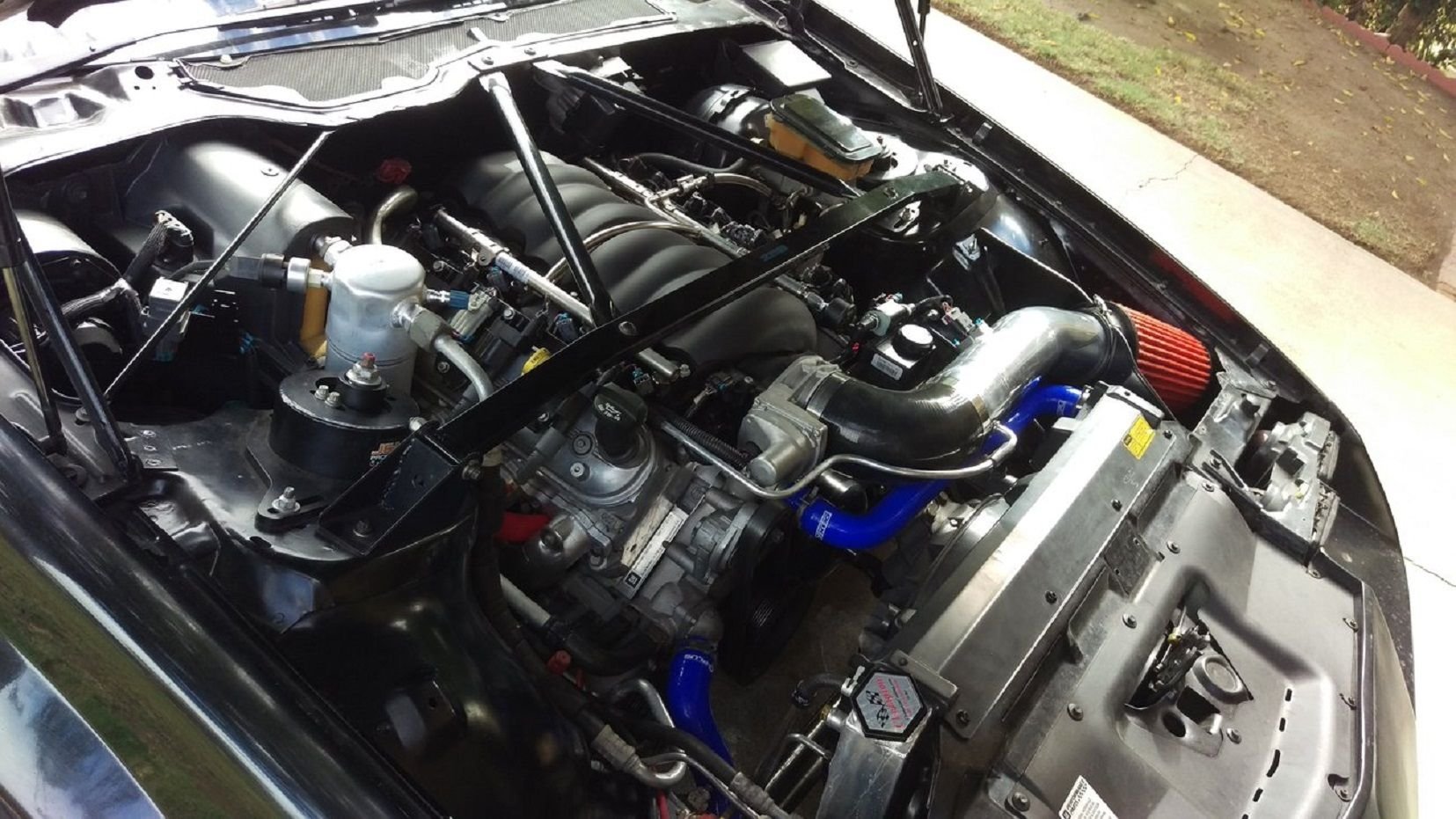

You can make the stock piece fit. You just have to trim it (some) and the rubber isolators not just the top/bottom, but also the ones between the rad/condenser. This is mine with a becool radiator on my 89 vert. Which also required rewelding the top isolator brackets farther back.
Here is the same shroud on my old 84z with a Champion radiator. No mods to radiator required.
