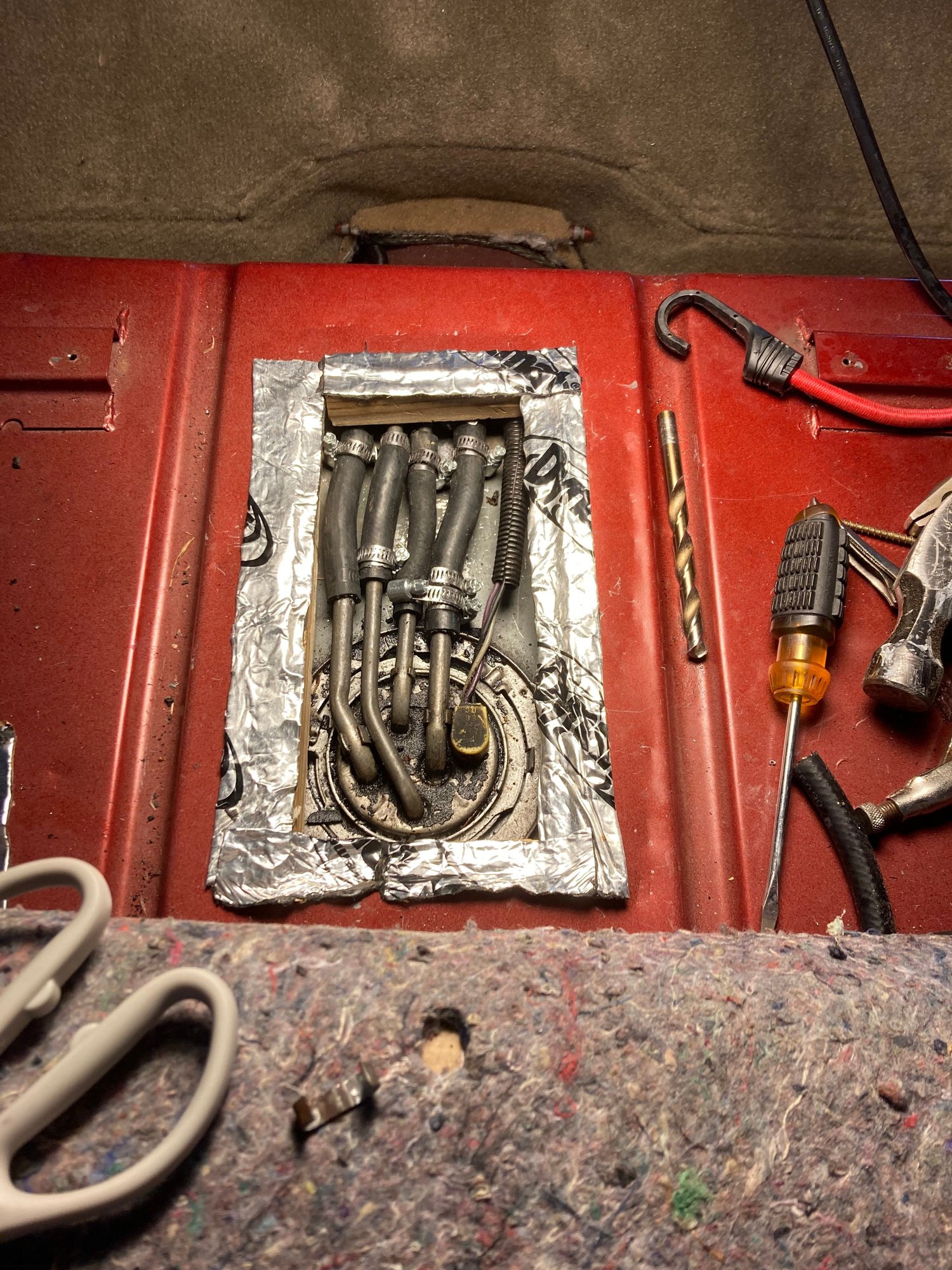

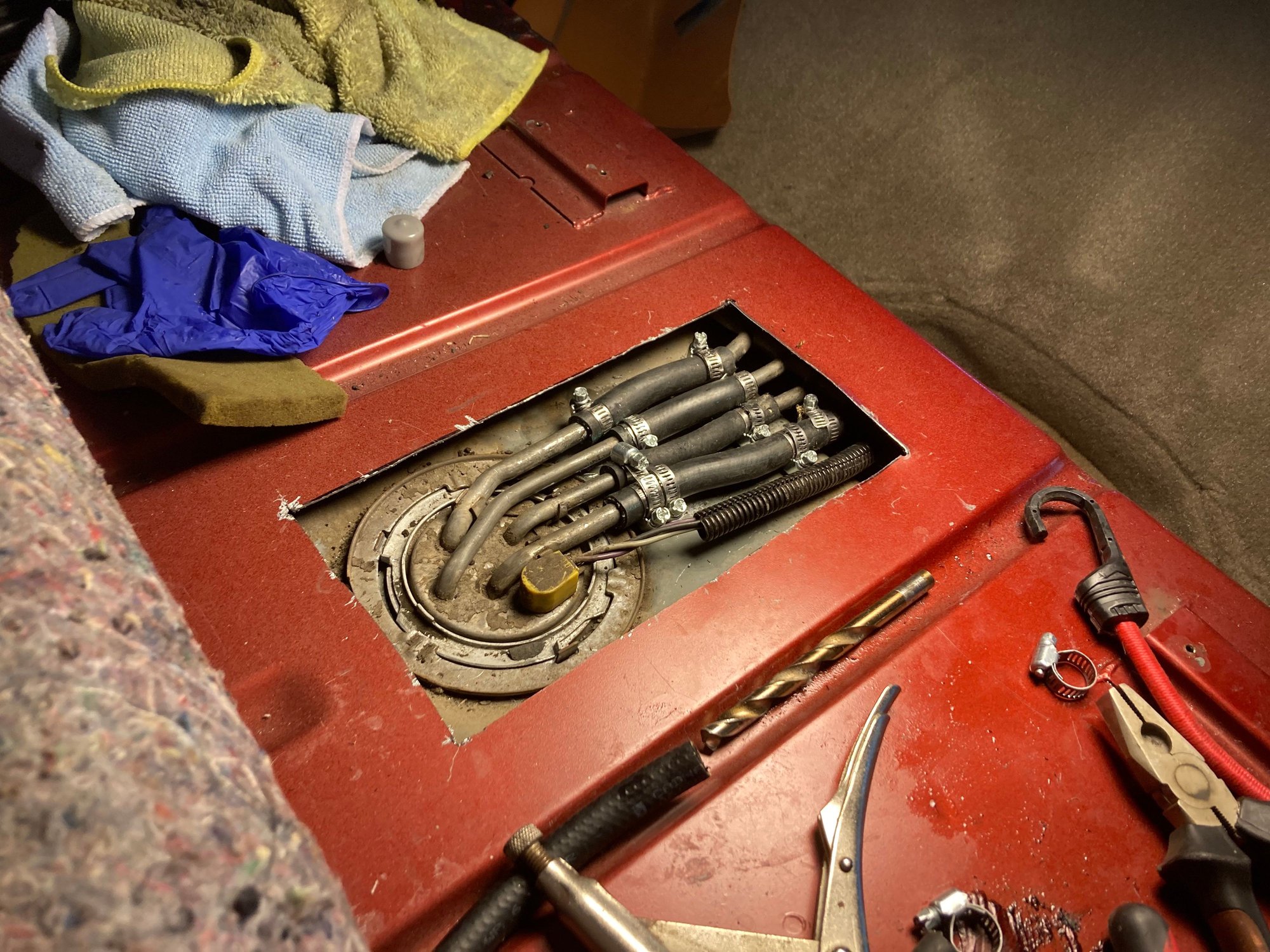

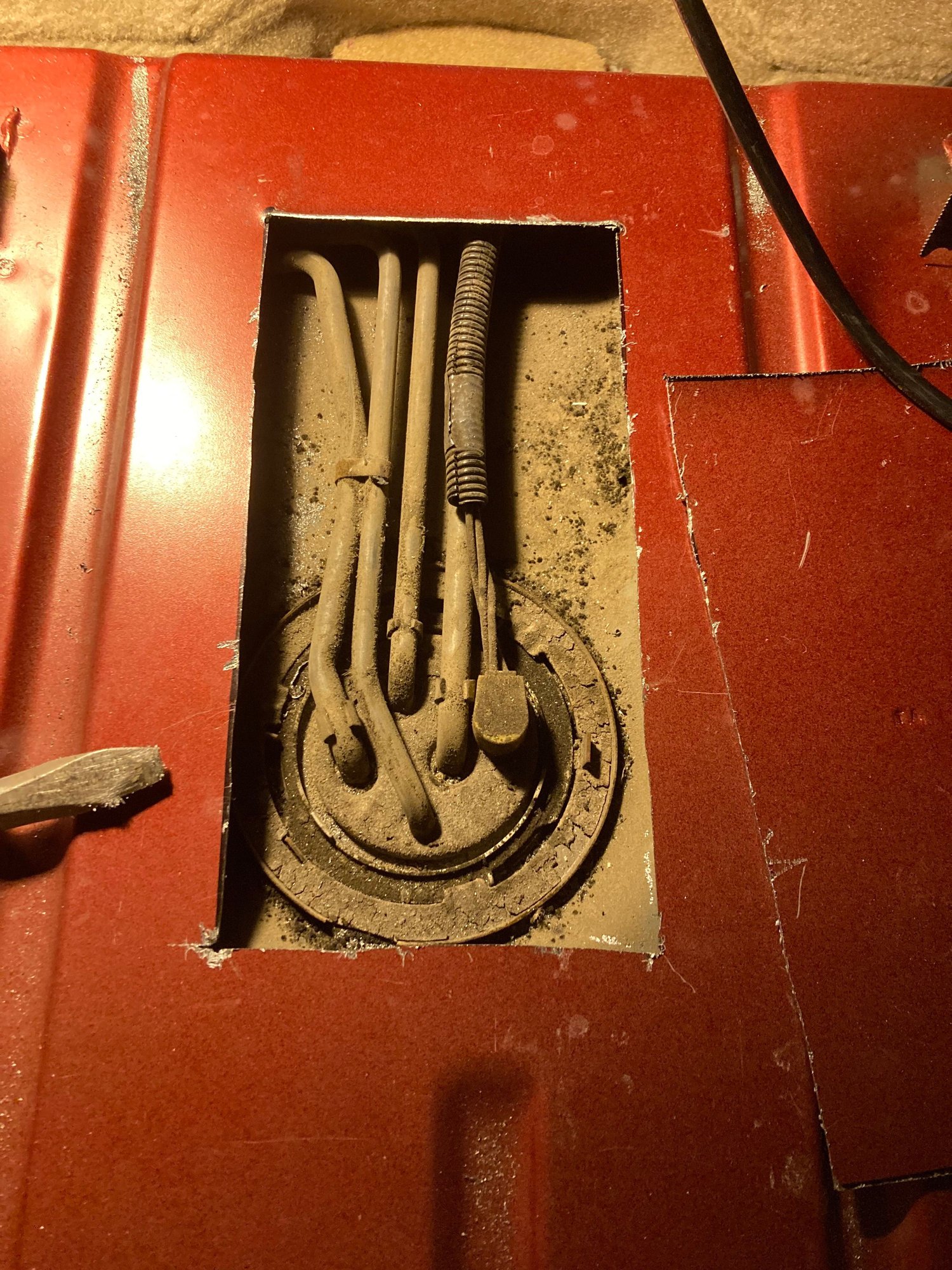

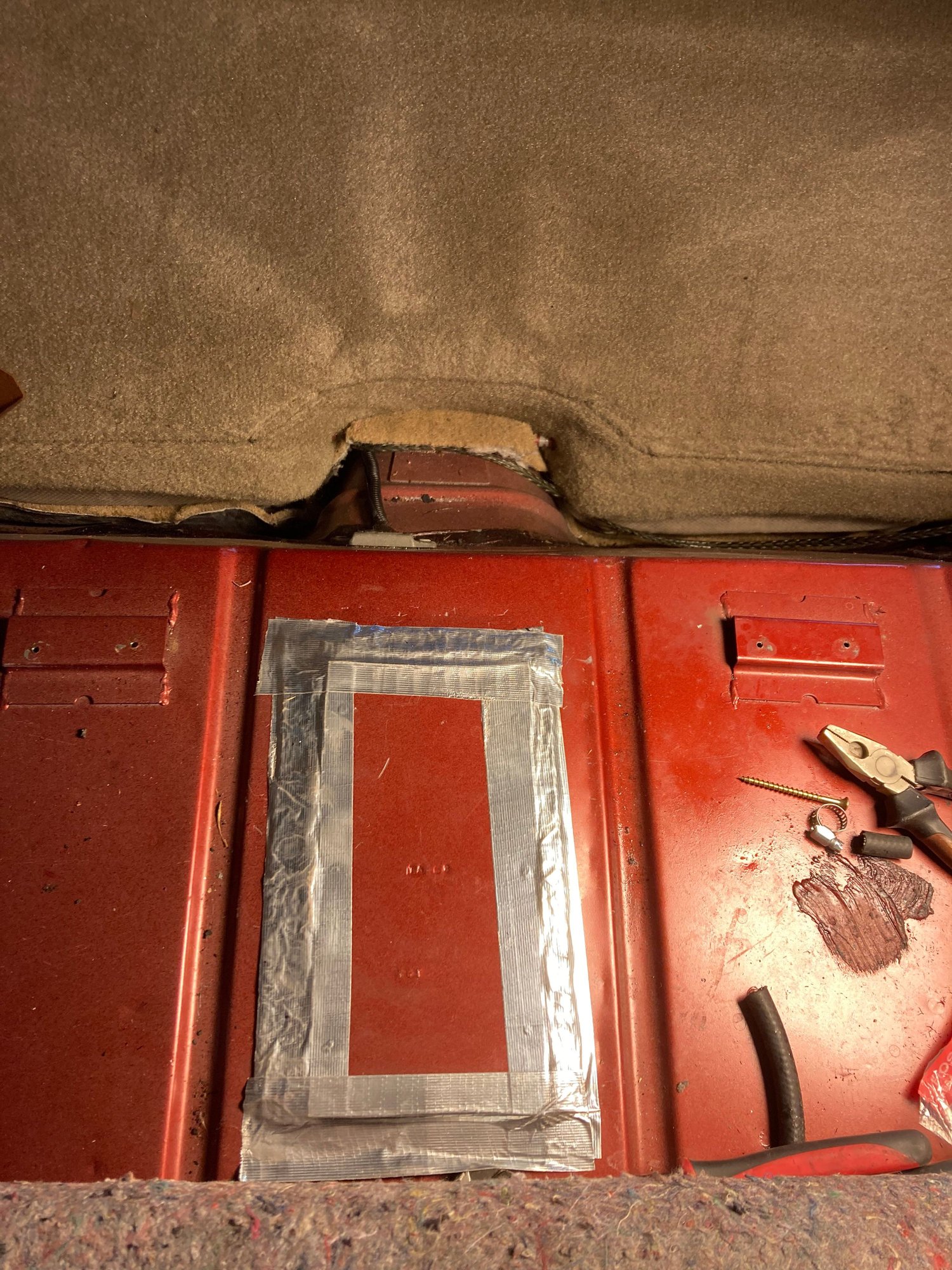

My fuel pump died, luckily it let me get it back home. Anyways we searched on youtube for how to replace the fuel pump, and did you know if you do it by the book, its like 4.5 hours profession mechanic labor and you have to remove your exhuast, and I think the rear axle, to be able to drop the fuel tank to access it. Then we found some vids on youtube on how to replace it the "easy" way and that was to cut a whole in the trunk area, which in our opinion was the way to go. And it makes for a much easier fuel pump replacement if we ever need to do it again. I'll try to share the youtube vid links and maybe some pics.

You should at least clean up and pretty up the hack job by installing one of these:
https://allstarperformance.com/searc...access%20panel

The bigger problem with what you've done there involves those pieces of hose and those sketchy worm clamps. I would hope that you at least put flares on the ends of all the metal lines. There's fuel under pressure there; a leak might not be readily discovered in such a hidden place and could be catastrophic.

I believe you're talking about putting a "bead" near the end of the tubing, not a "flare." With a bead, the hose would slide smoothly over the bead, and then the hose clamp would install on the back side of the bead.

Hole is cut on my car. No one will know the difference. Makes it much easier for repair/upgrades in the future. Quick diagnosis as well. Fuel pump is now a fifteen minute ordeal with basic hand tools. Just make a nice hatch/cover!
