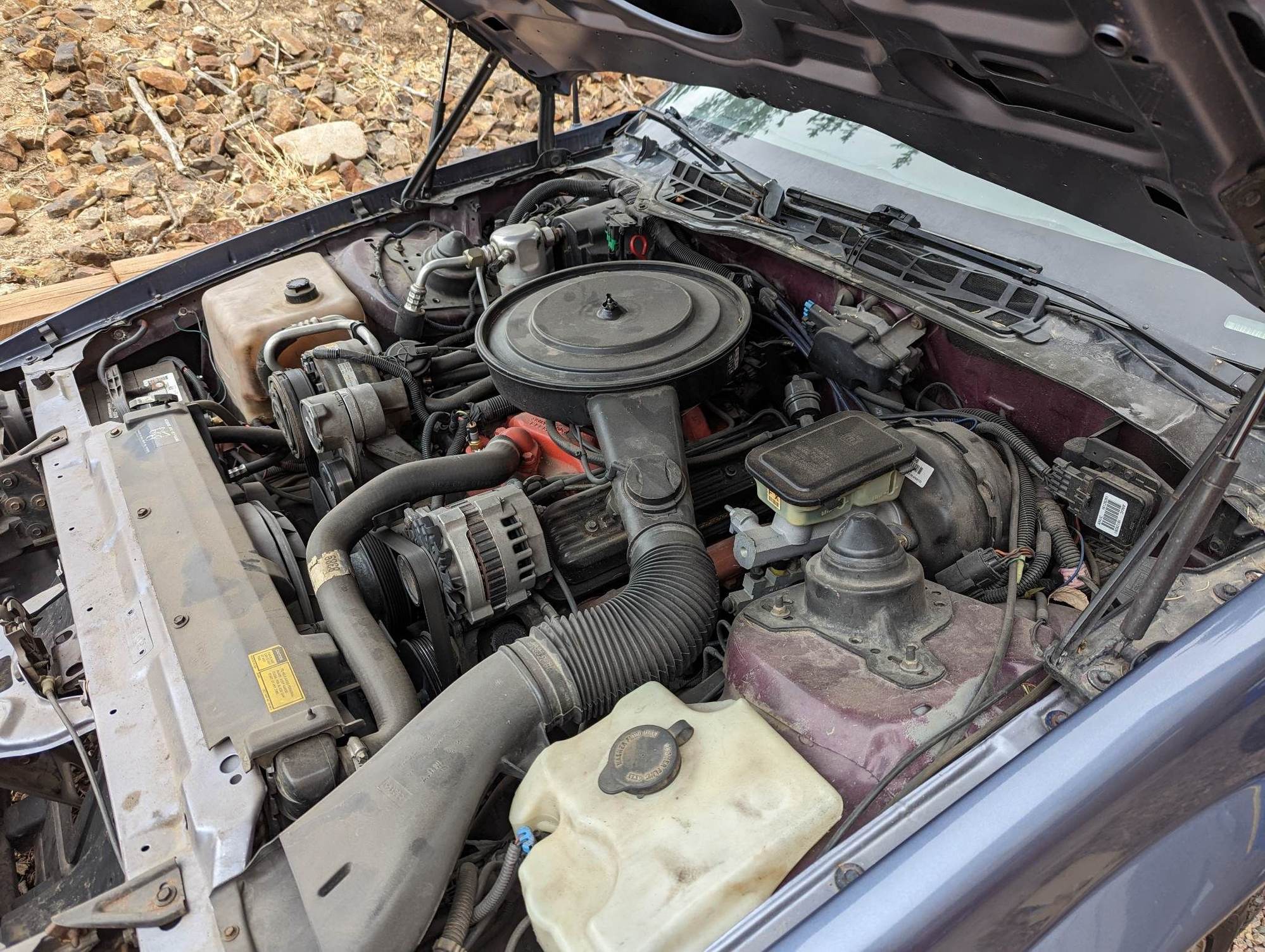

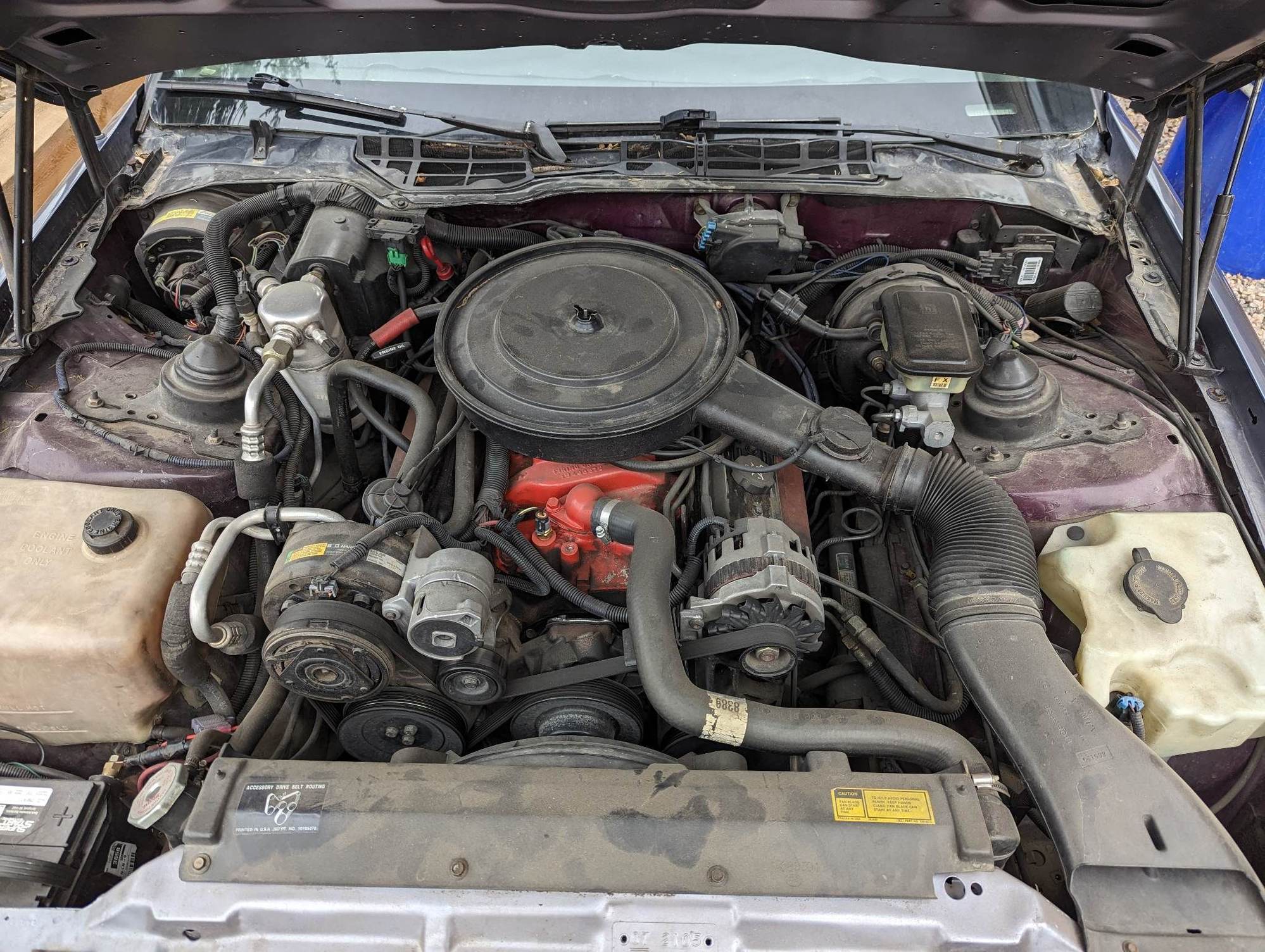

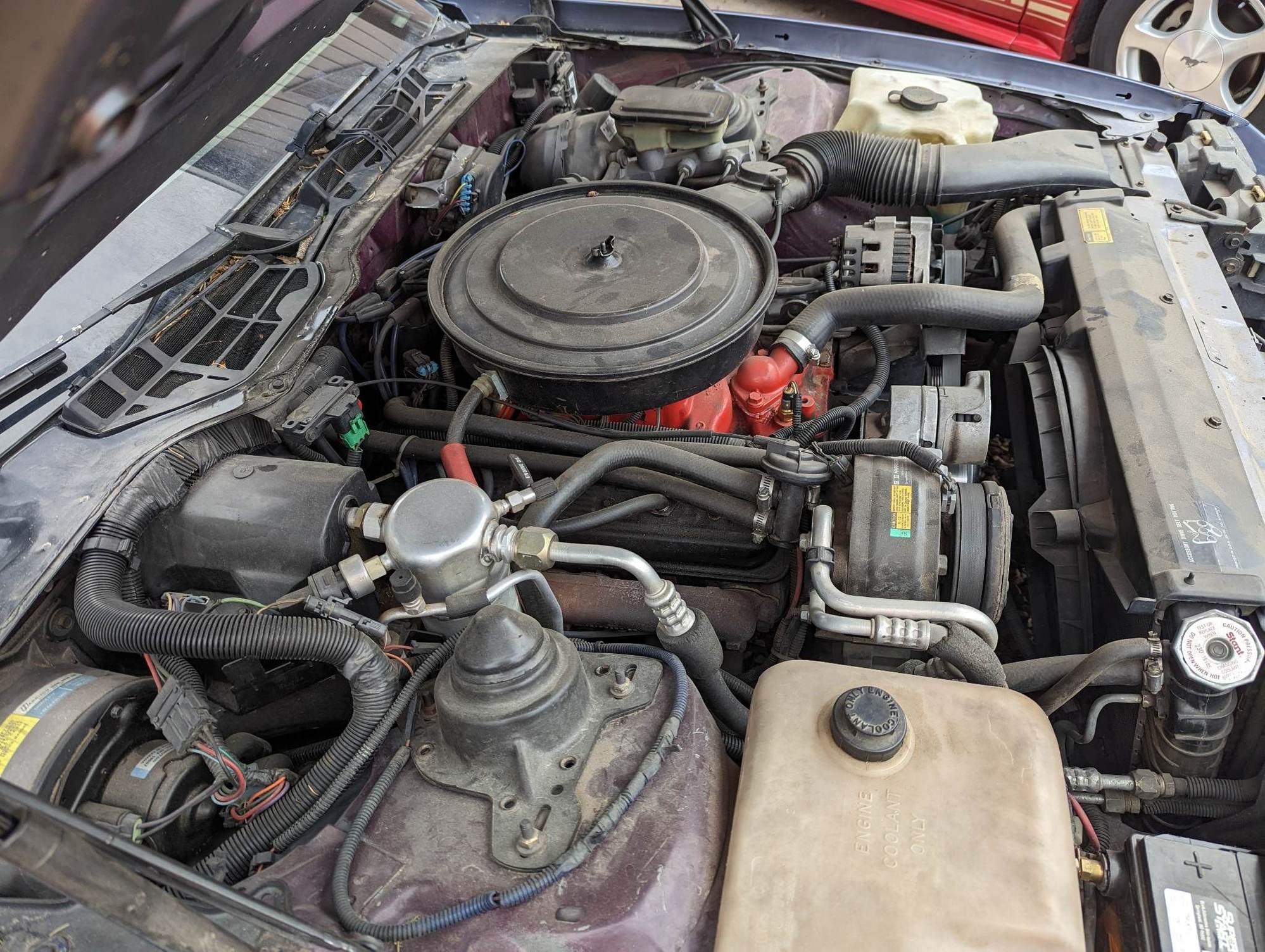

I bought a 1992 Chevy Camaro that has an engine swap previous owner said it was a 350 SBC in it so I've been trying to figure out where this engine that's in it came from so when I order parts I can get the right ones and I got the casting number off of the engine that sits right in front of the passenger side head (1M04206G35 was what was stamped) and I've tried a few websites designed to decode the (NastyZ/28.com, etc.) casting numbers but this doesn't seem to be on any of the sites or look like anything in any articles do you guys have any better ideas of how to figure it out maybe the way it sits in the car i cant really see the codes that sit on the bellhousing?

It's a Chevrolet small block.
Could be a 262.5, 265, 267, 283, 302, 305, 307, 327, 350, or 400.
It's orange.
Has 87-up heads on it. Can't tell what they are; if I was the guessing kind though, I'd probably guess that they're TBI of some sort (187, 191, 193 casting).
Looks like it has a TBI on it.
That's about all I can tell from those photos.

R U sure the engine has been swapped? It sure looks like it was a manifold swap or someone took it off and painted it. I didn't see that the block is orange. Everything else looks like the way it should be minus the smog pump air lines.

I am not 100% sure just going off of what the previous owner told me which probably isn't the best thing to do honestly but had to start somewhere I'm going to try and get the codes off of the bell housing because the one from the front doesn't seem to come back to anything I've seen anywhere

If it was your car's original engine, then the serial number in that location would begin with a letter, most likely the letter V, followed by 4 numbers indicating the month and day the engine was built, followed by three letters (the suffix) that would indicate the engine, model year and car. Also in that same location, stamped right below the serial number should be the 9-digit sequence of your car's VIN.
Clearly, your engine doesn't show anything like that, so it's not original to the car. It's been fitted with the appropriate 3rdgen engine parts, including exhaust manifold "logs," so it looks "factory," less the AIR system, but whatever it is, to discover its origin and build will require searching the internet. Other than that, the best you can do is confirm the size by looking at the back of the block behind the driver side cylinder head. If you can't see back there, then pull a valve cover to see what heads it has. But the heads would only help if they're correct for the engine, which you really won't know without confirming the size of the engine, and only you can do that.
Someone in the history forum recently posted about the same thing. The serial number he showed is very similar to the one you posted. But your model year and his are not even close, so it's not a model-year thing. Most likely, yours and his are crate engines.
