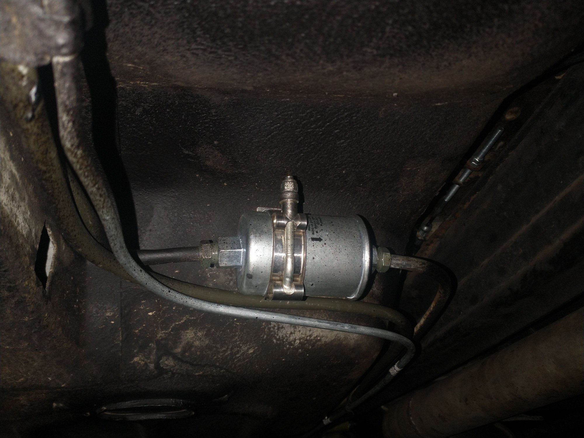

I put a stock TPI filter there for my sniper swap

Re: No fuel filter
Took a quick picture under my car it's starting to get dark out so hopefully it came out decent
