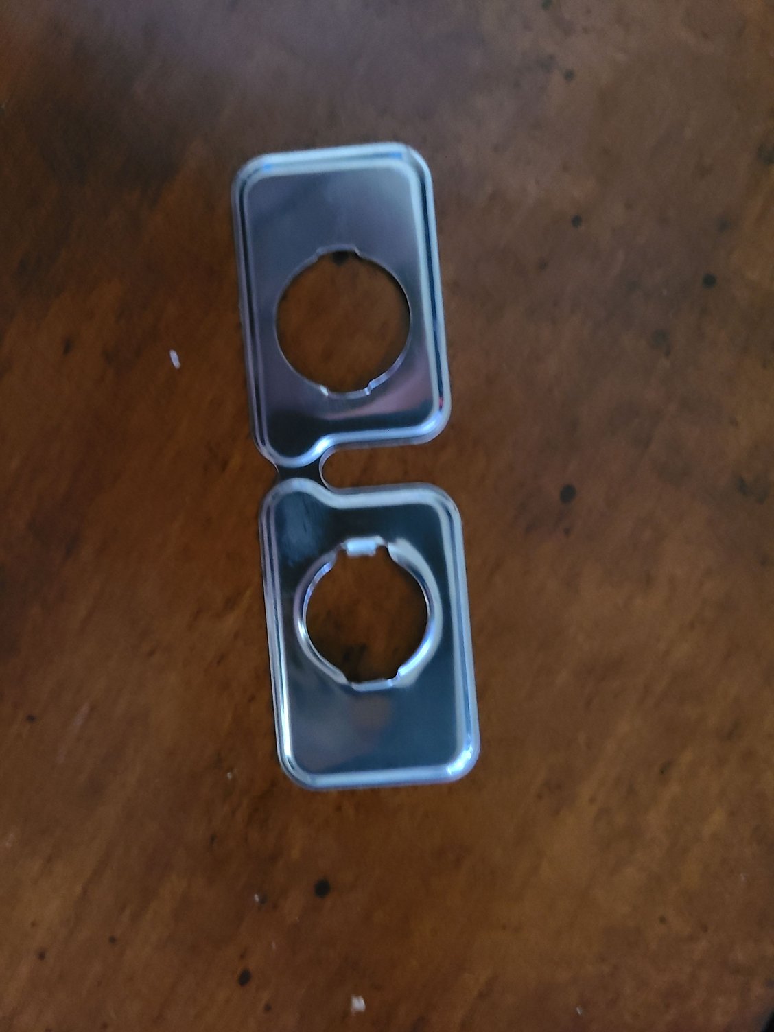

Can anybody please identify/explain the small tin squares with holes in them, shown in the center of the included image, that are often contained in intake manifold gasket sets?
Can anybody please identify/explain the small tin squares with holes in them shown in the center of the included image that are often contained in intake manifold gasket sets?

Other person: the small metal restrictors are ... restrictors. The passage they restrict goes underneath the plenum underneath the carb and carries exhaust from the pass side over to the driver's side. There's a valve called EFE (Early Fuel Evaporation) in the exhaust where the Y-pipe bolts to the pass side manifold which is closed off by vacuum when the coolant temp is below 120° or something, which forces exhaust to take that path. They should generally be installed. They didn't used to be detachable like that, some deep smogger setup in the mid 70s must have wanted that part of the intake REAL hot, and they started coming that way instead of permanently part of the gasket ion around 1980 if memory serves, and now we're stuck with it.

Thank you sofakingdom/Other person.
