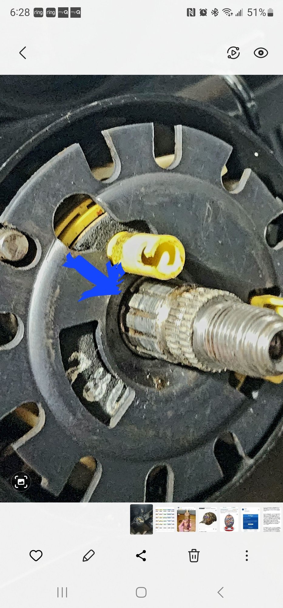

Removing steering plate
How do I remove the plate on the steering column? It looks like there might be a retaining ring there but there are no holes to use to the plyers on it just curves in..

Re: Removing steering plate
Push in the large lock plate that it retains (there's a spring behind the plate holding it out against the ring); pry it out with acoupla small screwdrivers or the like. Piece o cake. Only takes about 4 or 5 hands. A "lock plate depressor" tool makes it easier: you can make that yourself; looks like a U-shaped piece of metal with a hole in the middle, a threaded rod with a smaller threaded section on the end to thread into the hole in the center of the shaft, and a nut that screws down along the upper portion of the screw, to push the U against the lock plate. But it can be done by hand, by a single person even, if need be. I've done it more times than I care to admit to more cars than I care to admit.
Be REAL CAREFUL with the little white plastic thing, it's REAL EEEEZY to break off. That's the horn contact.
I inherited an OTC 7815. The arbor that screws on the steering shaft is tapered. Makes putting the wire retaining ring back in place like installing valve stem seals. Makes it easier for us guys with 10 thumbs.
