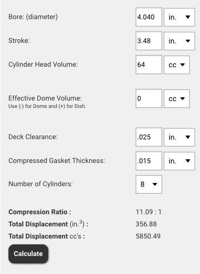

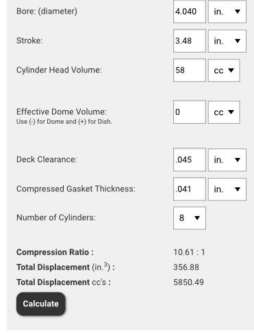

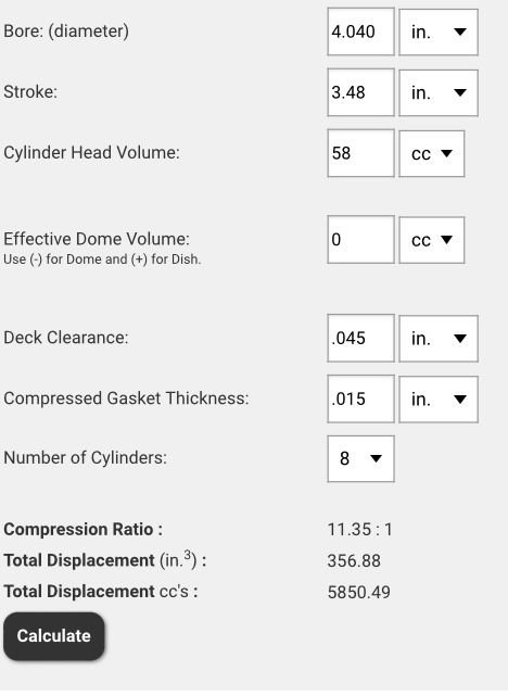

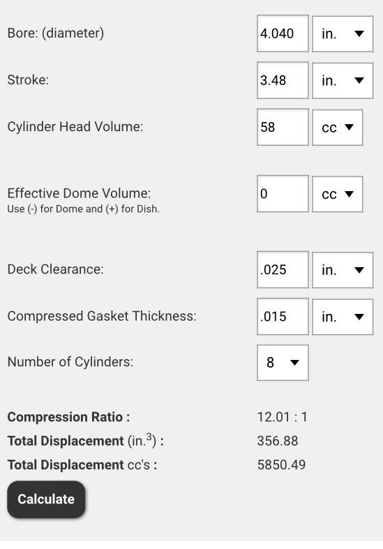

Hi yall so Im rebuilding a 350 and its bored .040 over, stock stroke, and the heads that came with it originally are World cast iron 58ccs off a 305. I thought they would be fine cuz Ive heard 305 heads increase the low end power of 350s. I tried putting all the info into Summits compression calculator and it seems like theres really no way to get the compression to 10, its always 10.5-12 even with .045 deck clearance and a .041 gasket. Unfortunately the engine is at the machine shop getting the bottom end put together so I cant really measure the deck clearance rn, but Im guessing its in the range of .025 to .045. It seems like the only way to make these heads work would be if they were 64cc or higher, but Im just curious if theres any way I can use em cuz I already paid for a valve job and seals on em? I havent really rebuilt an engine before so Im just not sure. Thanks!

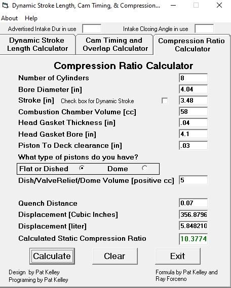

As pointed out, you'll have to measure that deck to be sure. Piston cc (valve relief volume) and piston compression height (distance from the pin centreline to the piston top) will play a part too. Some "jobber" style pistons have a lower compression height in the anticipation that the block will get decked. If you have that style of piston then they could be way down the bore. Does the piston have part number stamped into the top?
That said, one of my stock 350's, once refitted with a Speed-Pro piston with a 1.560" compression height, was anywhere from .030" to .036" down.
If you take that example, and run it through a calculator using an .040 x 4.100" gasket:
That's 10.37:1. I made a few assumptions as you can see.
FWIW, that's where I'm at with my iron headed 357 and I consider that about the upper limit given my cam spec and application.
Something to keep in mind with the heads you have is that the combustion chamber might only be the diameter of the 305 (+/-). At 3.736", this means that there should be lots of material that you could remove to bring it to a 4.040" bore. That'll remove a few cc's from the heads and get that compression down. This is something you can still do even after the valve job. You'd need to take the necessary precautions to protect the seats. If you're not comfortable doing that, I'll bet a performance shop could make short of it for not too many dollars.
That may or may not be the case for you but it's worth investigating I would think. Seeing as you already have all these parts it may pay off with a little extra work.
