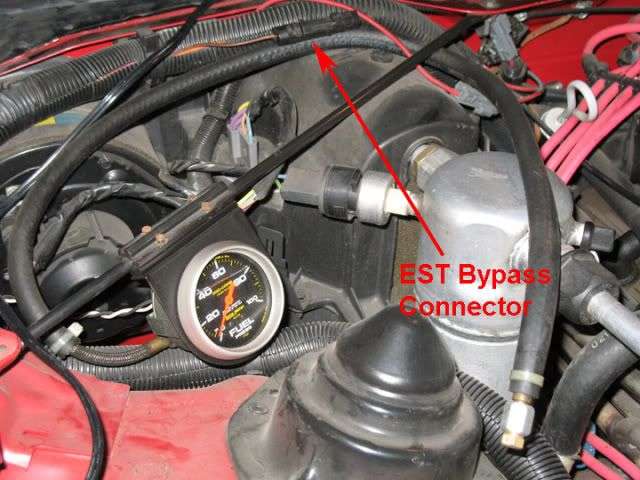

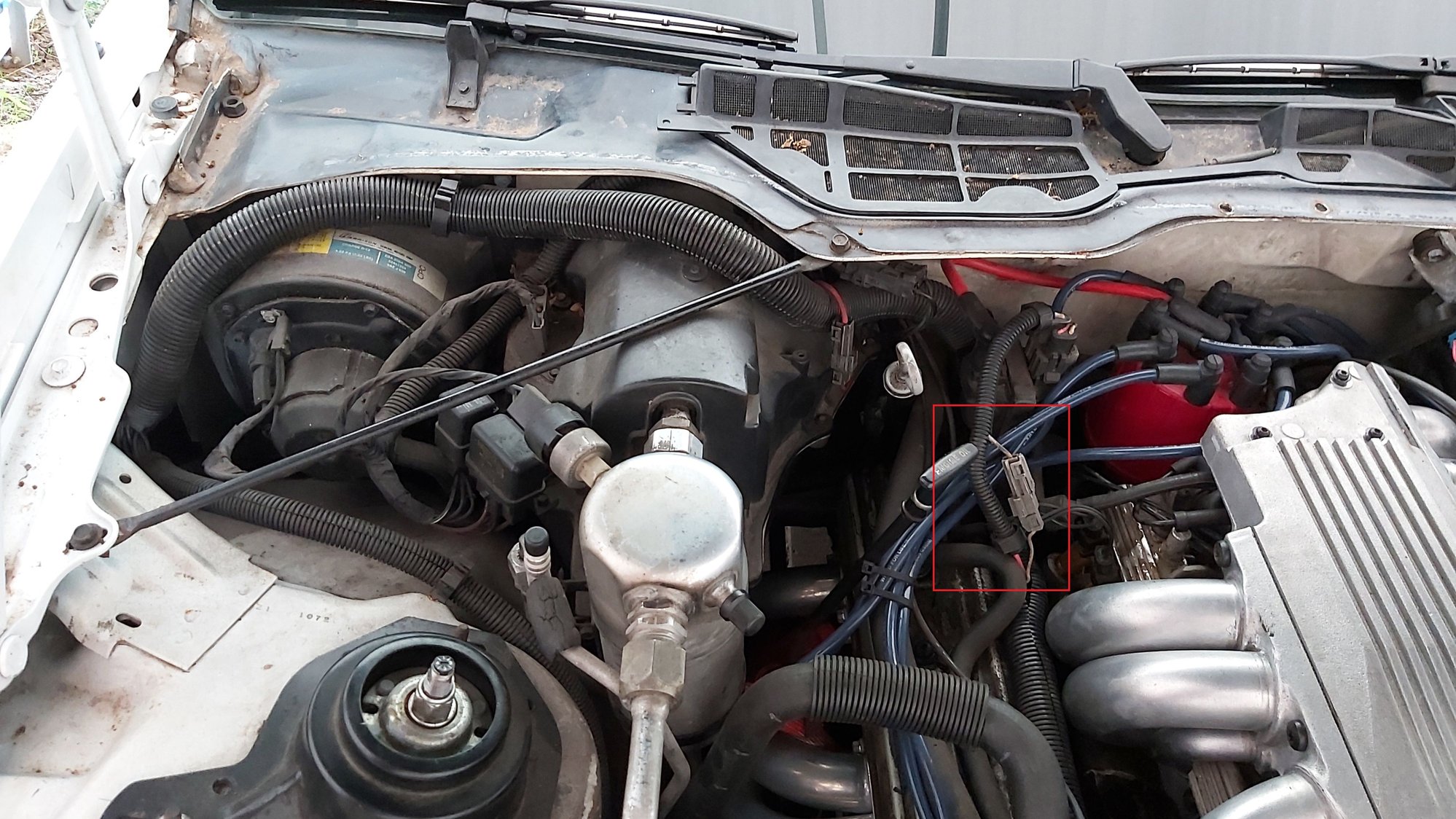

Regarding the EST bypass connection, is it the connection I outlined in the image below?

Regarding the EST connector, the one you highlighted is for the tach I believe. Hard to see. The wire should be tan with a black stripe. Located closer to the heater box on the passenger side. Very well could be hidden in the wiring loom still.
