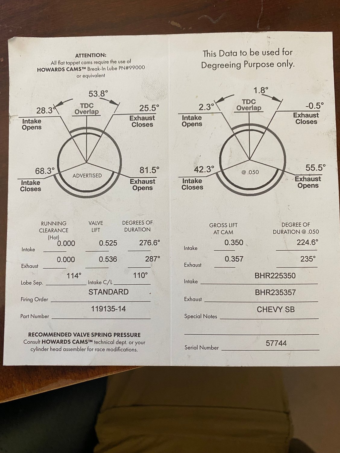

Hello all. 1988 Formula 350, bored 30 over, Howards cam (card pic attached), new injectors, new fuel pump (43 psi at rail ) 083 heads redone. Timing at 6 degrees BTDC. After i got it built it would start and run no problem. Now just cranks sort of tries to fire but not quite. A small shot of starting fluid into the TB and it fires instantly but i have to open the throttle a bit to keep it from running. The CSI is in but not wired. cant find the wires to it in the harness. Also occasionally throws a 34 code. I have searched extensively on this but no avail. Any chance you guys have any ideas?
Thanks in advance!
