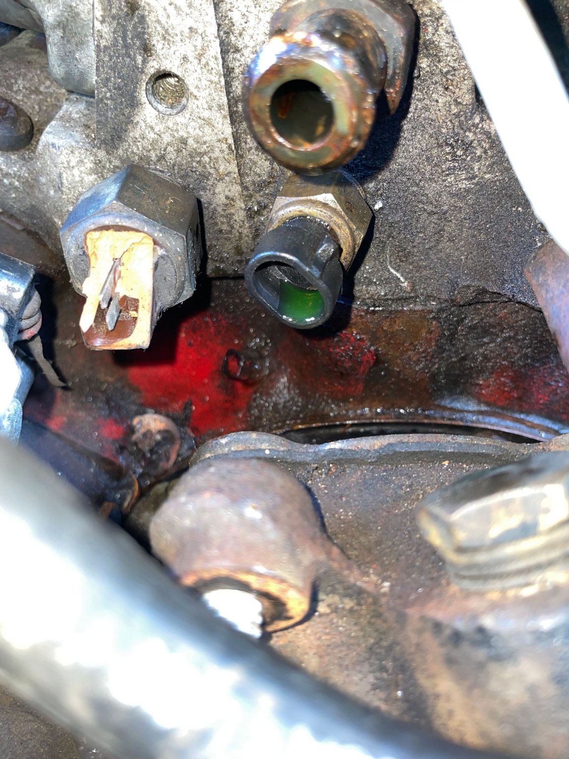

Sensor next to coolant sensor ??????
I was trying to change my coolant sensor and broke this sensor next to it not sure what it is , would love some help identifying so I can get a replacement … thanks

Re: Sensor next to coolant sensor ??????
Cold start injector timer switch , nla have to find a used one
gm 14084318
