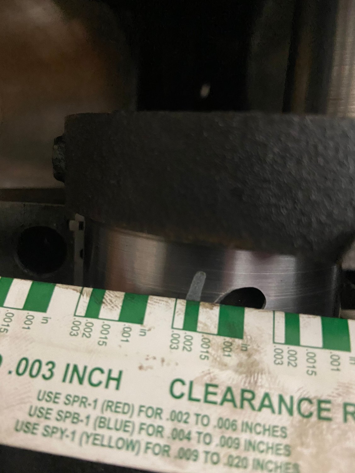

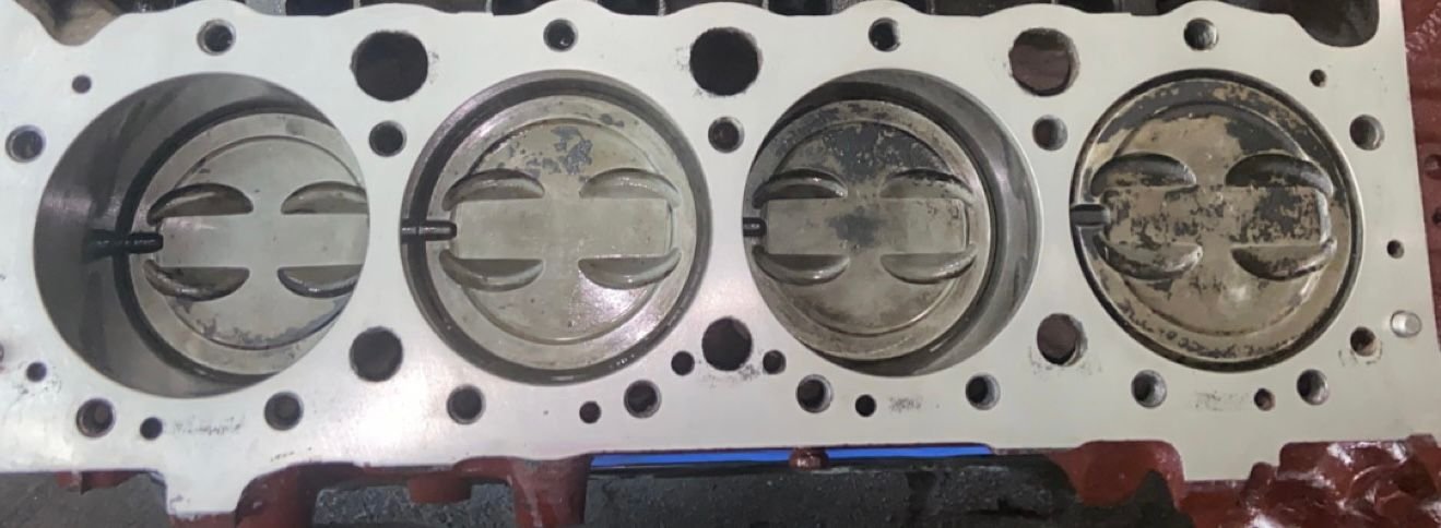

Rebuilding a 94 one piece rear main seal chevy 350. I now have the heads on (plugs out) and its taking a great deal of force to turn over. Ive installed new main, rod and cam bearings and piston rings and all covered with assembly lube. With just the crank and cam in, no chain, i could turn both with the push of a finger. All my main and rod bearing clearances measured in at .002, perfect for rod and .0005 tighter than spec for mains but still good enough to run 5W30. Installed my pistons (rings gapped between .018-.020 and got noticeably tighter after each one which i know is normal and had coated the pistons and walls with 5W30, not assembly lube. Still was able to turn it and i know resistance is normal since the rings are new. Then double checked piston and cap orientation and everything is correct. Finally installed the heads, oil pan and rear main
and go to set the valve lash and i feel like im going to break a bolt off the stand trying to turn it with a pry bar, any ideas?
