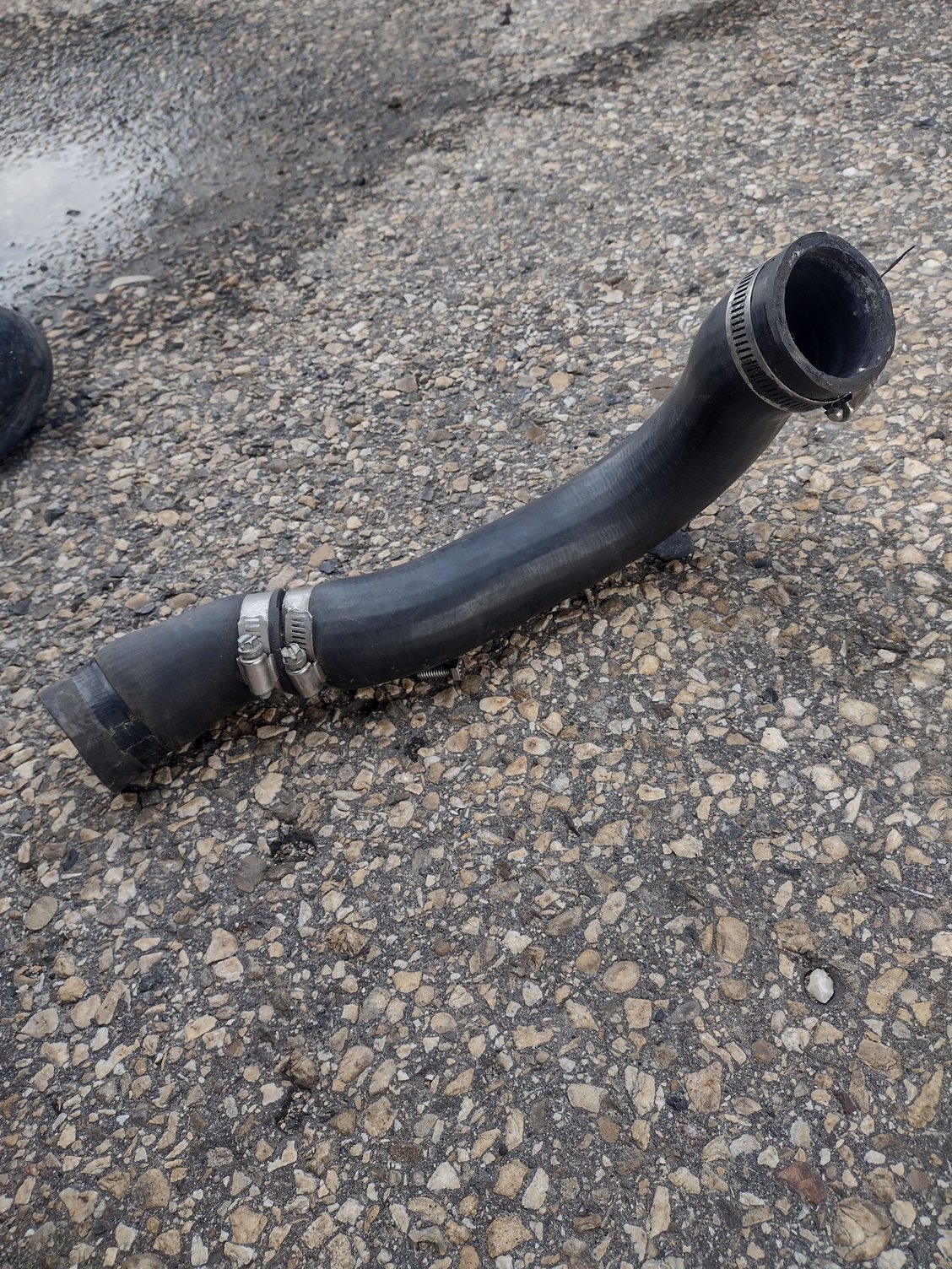

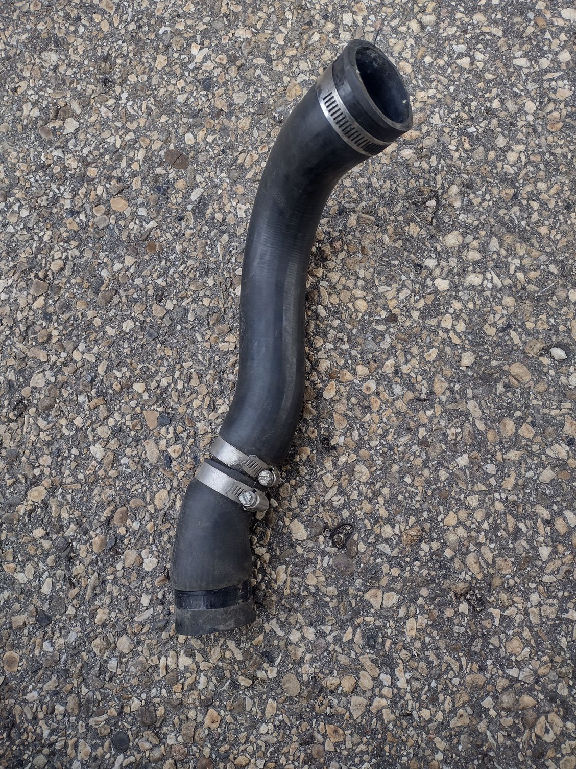

Old Sep 20, 2023 | 03:09 PM
skinny z's Avatar
Joined: Dec 2005
Posts: 9,931
Likes: 892
From: 53.0907° N, 113.4695° W
Re: Lower Rad Hose: 1-3/4" In and Out
My spliced lower rad hose.
