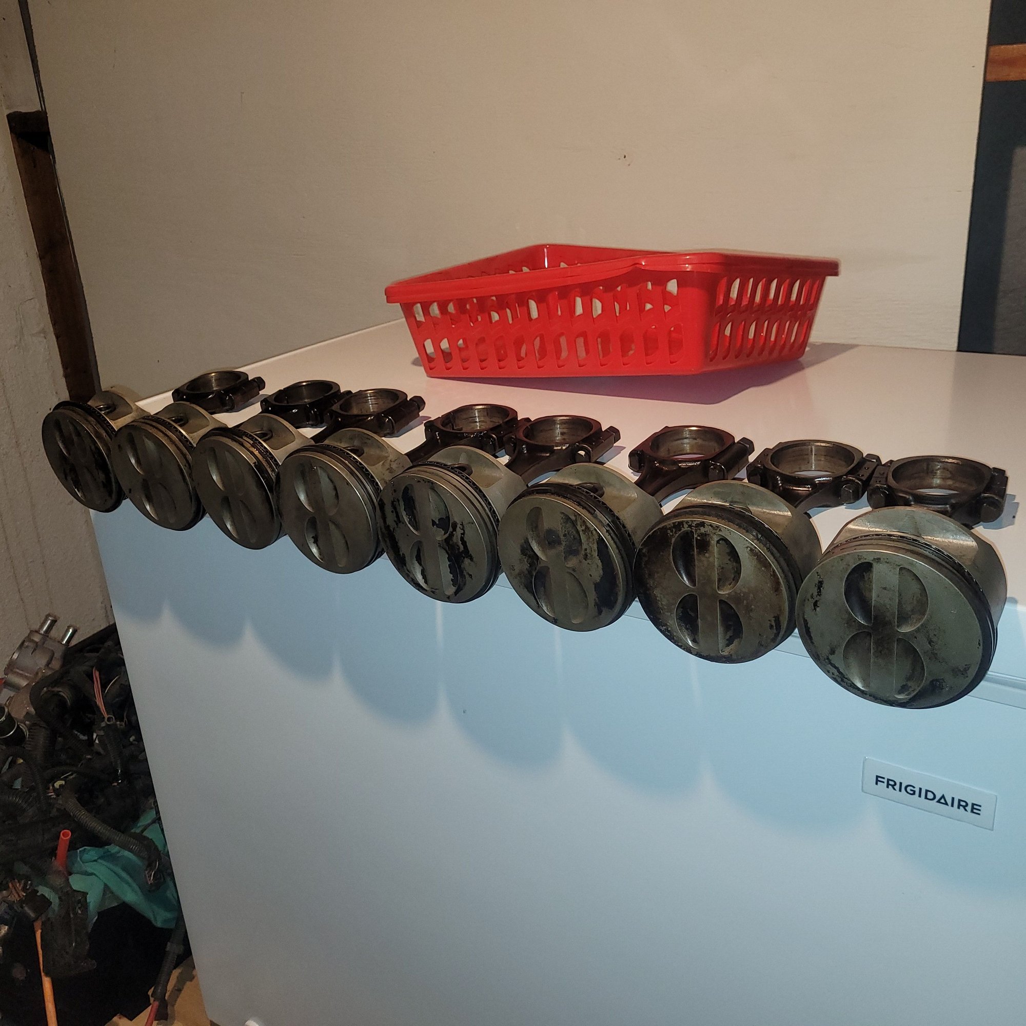

So I've searched the internet and forums and can't yet find a crystal clear answer (apologies if its been addressed before, like I said, just want a crystal clear answer):
I have a set of stock LT1 pistons from a 95 Firebird. Is there any reason at all these pistons (which look fine btw) will NOT work in a '86-up SBC 350?. Obviously, with new rings and bearings and stuff, but with everything else staying the same with a standard 350 block, will there be any issues running these pistons?

I know of no reason that they won't work.
