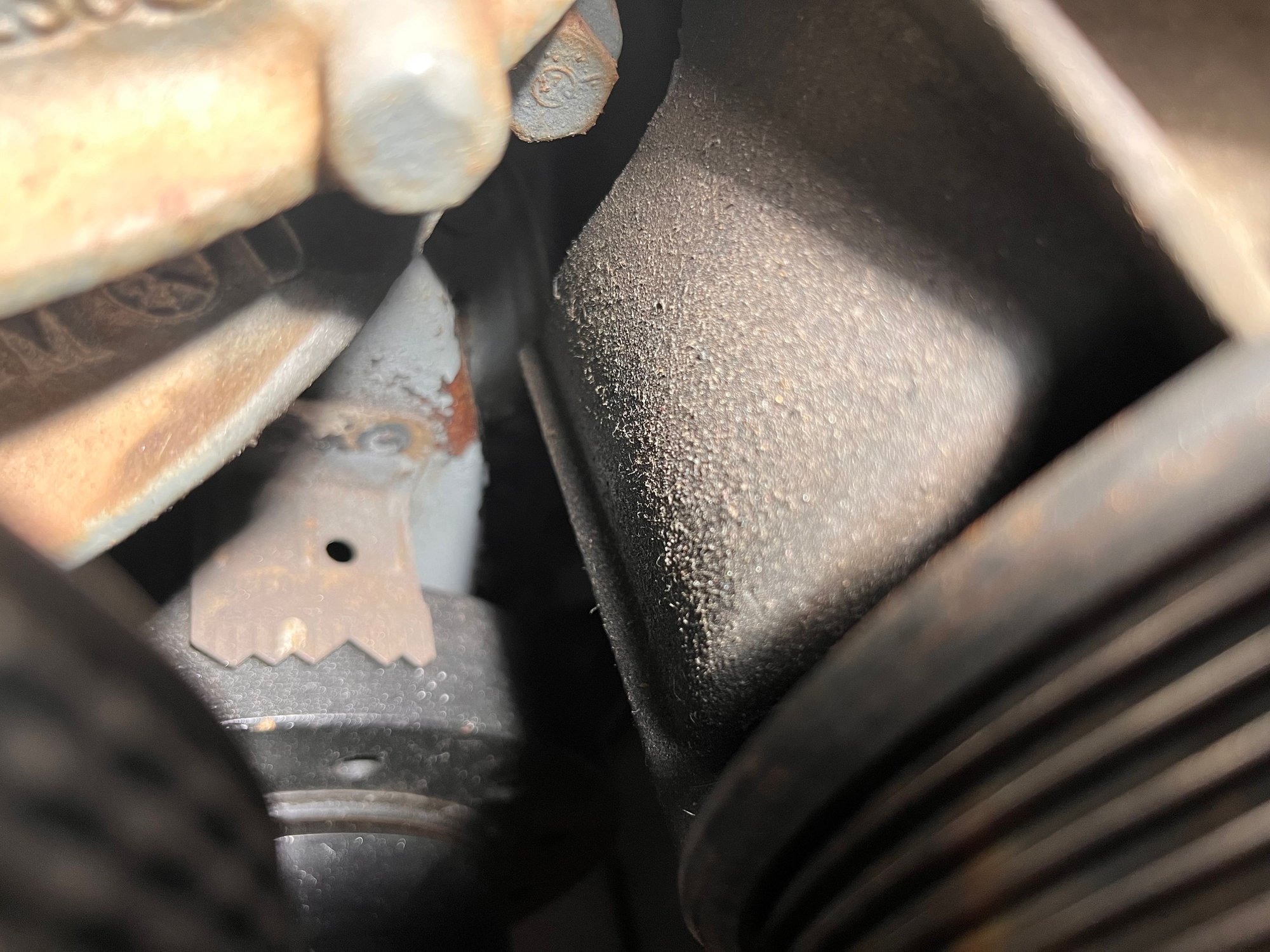

This car is in very good shape, bone stock, and there is no indication the timing gauge has moved. It's on the front of the engine and it remains firmly attached. See photo. Seems like the probable answer to "is the base timing right" is "yes" although that can't be 100% definitely or independently verified. Nonetheless, in the interest of time, if the engine runs well at idle and all RPMs, except 1,850-1,900, what is now the most likely culprit--EGR? Will finding out that the base timing is actually 4 or 8 degrees BTDC, which is changed when the EST is hooked up, change the fix? Or the tap tap tap? If so, can you explain how? Just trying to get some help on fixing this from anyone who has dealt with this before. Thanks.
Timing mark on front of original LB9, circa 1990 (made in 1989).

The thing that moves is not the "tab", which is reasonably securely welded to the timing cover. It's the MARK, on the crank damper.
If it has moved by the outer inertia ring separating from, or even tearing, the rubber that glues it to the hub (you can see the rubber spooge in your last pic) then the mark no longer tells the truth. No matter how pretty the aftermarket timing tape is.
Can't comment about the tapping; butt if the timing isn't what you think it is, or worse yet if it's sufficiently wrong regardless of any "think", the motor isn't going to run right.

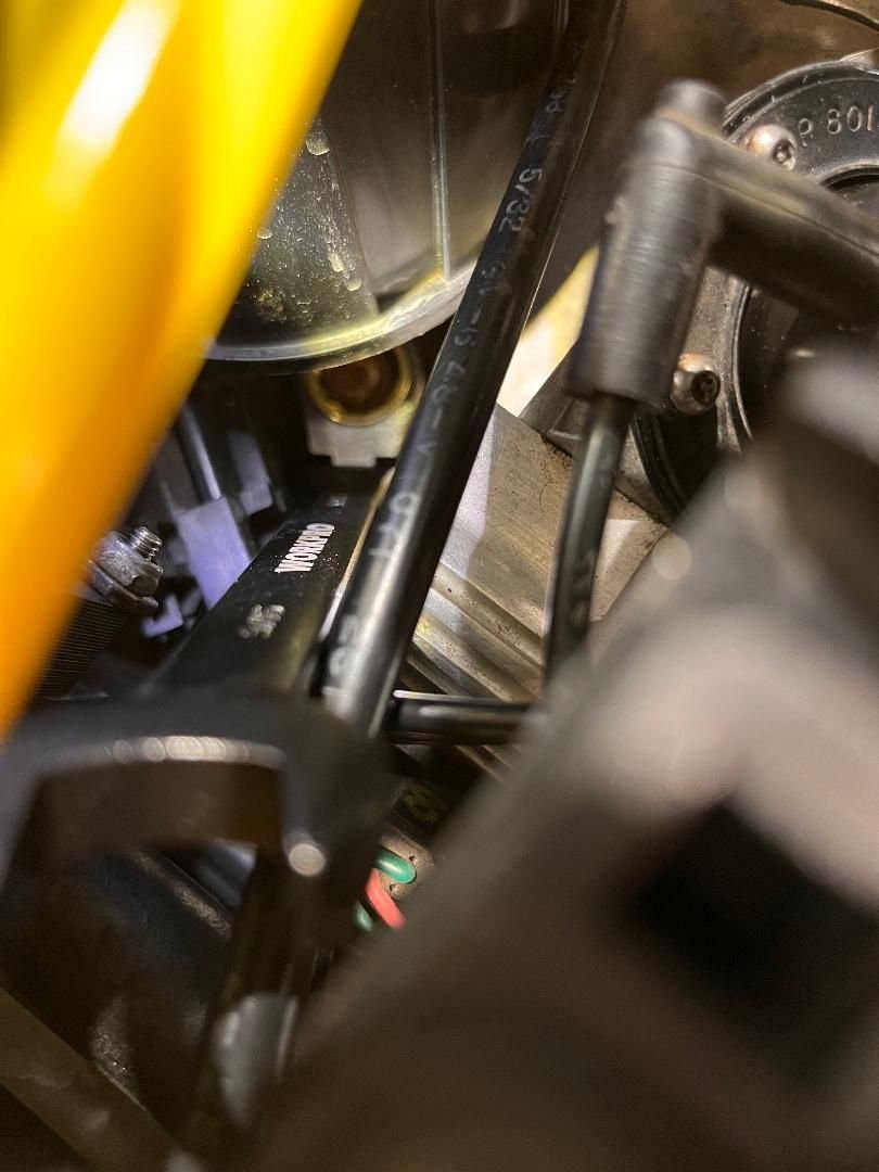

I had to remove the MAP sensor, located right above the Schrader valve, just to attach the fuel pressure gauge. I was afraid to start the engine without the MAP sensor connected. I've tried to find and bought an -4AN adapter to the Schrader valve, but so far have found nothing that will fit in this tight space. I need a 90 degree connection that will swivel, but can't find one. This engine is not easy to work on.

Thank you for all the information @sofakingdom. I appreciate your help.
I tried using a racheting wrench with flexible end, as shown in the photo here (sorry it's a little fuzzy). This is the first tool I could actually get on the hold-down bolt, but because of the EGR solenoid and coil, on 1 side, and the fuel rail, on the other side, I can't move the wrench unless I take the coil and EGR solenoid off. Only other thing I could think to use is a crow's foot wrench with long extension. I guess I'll buy one of those. I wonder if, because this is a 1990 (which seems to be more jammed up with stuff than some prior years) it is harder to get at? Do I just have to disassemble to adjust it?
Old Jan 28, 2024 | 11:02 AM
Posts: 28,025
Likes: 2,497
Re: Bucking / Jerking & Fuel Trim Questions
More likely the problem is simply that it was overtightened.
Yes as time went on and various devices were added or changed, it got harder to access things that are buried deep. However these things are often very easy to remove for long enough to do what you have to do. The EGR solenoid for example is help on by only one small bolt, and will work fine unbolted as long as its frame is grounded to the engine (alligator clip lead such as https://www.harborfreight.com/18-inc...ads-66717.html for example). But, once you've got it broken loose, you don't need to re-tighten it in gorilla mode; 12 ft-lbs or so is plenty to hold it still. In fact, if you experiment with the tightness a little, you can find where it's just barely tight enough to mostly hold still but you still just barely turn the dist by hand, such as to allow adjustment; once you find that point of tightness, just tighten it a little bit more, and voilą! you've found the "enough but not too much" level.
