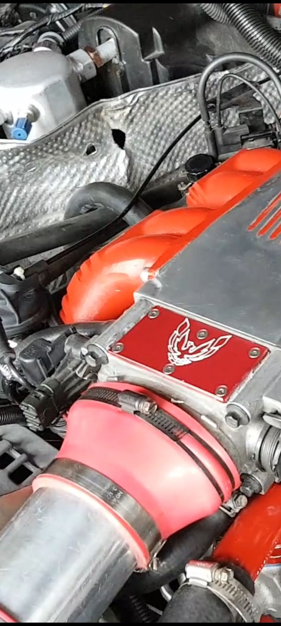

I'm sure many of you have had the problem where headers wind up melting the black plastic compressor box on the passenger firewall side of car. I constantly get smoke as it's heated up. Have any of you found a good solution to stopping this?

I have a piece of miscellaneous exhaust heat shield jammed between my header and that box

I used some DEI heat tape on the lower portion of the evap case.

That's a great idea. I run AC in my car so that shield I covers the dryer as well. Basically helps keep the heat down on everything on the passenger side. Including the MSD box mounted to the passenger side strut tower

Stainless headers w/ ceramic coating here.

I'm using coated hedders that are also wrapped but still to much heat for plastic that close

Stainless steel conducts only about 40% as much heat as typical carbon steel. IOW a bit over twice as much resistance to the passage of heat. Which is why I posted
Both of those factors - the material AND the coating - are significant.

I have the regular edelbrock TES headers. The heat was incredible. I ended up have them ceramic coated by Fireball. That alone made a big difference and they aren't stainless headers.

Yup, the coating is AWESOME in that regard.
I would equate - ROUGHLY - the difference that coating carbon-steel headers makes, to the difference that stainless makes over carbon steel.
The 2 together make headers a source of little more underhood heat than manifolds.
