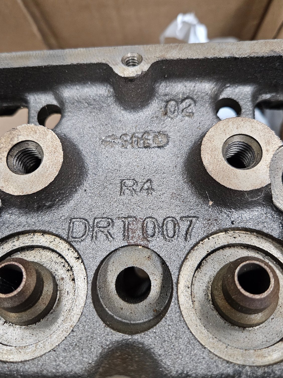

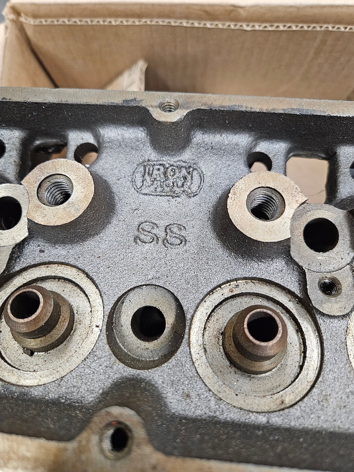

What are these heads?
I picked these heads up from a retired racer who was selling off all his stuff. He said he got them at a swap meet some years ago and never used them. He thought they were 72cc from the research he had done. I just cc'd them and I'm measuring 64cc but all of the iron eagles I can find are either 67, 72 or 76. Here's what I do know. They are 1.94/1.5 valves, I'm assuming 165 to 170 intake ports, perimeter or center bolt valve covers and it looks like standard pre 87 intake bolt pattern. Just trying to figure out what I got because I'd really like to use them on my current build. They have never been installed/ran or even had the seats ground and they are in mint condition. I've heard the iron eagles port very well. Shooting for 400hp if they'll work out for me.

Dart Iron Eagles.
Popular in classes of racing where iron heads are required.
https://www.summitracing.com/search/...cylinder-heads
Old Nov 22, 2023 | 10:21 PM
Vader's Avatar
Posts: 19,679
Likes: 316
Re: What are these heads?
...And will accept larger valves than aluminum heads unless seat inserts are used.
