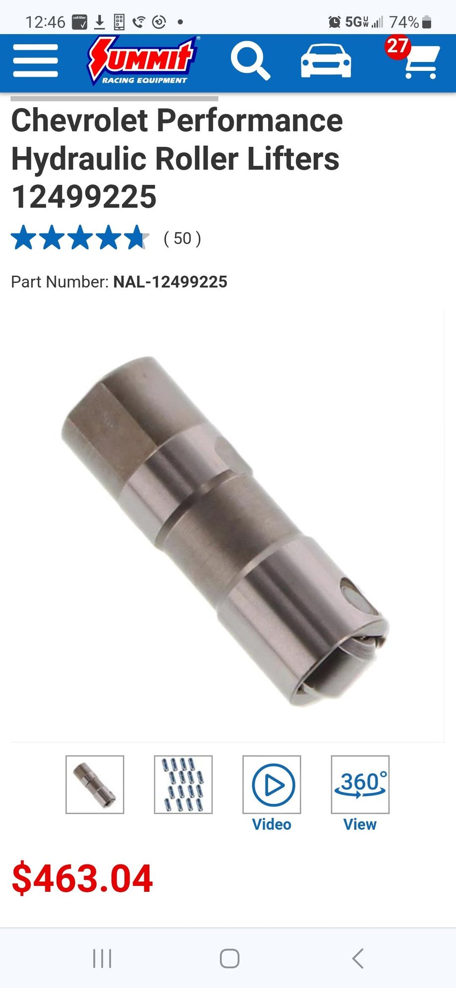

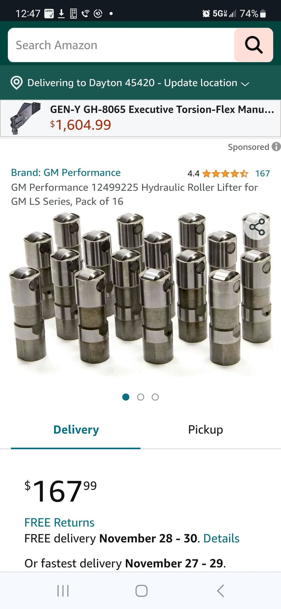

Is gm performance and chevrolet performance the same? Same part number but a huge price difference.

I wouldn't trust "GM" lifters off anything other than a true GM source. I'd get a set of LS7 lifters off pace, scoggin dickey, etc. My second choice would be the stock replacement Johnson lifters.
