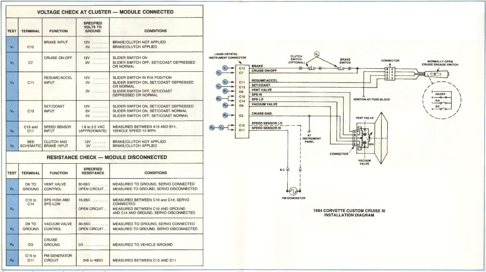

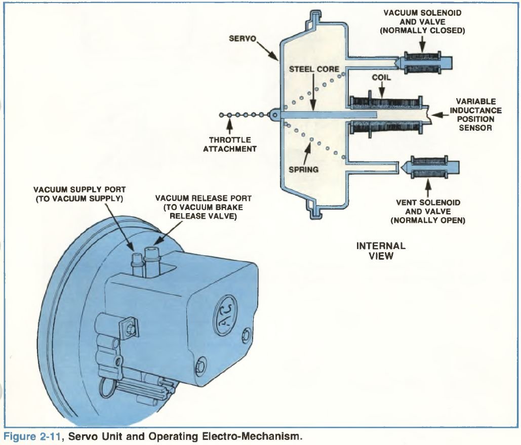

There are two solenoid valves used to modulate the vacuum applied to the cruise servo. If the vent valve is somehow obstructed, plugged, or inoperable, the result can be that the servo will just constantly pull the throttle cable.
The system diagram should be similar to the Y-Body scheme, shown below:

Updated: Got it fixed by replacing the cruise control computer, located behind the upper passenger-side trim panel (next to the ECU). The part I used is "25110868"
