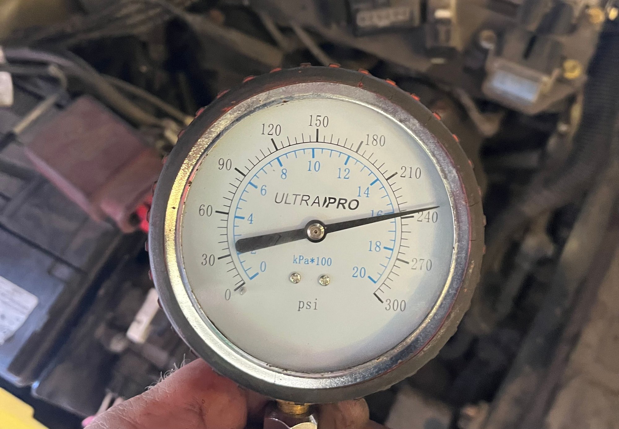

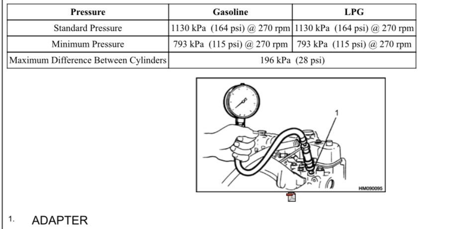

Compression test executed as per service manual, 220 - 240 PSI. Spec is 167 psi +\- 5.
60 to 70 psi above standard, confirmed on two different test kits.
I removed the 02 sensor in the manifold and repeated the compression test with the same results.

Is it at all plausible that the high compression from carbon build up would cause the engine to run this lean / hard start / stall during unloaded rev?
