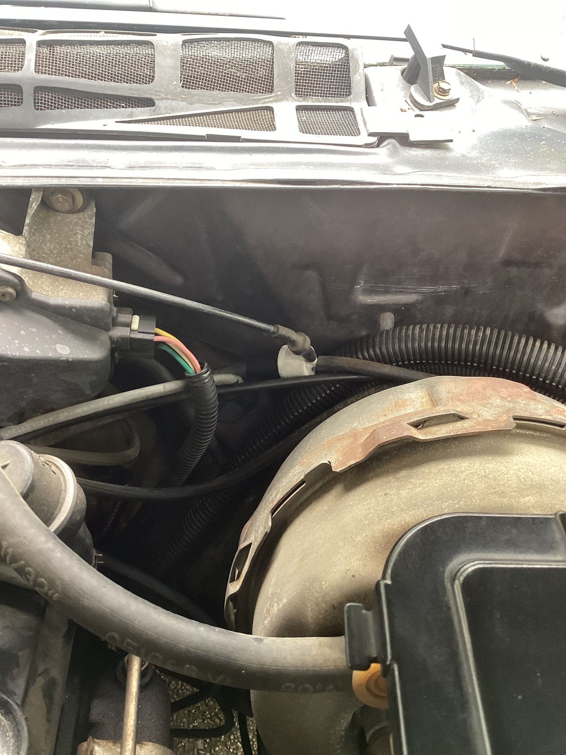

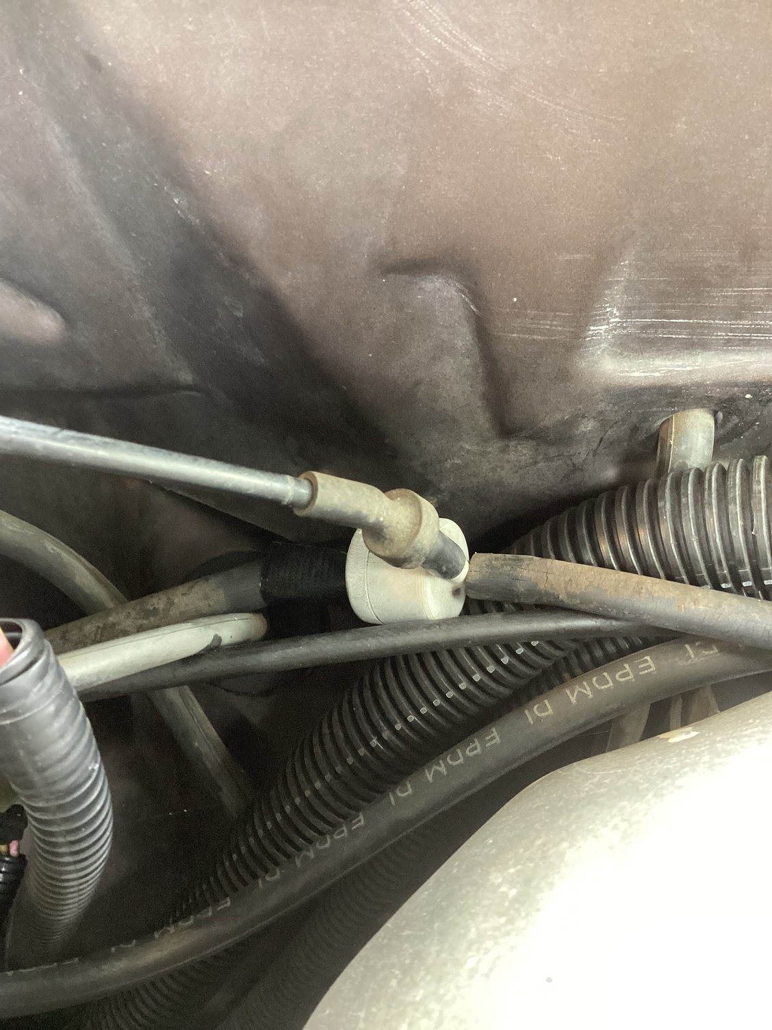

Small white plastic T gizmo?
Can anyone help me identify this and tell me what it does and where I can get a new one? Mine has crumbled which is why I had to put tape on it. Thanks!

That's a vacuum check valve for the HVAC system. For an makes universal ones in the "HELP" section

Dorman 47150

Looks like Amazon has the Dorman 47150 and "GM" 15-50568 I ordered on for my vacuum fitting assortment. Just to have.
