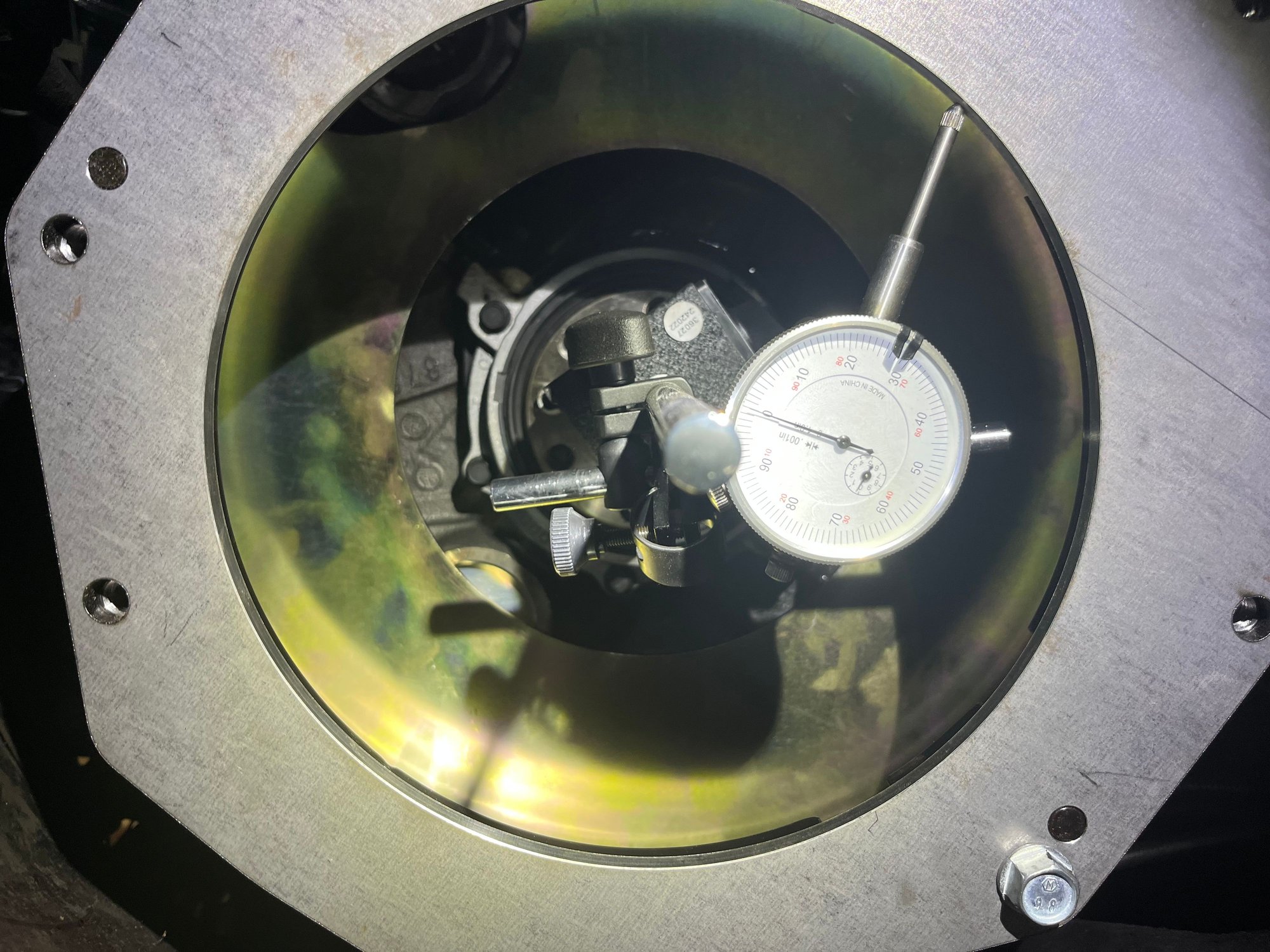

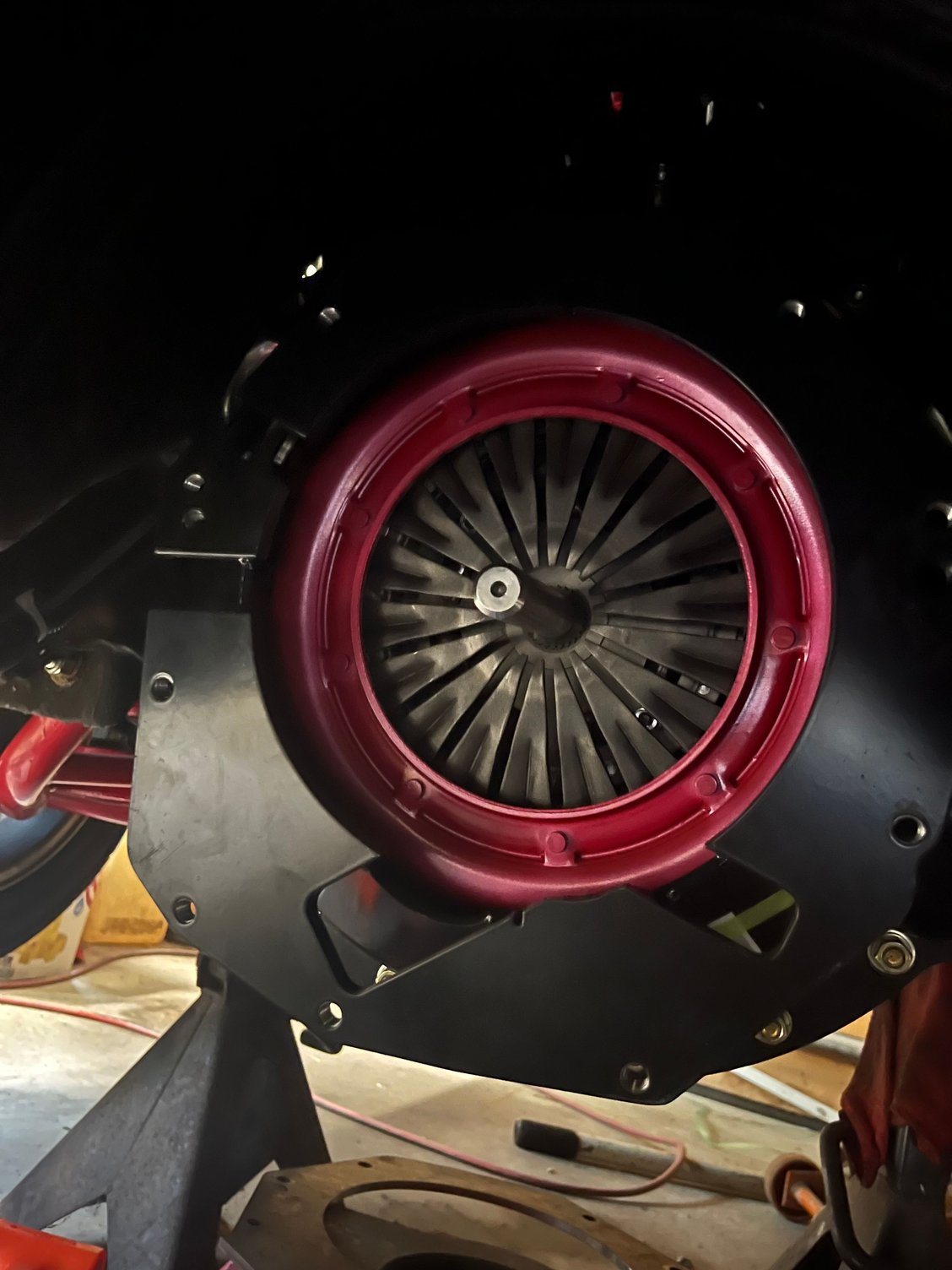

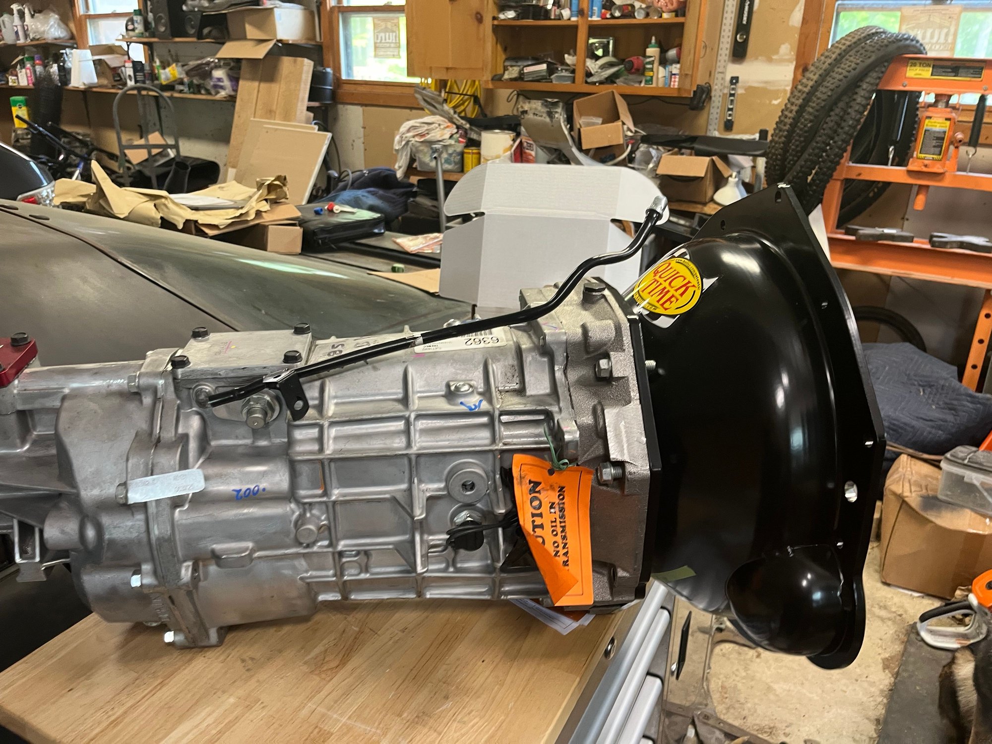

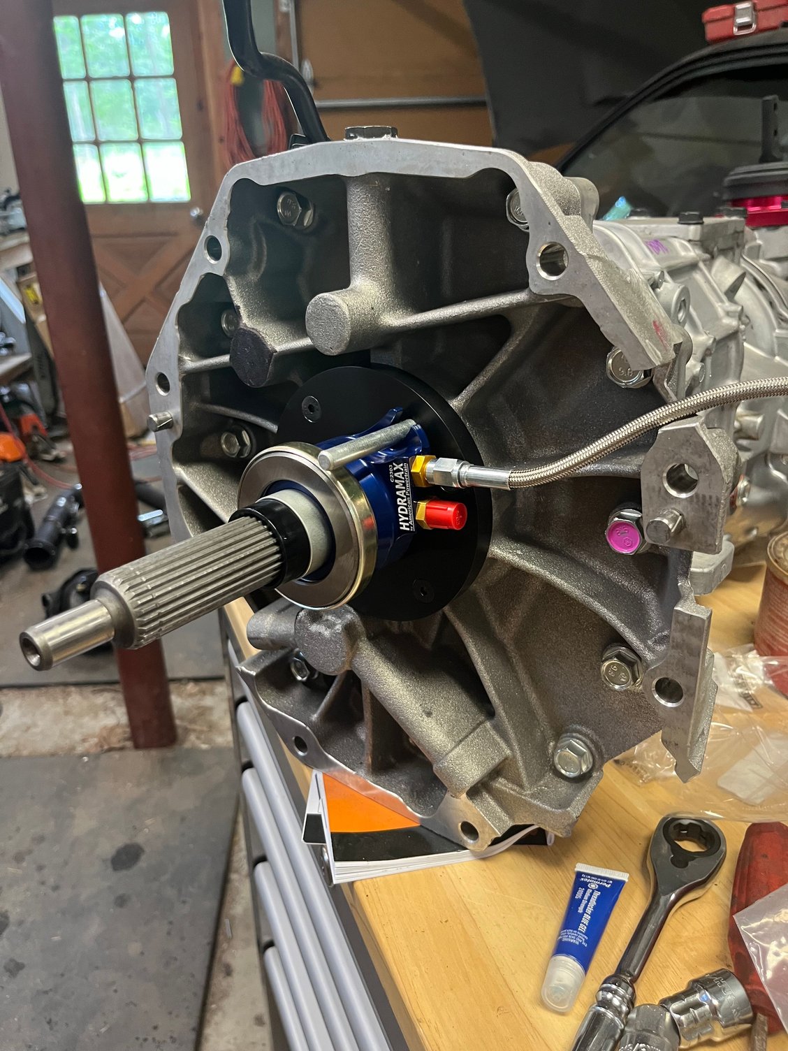

I used magnum f t56 close ratio and mated it to my sbc using a QuickTime bellhousing. I used a stock flywheel and a ram dual disk rated at 800hp and actuated it with an American powertrain t56 hydro setup for an 82-92 f body. The whole setup works awesome and was easy enough to put in. You do need to locate the bell but it's easy especially w the engine out. The hydros w the dual disk have a lighter pedal than the stock setup and shifts great. Putting the two in together is faster and easier.
Hydros w pedal height adjuster and speed bleeder
