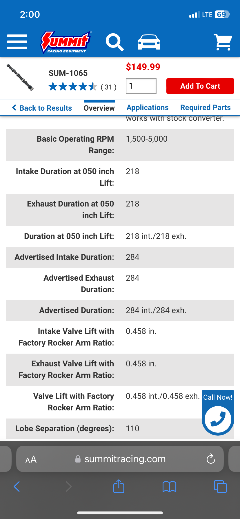

"New block" won't fix this. Sounds more like an inappropriate cam choice; specifically, too much. What cam did you put in it?

Thanks for the help sofa. Pretty sure I have a bolt there because I heard the horror stories from other members of the forum. The oil leaks from underneath the timing cover where the po messed up the rubber oil pan gasket. I’m gonna try a new thermostat like Tom recommended. Part of why I want to get the block out is because my oil pressure acts funny; when starting I sit around 35 ish but during driving it will progressively drop, and at some points has reached zero. Upon restarting it oil goes back up to 35. Oil level hasn’t dropped like I have a crack or missing plug anywhere. I’ve heard rumors the old nylon cam gears would break down and get sucked up by the pump, which already seemed a little tired when I was priming the lifters before first start. I currently have the summit 1065 flat tappet cam and lifter kit (see specs in pic below). As for temp, I was nervous that the bearings may be going because it’s such a high mileage engine and I have no idea what was done to it before me, I’m the 5th owner lol. Stock water pump, basic aftermarket fan (needs to be rewired per your recommendation in the other thread I posted, will probably get to that in December over break). As for the fuel pump, it’s the stock mechanical on the block that I cleaned out thoroughly before starting it. The one in the tank poses a problem because I don’t have access to any kind of lift to drop necessary stuff, and would have to do it in a small garage the old fashioned way on my back, or cut a whole in my trunk. No problem with that, but all of my experience comes from working on this car, some help from my old hs shop teacher and YouTube so I’m still really amateur. Id hate to start going at stuff without really knowing what I’m getting into 🤦‍♂️. The car has also sat inside and out for unknown periods of time, and I’ve heard that weather can compromise block integrity. I’ve also hear if it’s not compromised already then it’s not going to be. Thanks again for the response

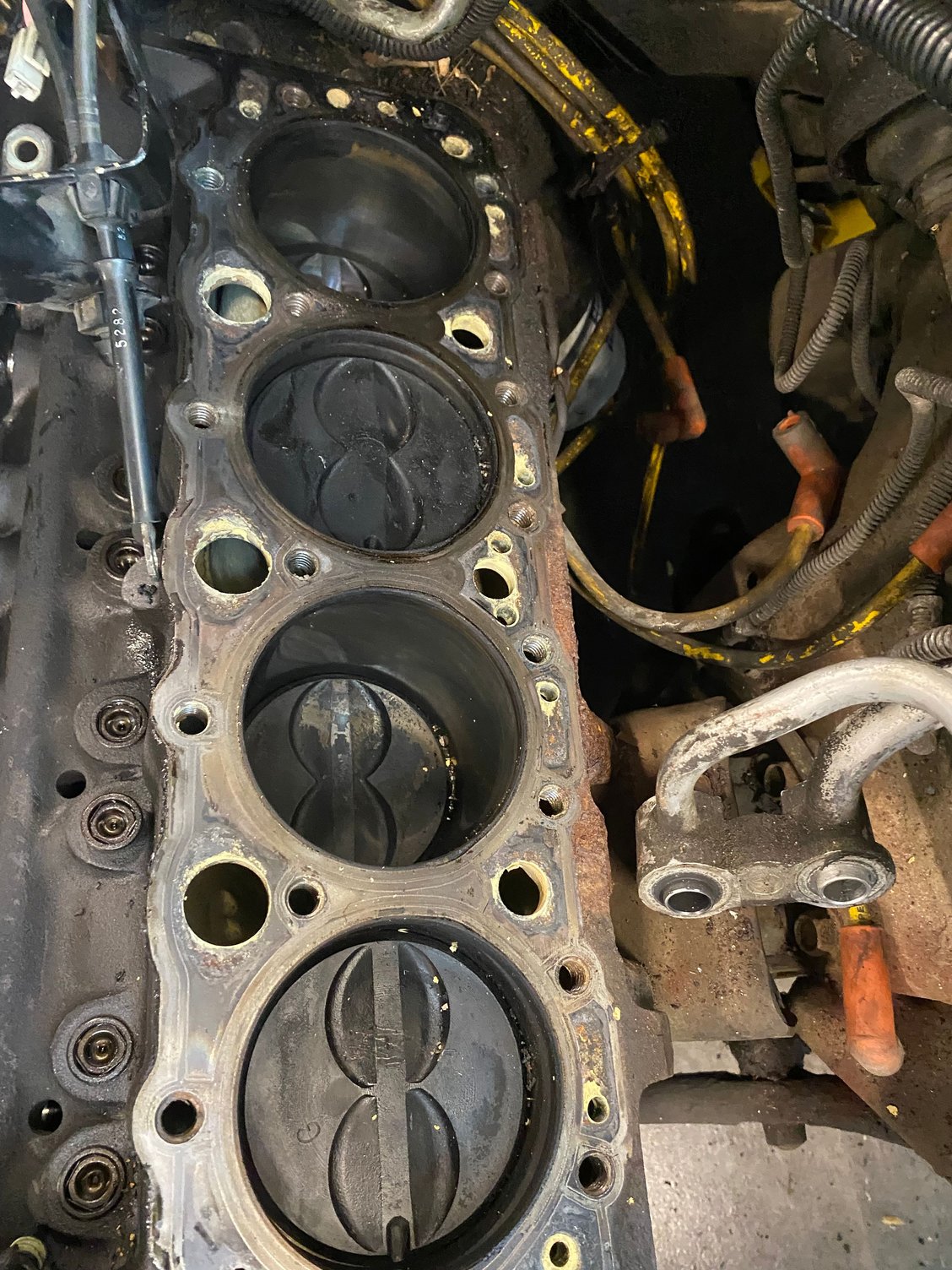

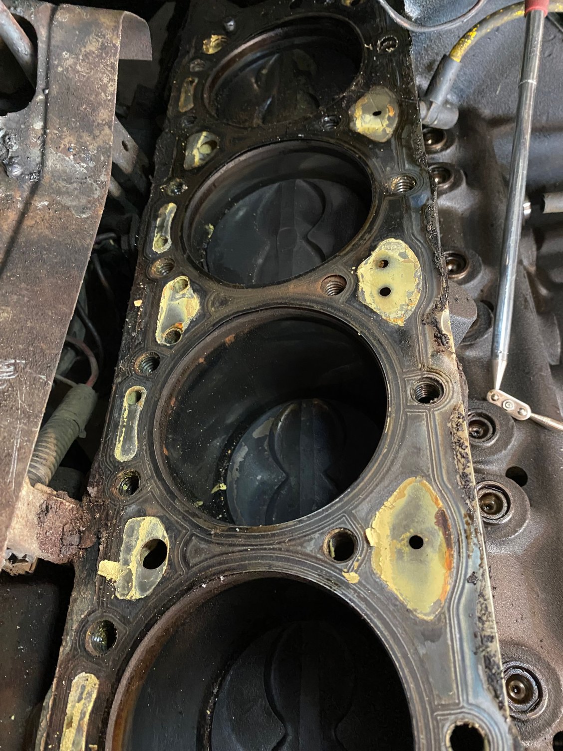

That’s great news. To get the oil pan low enough to clean it out I have to undo the motor mounts anyways, so I’ll probably pull the block and check the bearings and seal just for peace of mind. Probably a new oil pump as well. Maybe a little clean and paint? 😉. Pulling the parasitic fuel pump out of the tank, should I replace the pump or only keep the pickup? Probably Clean up the engine bay and redo the fan wiring. Below I attached a picture of the cylinders from when I rebuilt the upper end, should I run a drill hone through or let it fly 🪽? I’ve heard mixed opinions on those. Thanks again all for the help, I’m trying as much as possible to keep history screaming on the street.
