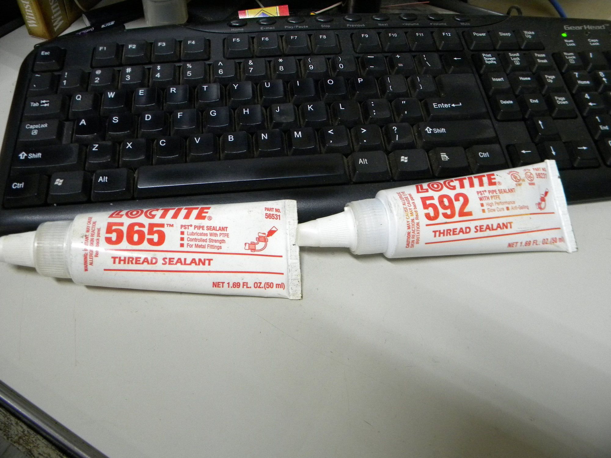

Vader's Avatar
Posts: 19,677
Likes: 314
Re: Sealing Head Bolts
Either of these will get you there:
